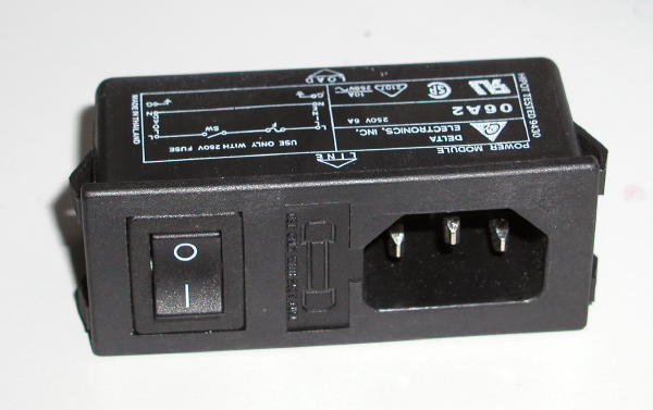

Peter, since you have increased the standoff length, can I assume there is space, for those that want to, to use a fused IEC connector as I previously mentioned? At least there are several options available then for each to implement as they see fit.
Here's another solution. Nobody says that place on my board, specified for AC connection has to be used. I made it there, as it works for me and offers compact, one piece assembly, without need for a chassis ar any wires.
But this Power Module, that I've been using on all my amps and PS, can be easily implemented with a DAC board, by simply connecting it with wires to transformer pins (on the bottom).
Vikash said:Peter, since you have increased the standoff length, can I assume there is space, for those that want to, to use a fused IEC connector as I previously mentioned? At least there are several options available then for each to implement as they see fit.
You see, the standoff length, or the material, was never specified here. One can use any suitable length, (as one can use non metal materials). This gives you freedom to arrange for any required clearance to comply with any local safety regulations.
I don't understand why it needed few pages of a thread to get it through. Obviously, some may have other agenda, than just the safety issues.
So in other words, the space for any fused IEC connector can be easily created. Some people assume that PC board can only be populated with parts in top layer, but to me, it was always obvious that both layers can be used with good effect, the only requirement is the space.
Yes, there are countless options, and one can do whatever he feels is optimal.
I agree. There's nothing to stop someone from putting in a Fused IEC connector or any number of other arrangements ( a fuse inline on the cable going to the board). I would most definitely do it that way, anyhow, since I like my fuses closest to the point of power entry as I can get them.

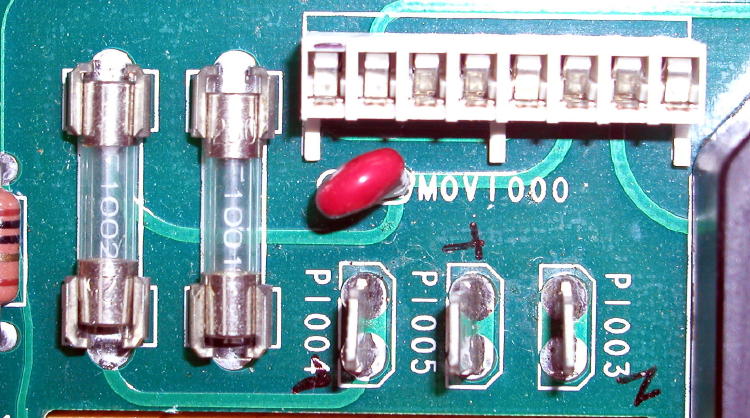

To put end to the crippage discussion, here's a picture of AC section of a Madrigal preamp. As you can clearly see, the distance between hot an neutral connection (on the board) is less than 2mm. This preamp is approved to work with 230V.
My board is much better in that regard, and I will not accept any further comments, in this thread, with regards to crippage conditions; you either know what you are talking about, or not talk at all.
Few more comments after examining ML board. The "Live" terminal is only 1.3mm away from a trace coming from Earth ground terminal. This terminal is further connected to the chassis, and by 10 ohm resistor to the ground plane.
We are talking about 230V connected trminal, being separated by 1.3 mm distance from a trace leading to a ciruit's ground plane, all this before the fuse.
If there were any doubts, I am beginning to believe that I am much better manufacturer than Madrigal.😉

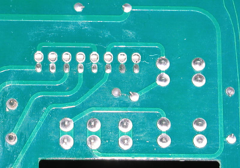

Here's the pic of bottom layer fm ML380 preamp.

It is 1.3mm distance between 230V terminal (direct connection from AC receptacle) and the trace connected to the circuit's ground plane. The ground plane covers most of the board's area and the fill has 15 mil spacing from the components pads.
In the light of previous creepage discussion, and concerns mentioned by Peranders (and some others supporting him), I can't uderstand how this (Madrigal) design could see the daylight.

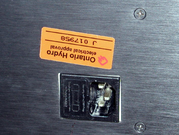

Ontario Hydro, some kind of recognized testing institute?

Ontario Hydro is the Provincial Electric Power Utility. At the time that that preamp was manufactured, Ontario Hydro's R&D laboratory and testing facility was a widely certified approval test agency, authorized to perform certifications for CSA, UL, CE, TuV, JIS, MIL-SPEC, and many many others. Unfortunately, that section was privatized a few years ago and I don't believe they are still providing the same certification services.

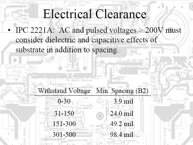

http://power.ece.uiuc.edu/Balog/images/PCB Basics.pdf
page 42
(P.S. Does ML380 have three fuses in the transformer primary????)
