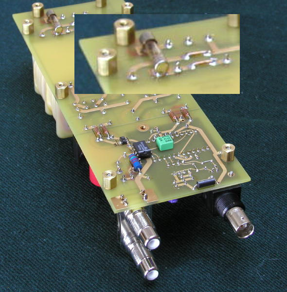

There are few reasons I opted for soldered fuse:
While using 3 x 2 tubing, there is not enough space for fuse socket underneath.
From the standpoint of reliability, soldered connection is always better than tiny clamps of a fuse holder.
While the fuse I'm using in a picture, is not particularly suited for direct soldering, it still worked well for the last year I've been using it like that in another circuit. Digi Key has few pages of fuses that are made specificaly for direct soldering to the board.
And lastly, a properly designed device, shouldn't require fuse change in its lifetime, so why would you need a socket for?

Ok, I found the fuse but isn't many fuses soldered inside? Do the manage soldering without any problems?
I see also (correct me if I'm wrong) that your creepage distances are way too narrow, at least for 230 volt countries.
You must have 8 mm between any mains parts to any touchable metal part and in your case it will be your whole stereo.

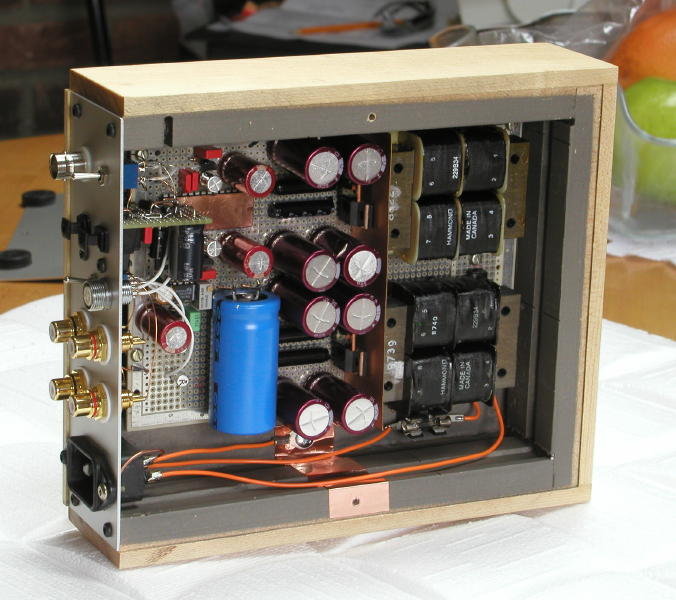

If you look at the PCB's and the case it looks like there is space to fit a taller, fused IEC conenctor. This will satisfy the safety/creepage issue - why all the fuss.
ooops. I see why the fused IEC isn't an obvious option now. I saw the connectors were exiting at around mid height of the case, so there appeared to be some space available to fit a taller IEC socket. But now I've noticed that it isnt the same PCB in the case. 🙄
Had a look on Farnell; fused pcb iec sockets are about 8mm taller compared to their non-fused counterparts.
When I buy one of these kits, I am going to just make the enclosure slightly longer, and mount a fused IEC, or IEC and separate fusefolder off the pcb.

There may not be many fuses soldered inside, but this one is. This was an intentional choice. There is a lot of talk about mains connection quality, higher grade receptacles and all those "special" power cords. I simply didn't want to compromize the AC interface by choosing "convenience" over quality. The fuse attachment pads are oversized, so basically any type of fuse can be used here and I still have to experiment what works best. I'm also of opinion that the type of fuse will affect the sound, so the choice is not merely picking sub-mimiature type from D-K catalog. The practicality was never the intention of this product, the best example is the way some caps are mounted.

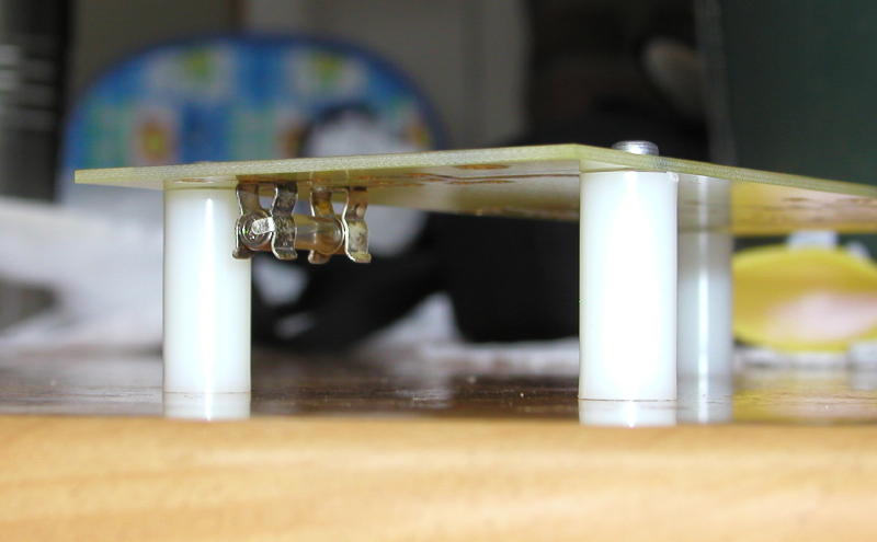

As to the creepage distance, it is only dictated by the standoffs height. In case of .25" it's about 6mm and with .375 we are well over 8mm. Additionally, the enclosure surface directly under the AC traces and the fuse, can be insulated with special plates.

When I see the solderside of the pcb at the mains side I think it's too tight between the distance screws and one of the connections of the transformer. If you have a metal case _and_ not the protected earth connected which you have to have some countries in Europe, the distance seems to be less than 8 mm, 0.315".
If you always can garantee that the case is grounded it's OK but I think this is a bit unnecessary so if you ever release this board I think you should make the mains side fully professional, as much as you can. If noone can complain not even a testing institute you have really succeeded.

With regards to your first paragraph, the hole distance is exactly 6mm from transformer pin. But why not use non metal screw (and standoof) in this particular spot?

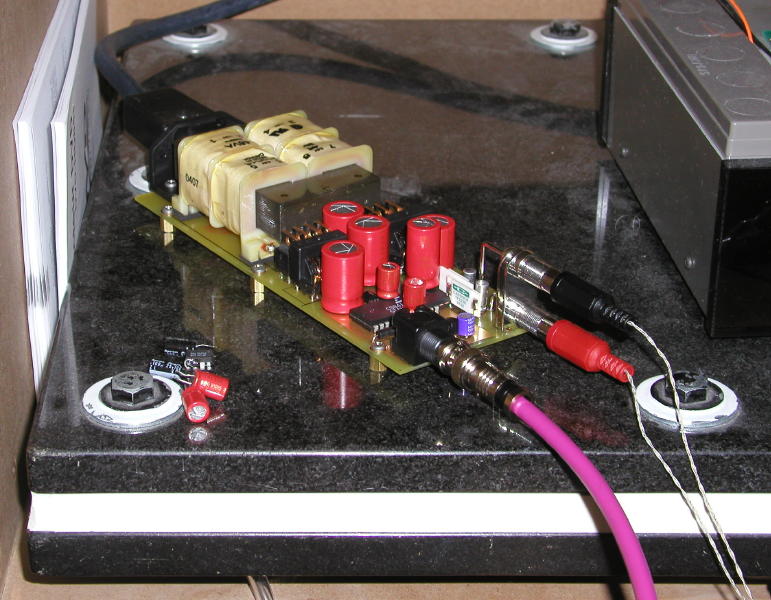

Here's the way the DAC assembly from post 125 has been used.

For a sake of clarity, and better understnding of my choices and options I created here, none of the both holes close to transformer primary have to be used for mounting (when aluminum tubing is used). As you can see, an AC receptacle is mounted directly to the board. This receptacle, attached to the back plate of metal enclosure is enough to support rear end of the board, with no need of using standoofs close to transformer. This again, complies with 8mm creepage distance.

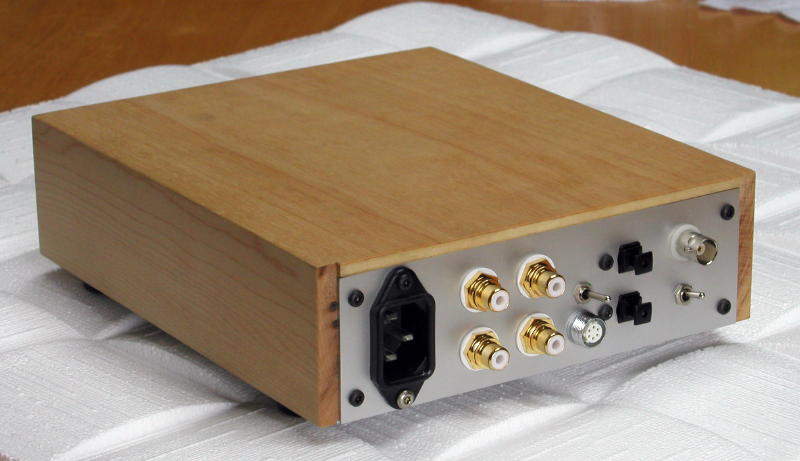

Again, I really recommend wooden enclosure, with maybe only metal plate on top, which can effectively become a bottom. I did some testing before and that type of enclosure sounded the best.

I made it 10mm (directly on board), just in case the regulations might change in a future. The rest of the clearance depends only on mounting options.
