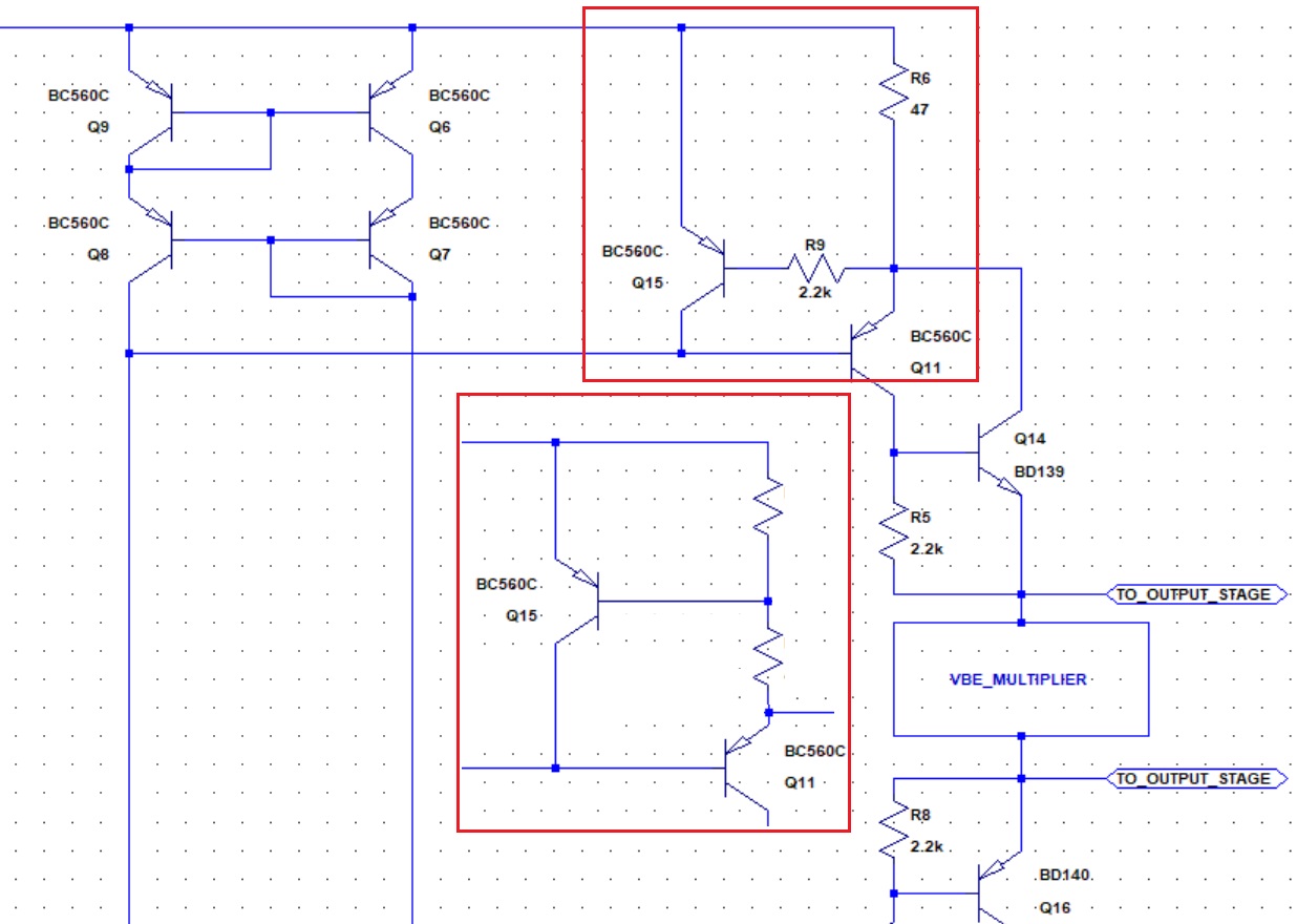

Problems with VAS current limiting

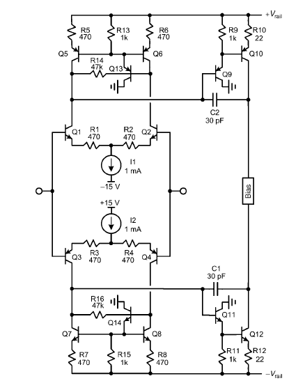

Hi Northumber, I am going to ask you a step back question.
- Is there a particular reason you want to go with this complementary topology?
They are substantially harder to bias up than the non-complementary version, specially when loading the diff pairs with current mirrors.
If you still want to attempt the topology, the attached picture shows the simplest way to bias up the VAS current. Bias is via R14 and R16. Actually Kokoriantz already suggested to do this in post #10.
Other techniques are substantially more complicated.
Good luck!
