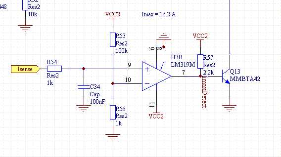

I'm having problems in getting one half of a LM319 to work correctly for a over curent detector.
The current sensing resistor consists of 3 x 0.022 Ohm resistors, which should trigger the circuit at a bit more than 16 A. The + input of the Comperator, is connected to a voltage divider 100k/1k to give a 120 mV voltage.
Vcc2 is 12V.
Problem is - input is 0V and + is 120 mV but the output is 10,4 V!!
Doesn't the LM319 work as a window detector this close to ground?
Is it because the differential voltage is two low??
Whe removing R56 the output goes low (makes the diferential voltage 12V).
The Class-d output has not been mounted yet, so this is not the cuase of the problems.
After some experiments I don't find the LM319 too easy to work with 🙁
Anyone familiar with this comparator, that could help??

Yes, like what he said. The LM319 input common mode range does not include ground.
If you look at the data sheet, I haven't found a 'good' one yet, you need something like 1-2V. The internal schematic shows an NPN differential pair with an NPN current mirror driving it's bottom.
That adds up to at least 2 VBE drops or 1.2V if it is going to work.

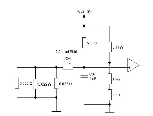

You might try two resistive dividers from your 12V rail to the inputs to pre-bias them up to 2V. Tie one to ground and the other to your sense resistors.
You'll have to do some sums to set up the proper trip level.
Otherwise there are more modern comparators, as fast or faster, whose input common mode range includes ground.

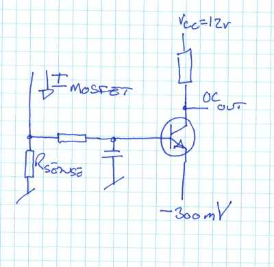

Not sure I get your proposal right ..... by pre-bias, do you mean to tie emitter to -300mV?
If Rsense = 0,015 Ohm then a current of say 20 A would give a 293 mV and together with the 30mV would be just enough to trip the output (probably a little higher current would be needed)!
Se picture. That's what you meant?
But then I have to get the -300mV first, and as it's a full bridge I did not intend to use any negative PSU! 🙁

Baldin,
try to do a level shift.
Heinz!
powerbecker:
Thanks .... that cleared it up 🙂
Think I'll try that first, as it will be easiest to implemtent on the current PCB 😉

The circuit is "right" ... the divider is conected to - and not + as I wrote!
Yes the output is high = 10,4V on pin 7 which is connected to the base of the following Q13.
Otherwise like your approach .... will try that on the next D thing .... didn't think of the pre-bias, and thought I couldn't trip a BJT directly from the current sensing resistor.😉
The 10,4V is measured with Q13 dismounted.
Don't know where the basis resistor for Q13 went! (as the LM319 is an open collector output, Q13 will be biased through R57 (2k2) and will still work, though it was not intended to be designed this way..... think I will increase R57 to 10k to lower the basis current in Q13!!
Problem is that when plus is tied to ground (or no current is running in the sense resistor), then minus is higher (set by the divider), but the output is high (10,4 V)
Now that I'm digging a bit, I have found the simulations .... and find that these are using a TL072 as comparator .... and that it includes a bias resistor for Q13 :xeye: ...... think I have been a little to fast here:cannotbe:
