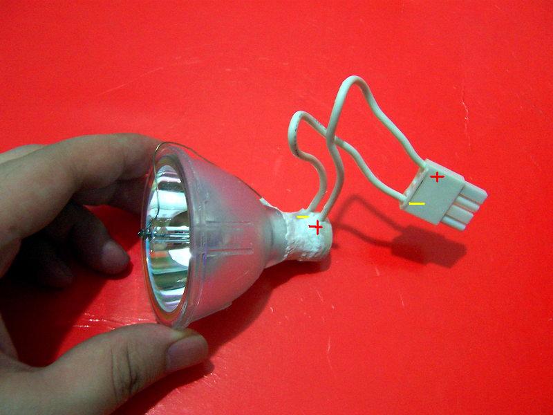

i have some problems with the bulb (look at the pictures)
My projector is InFocus X1, original lamp is a SHP 150W!
I have ordered a new lamp through the seller of the projector!
He did not want to give me the adress, but I guess he ordered the bulb from 18wheeler.
But now I am not sure anymore, that this bulb is the right one!
When the projector tries to ignite the bulb, one can see only a small blue light at the negative connected electrode!
Is this bulb for D.C. use at all?

@ ywh: Thank you for your answers!
unfortunately, I did not succeed in starting the lamp!
I followed your instructions, laid the - wire outside the reflector, but again there was only a small blue shining light at the - electrode visible!
By the way. For what is the second thin cable, which is also connected to the - wire and is closed in a loop behind the glas ball (look at the first picture )?
