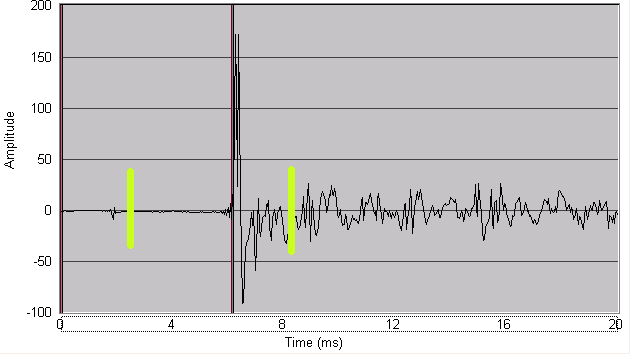

I am still trying to get my acoustic measurements to work.
When I try pulse measurements, for some reason, I'm getting only static at sampling rates of 44.1K or 48K. If I select 24K, I'm getting a clean pulse. I can change sample size to 64K, 128K, or 256K, and I get a clean spike. But if I increase the rate above 24K, I'm getting no pulse. If I switch on auto-minimax for the amplitude, I can see it ranging between -6 and +6, which is practically just static. When I get a clean spike, on the other hand, the amplitude is 100+.
Why am I not getting any spike at higher sampling rates? (My card doesn't go beyond 48K sampling rate.)
And when I do get a clean pulse, this is what it looks like:
(I should have removed the marker to make the graph more easy to study, I know. Sorry.)
According to the Unofficial Manual, I should see two spikes, one which is the direct signal, and the other which is the first bounce. I'm not seeing any first bounce. Is this because I'm doing these experiments using a finished speaker which has three drivers all firing simultaneously? Do you think I'll get a clean second pulse if I use just one driver? I somehow doubt it, because if the multi-driver situation is muddying up the pulse, it would muddy up the direct pulse too. Or wouldn't it? :confused:
And when I do a gated response (again of this finished commercial speaker), I get the following graph:
Is this usable for anything at all? Why am I getting such an ugly graph?

Hi TCP/IP,
couple of things... 1st have you got the mic back at about 2M?? if so it is too far, try reducing to somewhere between 80CM and 1M.
second, are you playing this real loud, in order to get the mic levels high enough?? or are you possibly bumping up the gain in the mixer for the mic?? either of these could cause undesirable results. for farfield measurements I usually end up accepting that I'm going to have to live with max 5K on the VU meters, as even with the high gain setting on my wallin preamp, to get levels higher than that requires extremely loud SPL's.
I've attached a copy of your pic with where I think you should start playing with the gate times. this may give you a more normal looking result.
Even with all drivers playing you shouldn't be getting results like you are (I don't beleive) I think you are seeing room effects because you have your upper gate time too high.
Tony.

tcpip,
are you using a power amplifier to drive the speakers? Or are they just driven by the sound card? You need am amplifier to do this kind of testing, and the setup needs to be calibrated with the amplifier in the loop. If you don't have the amp, be careful and calculate the amp gains to make sure they don't exceed what your sound card can take, otherwise you will damage the sound card.

Thanks for the prompt and patient answers, soongsc and wintermute. I am completely stuck till I lick these problems, and I need all the help I can get.
Yes, I was about five feet or so away. Will take more readings closer this time.
second, are you playing this real loud, in order to get the mic levels high enough?? or are you possibly bumping up the gain in the mixer for the mic?? either of these could cause undesirable results. for farfield measurements I usually end up accepting that I'm going to have to live with max 5K on the VU meters...
I too am getting those levels. I'm getting levels between 3K and about 8K on my SW VU meters. After soongsc and you told me to keep the levels down, I've been doing that.
As I said, our posts crossed, and I've now posted some readings with a longish gate duration (12ms). I'll try cutting the gate to something shorter (less than 11.96msec), and see. Do you feel I should move the starting marker forward too? It's currently at zero. Your suggested markers show the first marker at about 2.5msec. What does one gain by doing this? (Just curious...)
Even with all drivers playing you shouldn't be getting results like you are....
My conclusion too, considering that people do take SPL measurements of a finished multi-way speaker to see the aggregate response. So I don't think that the multi-driver thing is really an issue.

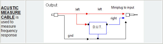

Is the attached cable diagram the one you are using? What is connected to the DUT?

Actually, I've tried checking a sine wave after a loop record, and the waveform seems to be quite clean. It's nowhere near clipping.
No, I'm not using any jig at all. In my case, there's one RCA interconnect going out of my sound card into the line-input of my amp. There is one pair of speaker cables going from the amp's output to the speaker being tested. And there's a Panasonic mic whose cable is attached to the mic input of my sound card. There's no loopback, no reference input, and no DUT as black box in the sense in which Claudio's jig diagram says.
I have a suspicion that there is no basic problem at the level of wiring diagram in my case. If I had problems at that level, I wouldn't have been able to get some approximate SPL graphs of the kind I'm getting.

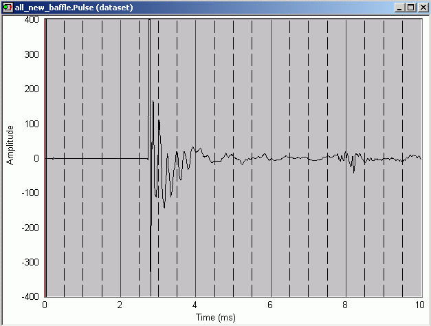

Did some more trials, with the following changes:
  • Moved speaker to centre of room
  • moved furniture to edges of room
  • adjusted level so that mic signal in VU meter is about 3-4k
  • kept mic about 1m in front of tweeter
And then I did a pulse measurement, at 24kHz sampling rate:
The portion after the first spike is cleaner now than I've ever seen in my trials in the past. I guess clearing up the space around the speaker basically removed all the sources of early reflections. So far, so good. I then set the second marker to 6.2msec.
Then I did a gated SPL reading, 24kHz, 256ksamples:
This is the cleanest SPL measurement I've seen from my setup till date. Why does the high end roll off this way? Does this mean my speaker is actually dramatically rolled off in its top end? Quite unbelievable.
Then I did two readings at 48ksamples/sec. Remember that I never get to see any spike when I do pulse measurements at this sampling rate. Here is what I got:
The system is clearly able to take some sort of readings at this sampling rate, but the data is much more uneven than at 24ksamples/sec.
What should I try now? Needless to say, I can't continue to use 24ksamples/sec if I want to measure till 20KHz.

I could have been wrong on that, I read somewhere (either here or in some SW doco somewhere that you need the ref channel, to get correct phase data.
The SW online help says that a ref input improves accuracy of phase readings. Understandable.

Yes, my Creative Digital Music USB supplies phantom power on the mic input. See the pulse reading I've just posted: you'll see levels approaching 500. It appears to be just a function of amp volume setting and distance of mic from driver.
I can't recall whether your data are for tweeters or for the full speaker systems or just the woofer.
It's for a full 2.5-way speaker.
But the data looks quite funny. The mic input of many sound cards don't have the appropriate bandwidth for measurement, and there normally aren't any specs for that input either. So I would still question the setup.
Yes, after the last set of readings, I can see a droop at the upper end which is so clear, repeatable and pronounced that I can guarantee that my system does not sound this way when I listen to it. This probably leaves me no choice but to fashion a mic preamp (complete with phantom power supply) immediately to continue to do my measurements.
If you can get everything about 6 feet away, especially in the front half space of the speakers, from the mic and the speakers, you would be in good condition. Anything closer, absorbing material would help.
I'll try this once I lick the current set of problems. Am I doomed to use just the 24ksamples/sec sampling rate? If yes, I have pretty serious problems. (Or else I live with the limit that I'll never get to measure till 20KHz.)
About the mic and speaker line not being parallel to any wall or surface, it really needs to be such an angle that the first reflection does not reach the mic.
Got it. This will be an interesting thing to try out. Of course, the ceiling and floor will continue to pump reflections to the mic.
Thanks for your inputs. I'm feeling pretty depressed at the thought that I may have to actually fabricate a good simple mic preamp now without delay. Do you have any pointers to any NE5532-based circuits which also supply phantom power?

Thats looking heaps better :)... with regards to your 2nd graph there, it looks to me like your tweeter isn't working!!! are you sure it is?? It looks like you are getting a 6db/Octave roll off from around 3.5K...... Have you run rmaa on your sound card?? might be worth a look, maybe your sound card is rolling off badly at high frequencies, (this is where a callibration can help!)
If you can get a cheap SPL meter, why not try playing a sine wave at say 2Khz 4Khz 8Khz 10Khz record each reading and then compare to your graph.... if it is reasonably flat then you have a problem with your measurements, if it follows the graph, then that's the way your speaker is!!
If you know anyone with a nokia 5140 it has a rudimentary SPL meter built in :)
You probably need to do some debugging of the 48Khz!!! check and see if there are any updated drivers for your card, could make a big difference :)
Tony.
