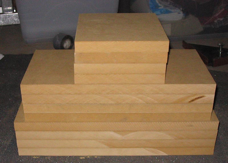

Well I still haven't done the mods to the mic, I decided it was time to stop testing my prototype and just get on and design the final cabinets, and make them 😉
I cut (with the help of my Father and his triton workbench) most of my MDF today 🙂
Only one slight oversight, I forgot to check the MDF was really 25mm..... it was 25.5mm...... luckily because of the construction method I have chosen this means that the only panels that are out are the front and rear baffles which are 1mm too short overall 🙂 I'll just put that at the bottom and it won't be noticable. my internal width will probably be about 1mm less than it should be too, but no big loss.
Cutting acuracy was very good (IMO) at about 1/4 mm maximum variation.
pic of pile of mdf attached 😉
Tony.
