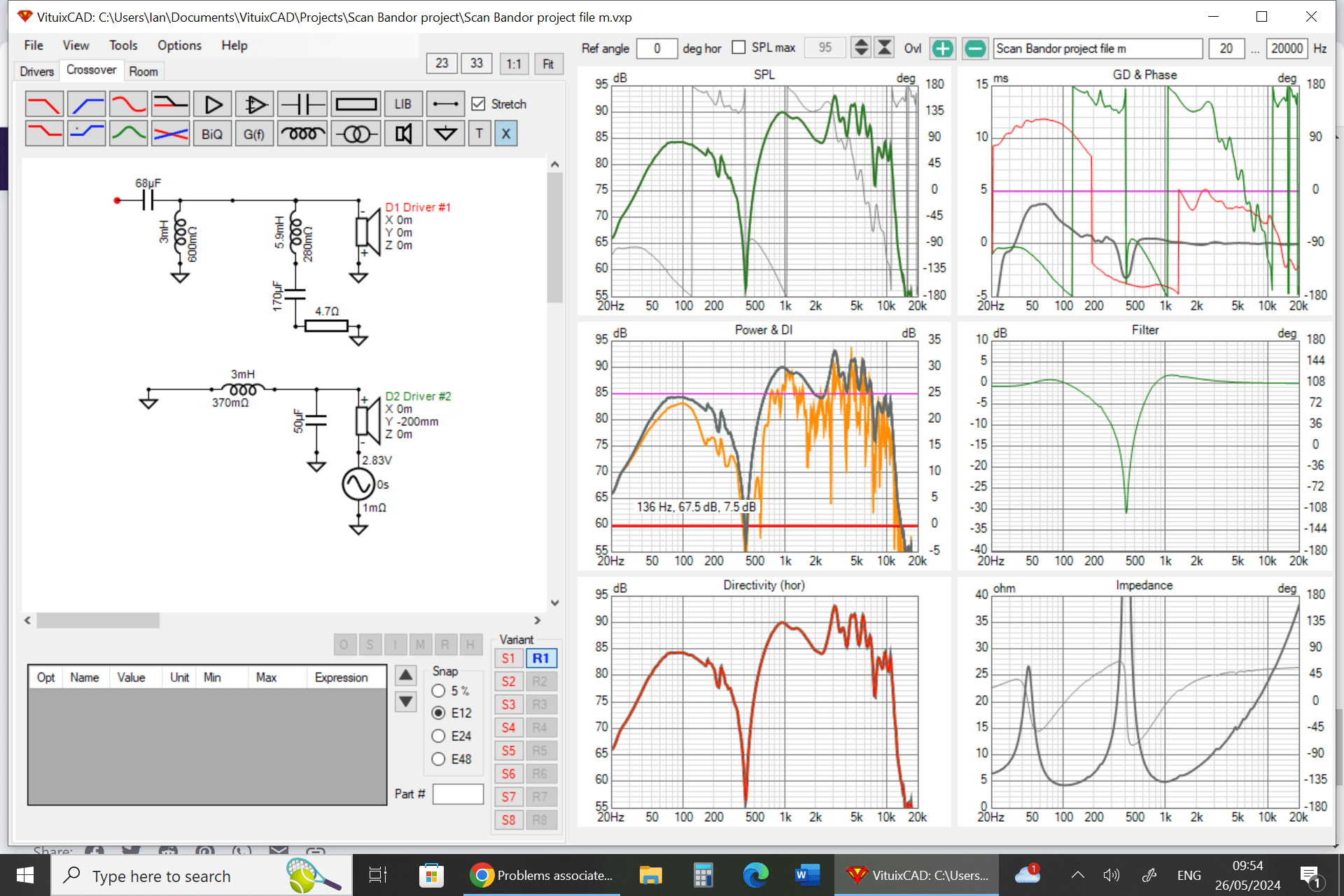

AllenB has suggested using a higher order crossover instead, but if you really want to notch out a single frequency, that seems to me like a rather blunt instrument.
I have been working on this crossover for nearly two weeks now, and I believe I have tried most of the configurations. I am using the tweeter in a waveguide which creates a huge bump around 2-8k (as you can imagine) that I have to deal with. Add to that the baffle step loss and the break up, you can see why I don't have that many options.
The other alternative, surely, is an LRC trap, either series or parallel. (And that would also use a resistor.)
That's actually what I have done originally, but when I found out people are using a parallel cap instead, I jumped on it because I already have a notch filter for the baffle loss and adding another LCR network sounds a bit too much in my humble opinion.

I have been trying to get a satisfying result with a 3rd order filter in my design. When I get good response, the phase is off. When I nail the phase, FR is bad. I feel like I'm chasing my own tail.

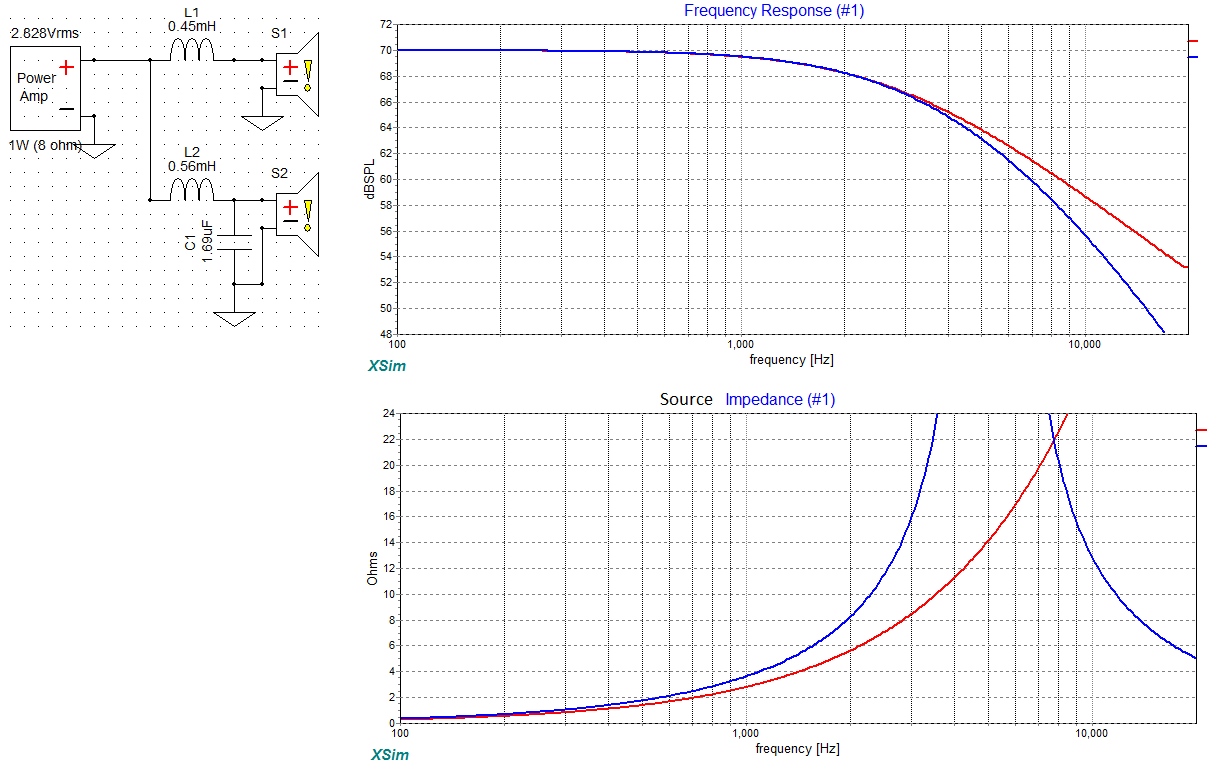

It's going to be different from creating a pseudo rolloff using a bandstop filter, however I would also check your measurements. Sometimes an incorrect measurement presents difficulties in 'fixing' the response.When I get good response, the phase is off.
If the woofer is excited at breakup by a lower frequency input that creates a harmonic, a low impedance can help that develop to give the appearance of increased distortion over what would be if the response was flat around breakup, despite your crossover filter since this is coming from the other direction.Anywhere I can read more on this?
However it's not normally something to worry about, for a few reasons.
1. The peak is usually only on axis, but that's not representative of the overall response. Don't rely on an on axis measurement to tell you the story, and don't listen on axis...
2. Speaker distortion is low order and has to be audible before it's a problem.
3. Source impedance for a second order filter looking back from the driver can be higher than first order through breakup.
![bj.png bj.png](https://www.diyaudio.com/community/data/attachments/1221/1221954-b0b64da4c6bd3fdf44b28119706407d1.jpg)
Thanks AllenB. That makes sense, and the graphic shows the fall in source impedance at hf nicely for the second order filter. Two questions, though.
First, how does this reduced impedance at hf lead to increased output at hf? (After all, the frequency response graphic shows, as you'd expect, that the second order filter attenuates hf more than the first order filter, despite the lower source impedance.)
Second, if you tailor the 2nd order filter by putting a resistor in series with the cap (a very common strategy), does this help?

Sorry for the late reply.
This really doesn't have anything to do with breakup, harmonics happen across the spectrum and the cone responds as a source. Some people have gone as far as to use a current source to drive a speaker. The reason breakup gets singled out could be because of the general expectation that those frequencies have already been filtered and shouldn't be produced.
On top of this a breakup peak has additional gain for the harmonic in the direction of the peak, in the amount of the difference in response of the driver at the two frequencies, and this looks untidy on a plot.
