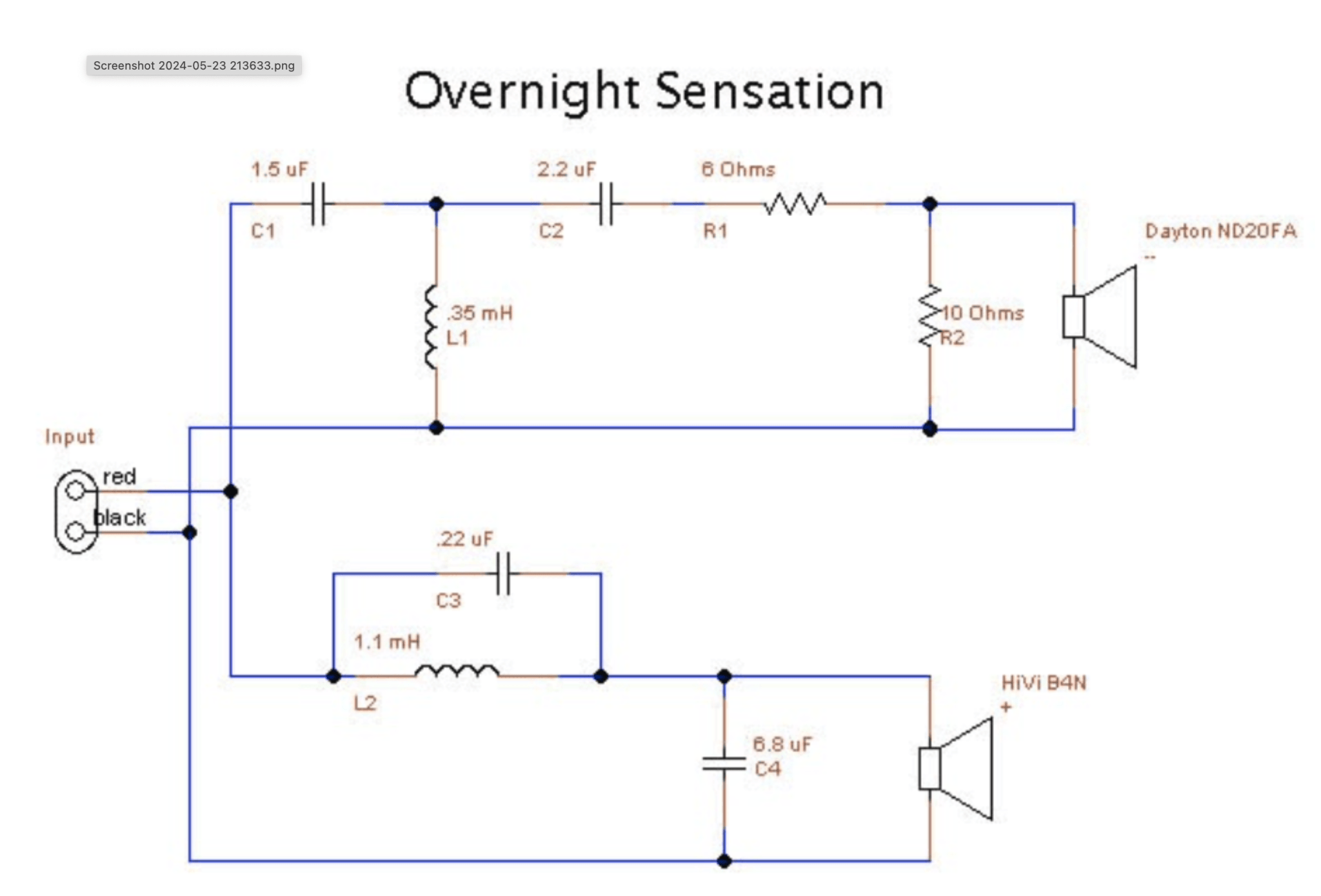

The issue is easy to explain: in an amplifier with NFB, as the frequency increases, the open loop gain decreases. Thus the closed loop internal resistance looking back from the load, increases. Just as an inductor does. Ergo, with a range of certain capacitive loads; the amp may turn into an oscillator. If the output stage can't support the power at the frequency of oscillation, simply it explodes.
An electromagnetic speaker's voice coil has enough DC resistance to avoid problems. The designer needs to avoid introducing a low-impedance path in the crossover (the 330nF capacitor in post #1).

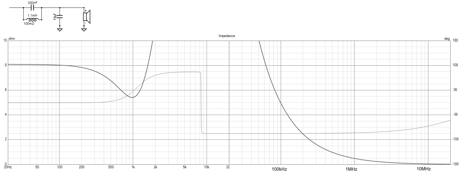

Perhaps @hautparlurker was suggesting putting a resistor in series with the 330nF capacitor? That's not a problem surely?NO.
Just use the proper parallel R-L network inline with the load. One does not need the extra 4 ohms at lower frequency, just up high.

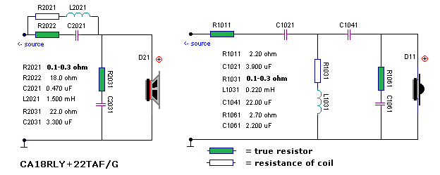

Shunting the series inductor with a small cap is usually done in order to trap a breakup peak, and if you use a resistor to control the depth of the notch, you'd get a side benefit of avoiding the supersonic capacitive load. No? Here's an example from Troels. (Although the resistor isn't actually necessary from the point of view of the load, in this example, as the only shunt capacitor is in the compensation network, so there's a resistor in series with it already).
Adding R to the notch cap will widen the frequency band over which it notches, and reduces the depth of the notch. Which may or may not be what you want to flatten the woofer.

The resistors in post #9 are large enough to avoid creating a low-impedance path at high frequencies.

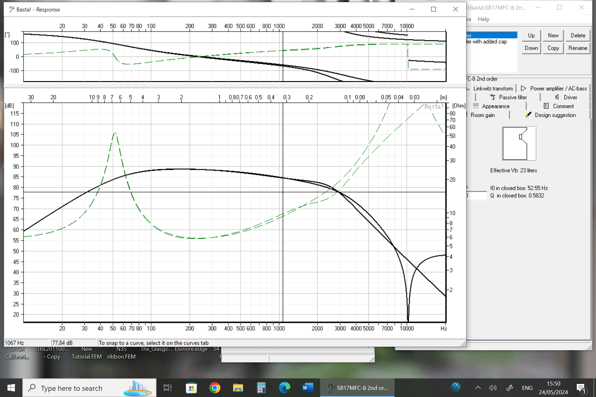

These two give the same response to -24dB.
Couldn't really achieve the response I was after, it created a knee. I'll try different designs with using a 3rd order filter.
The resistor will preclude low impedance, but there are better ways to design the crossover.hautparlurker said:So, if I throw a resistor large enough, it should be alright then?

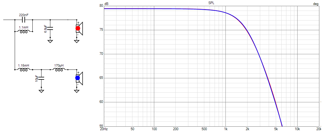

That might be the inductor resistances I used (0.5 for the large and almost nothing for the small). The point is the same.. there are different ways to get the same response even when it gives a different impedance.When I model them I get similar responses, but not identical:
For a speaker builder who doesn't understand the electrical implications for the amp (i.e., who would have though that the filter in post #1 was perfectly fine)...what do you mean by "proper R-L"Using the proper R-L at the amp’s output generally solves this problem. The impedance might still be fairly low, but as long as there is enough real part to stabilize the amp and low energy at the upper frequency range it should be able to deal with it.
But it is not just that example...I can post the schematics of dozens and dozens of designs that use the filter in post #1.I still don't understand how one of the most famous builds doesn't create any amp burning problems but anyway...
