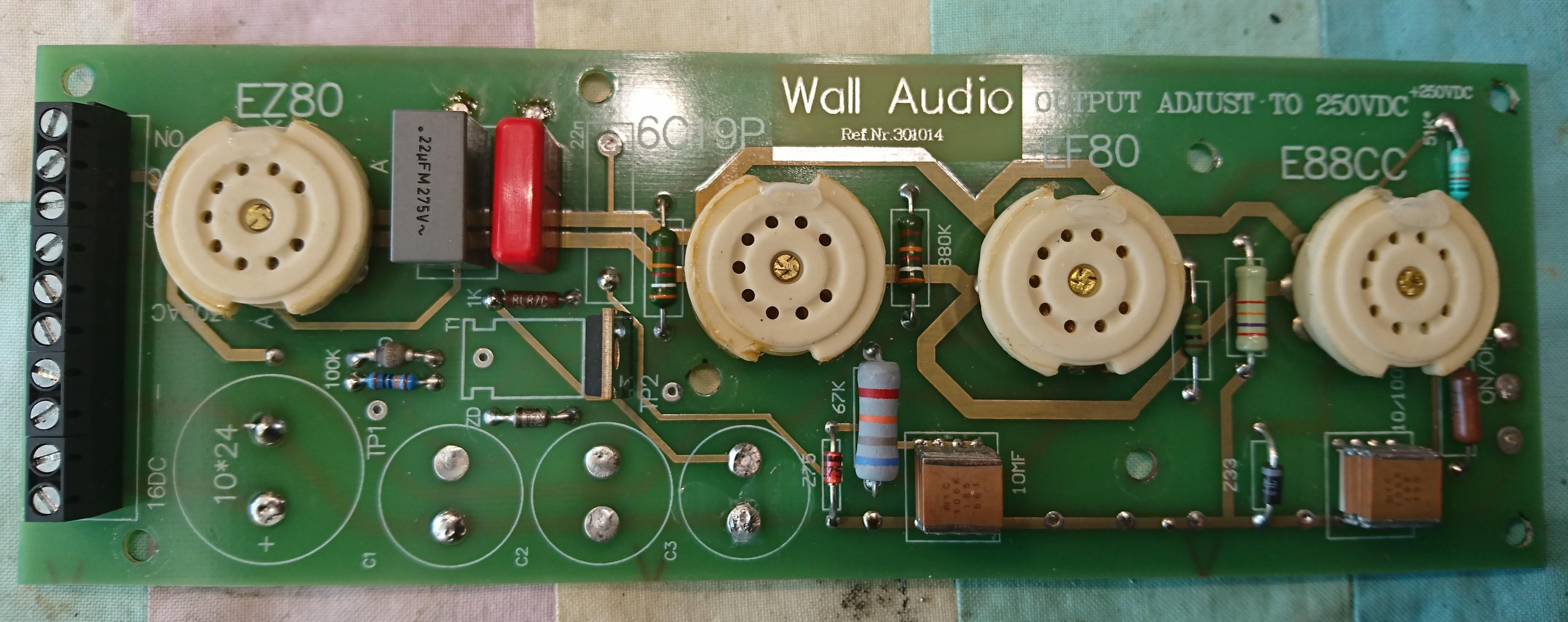

Got problems with this rectifier and regulator unit. It puts out some 100hz ripple that causes hum in the preamp. It uses an EZ80 as rectifier, 6C19P as power element, EF80 as error amplifier and a 12AU7 as reference. If I remove the 12AU7 reference tube the 100hz ripple is gone and no hum. Of course, the voltage drops to about 200Vdc. I know, some of you will find this circuit a bit strange but this is what the manufacturer has done. But clearly, something is wrong.

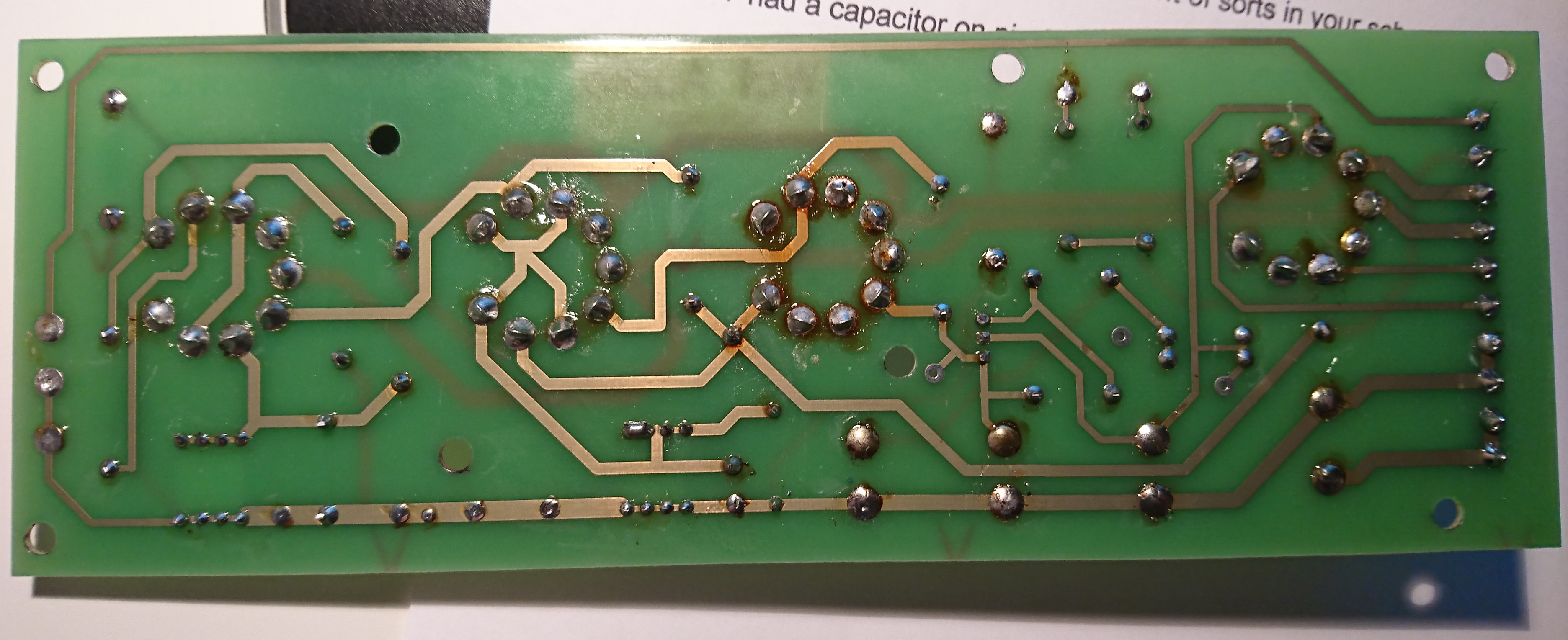

Pic of the regulator board. I`ll messure them in a short time. The board is 205 x 70 mm.

I see the print is for E88CC. If you put in a 12AU7 there is a problem with the heater.
On pins 4 and 5 the 12AU7 expect 12,6V.Here it gets 6,3V and it puts the middle of the heater circuit on ground on pin9. Pin9 is only a screen in the E88CC, no connetion to the heater.

This one original had ECC88 but now Wall is using ECC82. I was told by another "tubeguru"
The heater is ok on the schematic but the print shows different.The two heater traces from the EF80 (6,3V) are going to pin 4 and 5 of the E88CC socket witch is wrong for the 12AU7.
Since pin 9 is on ground for the E88CC you get a connection of the heater circuit via the 12AU7.And that could give a hum problem (depends on the rest of the heater circuit).

Thanks, but the print shows different and why this "Any idea why the ripple and hum is gone when removing the ECC82 tube? " if the , by the ECC82, grounded heater isn't there ?Mona, I appreciate your concern, 🙂 but believe me its been fixed.
Mona
Mona
The pic of the pcb was taken before the heater was adapted for the ECC82 tube. The ripple and hum disappeared when the pcb was set for the ECC88 and also when the pcb was set for the ECC82. In both cases the ripple and hum disappeared when the tube was removed.
