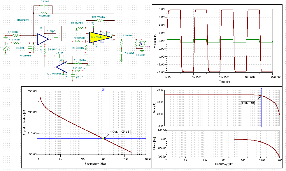

Note about the attachment. This is the smallest, cheapest but best sounding amplifier I've ever built. (Believe it or not, but better then my Bryston 7BSST mono's and better then my other discrete designs). I first built it with the OPA549. In this case the OPA549 itself only get a voltage gain of 3. the rest is up to the NE5534. The OPA549 have a relative small open-loop bandwidth, and therefore gain must be kept to a minimum.
-Opamp is NE5534 for two reasons,
1: Because of the comp pins I can slow the opamp down to match to lower speed of the LM3886. I prefer to do this in the VAS which the NE5534 allows so less compensation is needed in the global feedbackloop.
2: The NE5534 allows me to bypass it's output stage and basically use it as VAS only. (take the output from pin 5) The output of the VAS drives relative small currents to the 3886 chips, and therefore will be operate in class A. You can expand this class A range by adding a current source to pin 5 or simple a resistor from V+ to pin 5. I didn't try that yet, but like with everything, not to much, enough is enough.
The system is DC coupled and the servo feeds pin 8 of the NE5534 to adjust the bias inside the chip. Note, this is only meant for slight offset adjustment, and no more then 30mV. max input offset is allowed. Else the distortion and noise will rise. The servo is connected with 100k to pin 8 of the NE5534, however in real life, pin 1 must also be connected with 100K to ground. The simulated model doesn't have this pin, so it is not visible on the schematic.
The circuit was not easy to stabilize, but after some tweaking and calculating the result is pretty neat. Phase is under control sand square-wave look decent. Once the right compensation is there, the system is stable.
I build the same circuit with a LM3886, but of course with more gain for the LM3886 part. For less experienced readers out there, do not attempt to build this circuit yet for two reasons.
1: the VAS output from the NE5534 only has limited current capability and is not protected. I destroy a few when the LM3886 got in thermal shut down, and the VAS stage of the NE5534 destruct itself by amply itself infinity cause of lack of feedback (happends when the LM3886 is in the loop and shut down). I am working on a protection circuit, that if the LM3886 shut's down, that the NE5534 get muted.
2: In this configuration there must be a DC protection in cause of a fault. I am working on it and will come back on it later.
Other then that, it sounds fabulous. It is amazing that a system consist of only a few $$ of parts can sound this good, and blow away many expensive commercial products. In comparison to the former circuits the improvement in S/N is 19 dB! Needless to say, the system is black silent with a total appearance of noise, even with your ear to the tweeter. (thanks to the so hated NE5534 😀)

Sebastiaan said:
No, the servo opamps going to cost some $$ unfortunately (I agree here with Infinia, it ain't cheap). The Ne5532/34 have bipolar inputs and you need a FET opamp for DC servo's. The same time the offset and drift must be really low as well for the DC servo. Afterall the DC offset of the chipamps will be as low as the servo opamp.
I use LF411 (not LF411A) for my servo design. It has better specs than the NE5532 for offset and drift, but costs about $1.50. Still not bad considering all else.

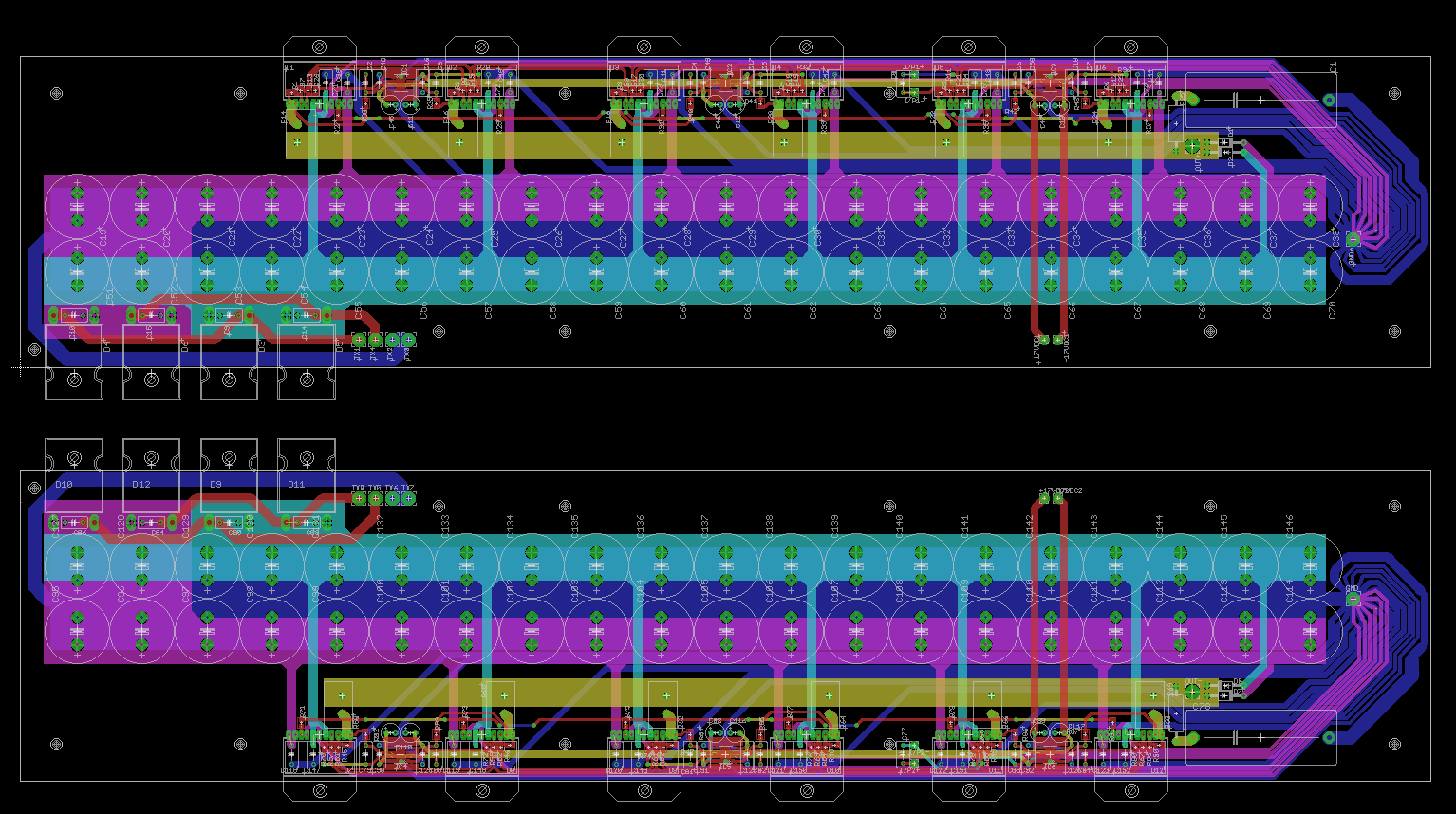

So Bas, how do servos make paralleled chips work with only 1% resistors? You use fairly large sharing resistors and don't mind an amp or so flowing between chips? How much power output did you get with your 12 chip design? Very curious about that as I'm currently doing a mere 4 chip (8 amps) one. Oh, and there have been others saying that paralleled amps just don't sound as good as single ones - have you heard any degradation between a single and paralleled design with your servos?
Sorry,
Forgot to answer your other questions. I run the system on 27 volt supply rails, and the power ratings I got was 32.7 volt in all loads up to 2Ohm, without sag, However, below 4 Ohm I could only measure with fast pulses, because my dummyloads are not capable to handle the heat and power.
I can't show the whole project yet, since it is not totally finished, but so far so good. This is how the boards look alike. (more or less, because the final boards had some changes)
With kind regards,
Bas

Dear Jules,
Trust me, U do need to slow the NE5534 down, else square wave reroduction ring all over your ears 😀 I've bin there done it.
The board above isn't for DIY purposes, but I am working on a DIY version, but there will be a new surprise. I did something different with nesting and feedback I didn't discuss yet here, but it will be amazing 😀, I just need a little more time for the finalizing.
