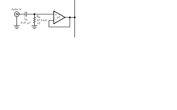

I understand the thread so far. My buffers are coupled with .47uf cap with a 47K resistor to ground to the non inverting input on a OPA2134 with the output directly connected to the inverting input. The output then drives the non inverting LM3886 input on the chipamp circuit board. Sebastian is correct though I probably should start a new thread. I need to draw out the full schematic then post it in a new topic. I think that having separate boards each with its own PS decoupling caps may be the issue. I am using a start ground for everything but each board has about 8 inches of wire to the common Power Supply +/- rails and ground. I am running about +/-35 volts for the rails. I may make it easy on myself and just run one LM3886 per channel. i have been messing with this thing way too long! Here is the buffer, essentially taken from the National Ap note for paralleling these things. I am not using the 220pf cap on the inputs. I did see another schematic that had a 4.7K resistor in series with a 47pf cap dropping the overall bandwidth.

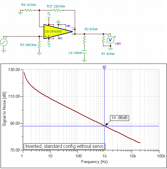

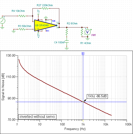

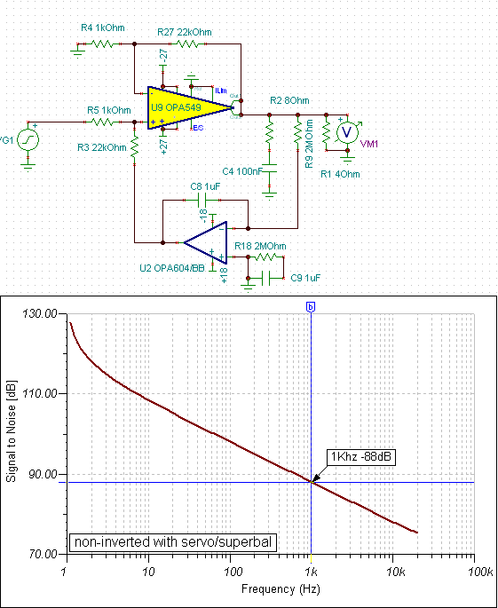

Here some simulations.
Of course simulations are not the real world, but it gives an indication, at least about the self noise of the used components. Also, the simulated chips are not the LM3886's but the OPA549's since there isn't a spice model for the LM3886's.
In real world the inverted high value resistor setup will give much more noise due RFI pick up enz.
In those simulations the servo solution is 1,5 dB more silent then the inverted one, and there isn't any noticeable difference in noise between servo or non servo. I designed multiple chip amps in real life, and never gave a servo me more noise. Using the servo as virtual ground as in the superbal configuration, the noise floor even lowered.
I don't get it why some people are so highly against DC servo's, I never encountered any problems with it, all turn out to be very reliable, good sounding without a real drawback or compromise. Designing parallel chip amps with servo sound in my opinion much better then without, due the better stability with servo.

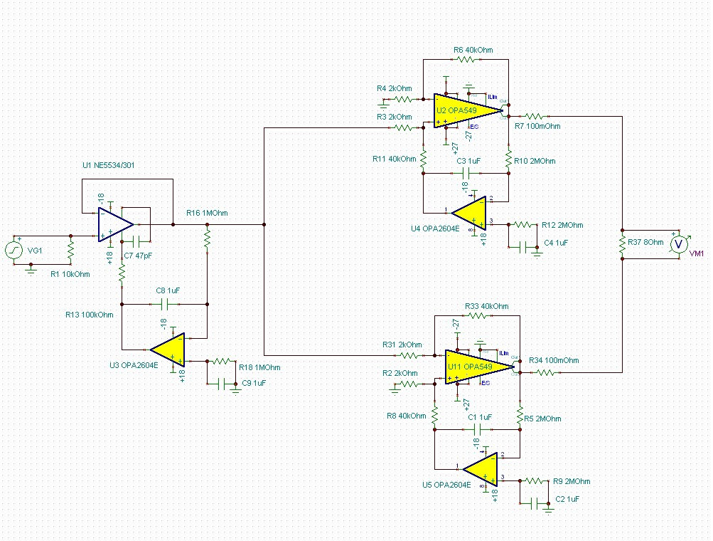

The 4th attachment contains my simple idea of how the bridged chip amp should be. In this case each chip has equal impedances for inverted and non inverted. This really contributes to a better sound quality and a more stabile chip (from experience not from simulation). It get driven by a NE5534, which get DC corrected in one of the "comp" pins. If anyone ever built such a circuit, care must be taken of a DC protection output circuit, just in case of..

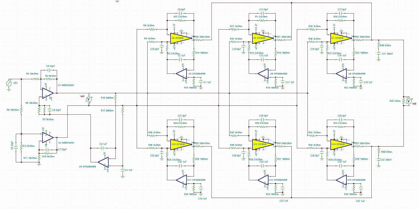

Here an idea of my briged/paralleled chipamp.
Some explanation.
-The servo's feeding the positive inputs, serves a double function. 1: it nulls DC offset. 2: it serves a virtual low impedance reference.
-Non of the input legs from the chips are with reference to ground. The cips are driven balanced with a differential signal. This avoids the chip's have a reference to a often dirty ground, and avoid groundloops/noise.
-Being driven with a differential signal, each chips maintains a good common mode noise reduction, hence lower noise and distortion
-The driver stage is totally inspired by Mr Walt Jung. The servo for this stage is fedback to one of the two drivers, so that the DC offset seen by the input of the chips is near zero.
-Amplifier voltage gain is 29 V/V
-Half of the gain is thrown away in the input stage in order to keep the chipamps in their safety gain margin with maintaing a total amplifier gain not higher then 30dB.
This circuit is build in real life, and is for a big part the same as illustrated here, but with LM3886's. The noise is the lowest I've ever achieved with any bridged/parallel chip-amp. This configuration is super reliable and stable. DC offset per chip is as low as 6 uV! total output DC offset is below 1uV. (you read it good no mV but uV! 😀)
The sound is big, tight and fast and black silent. I hope this circuit inspire some of us to do something with it and/or improve it.
