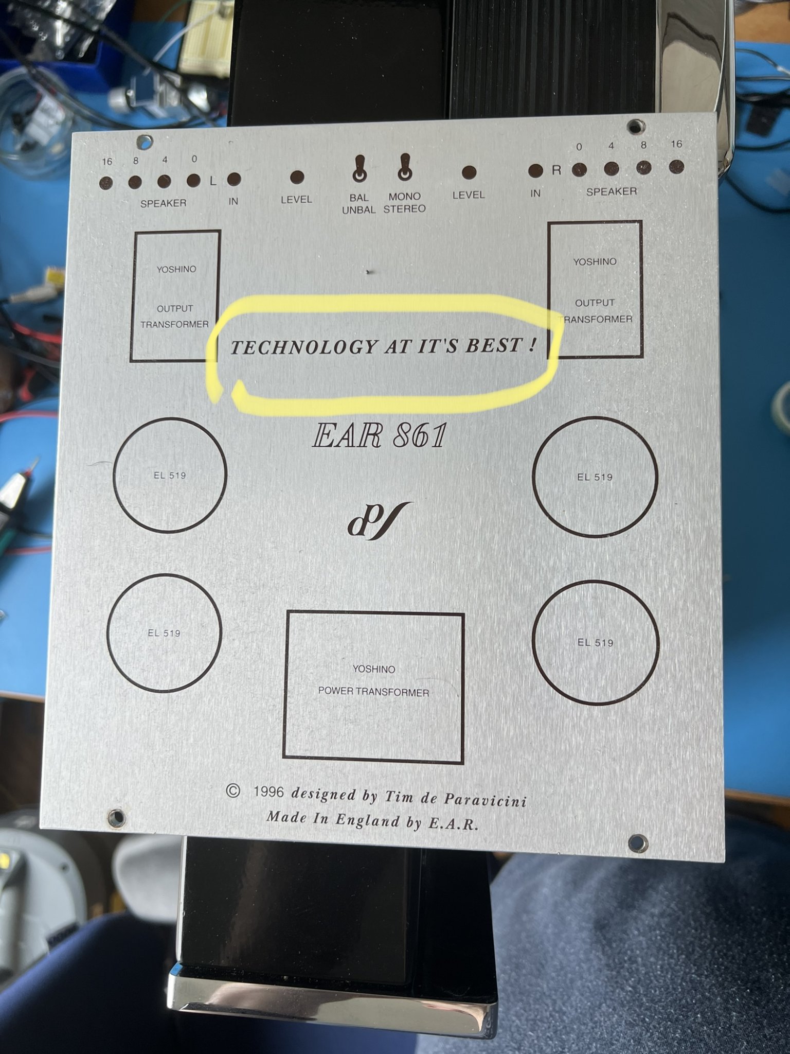

Thanks for you time. Fun is the amplifier top plate. Surely they late understand that this statement is too much. Seen photos from some years late made 861 and there aren't this statement any more. Here photo.

My German is more than a half Century unused, so I've forgotten German contractions. All I really remember now are lyrics to Die Fledermaus and Die Lustige Witwe, but can still sing the 4th movement of the Ninth. Strangely, nobody enjoys my version. Oh, well.
All good fortune,
Chris

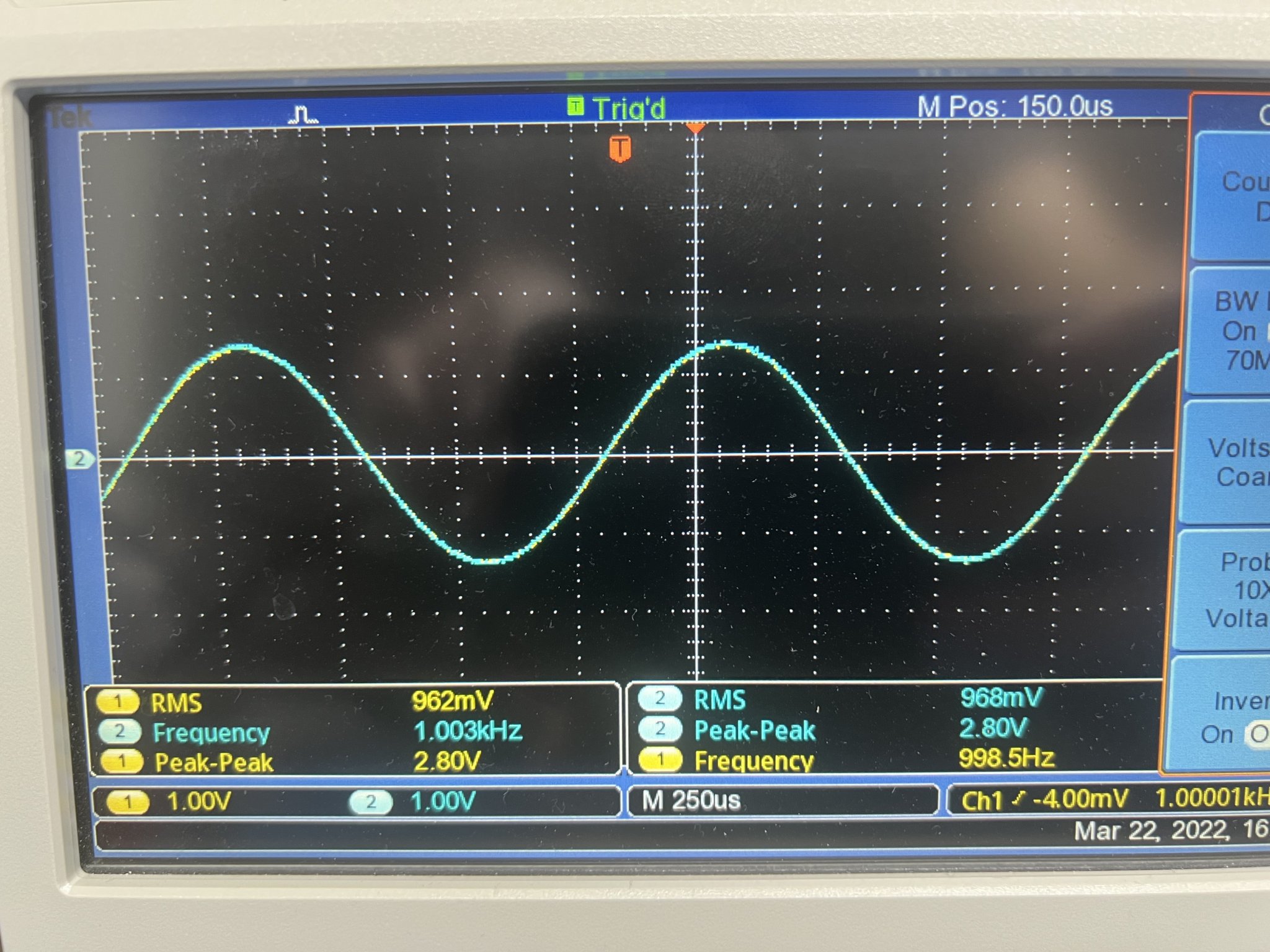

Had hope to receive today resistors shipment and planned to have exciting weekend with repair but see now that package delivery is on Monday 🙁.
Longer waiting make it sweeter - Hope there is such expression in English also.
Hi!
Problem solved😊. Had time today to change all ordered resistors. Now both channels identical. Attached new scope photo.
All thanks to Diyaudio members, specially to Chris who studied diagram and pointed correct point to check out.🙏
Rait
