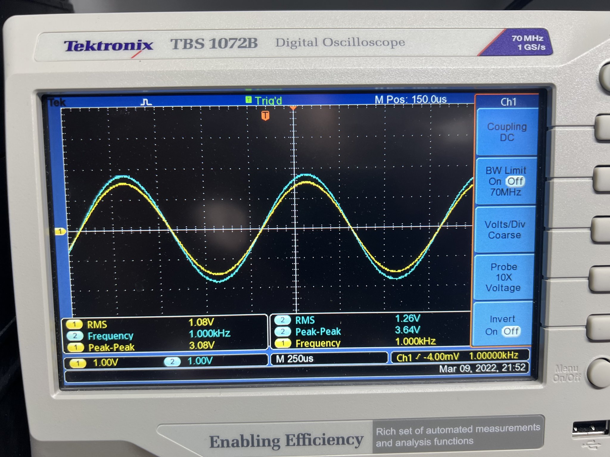

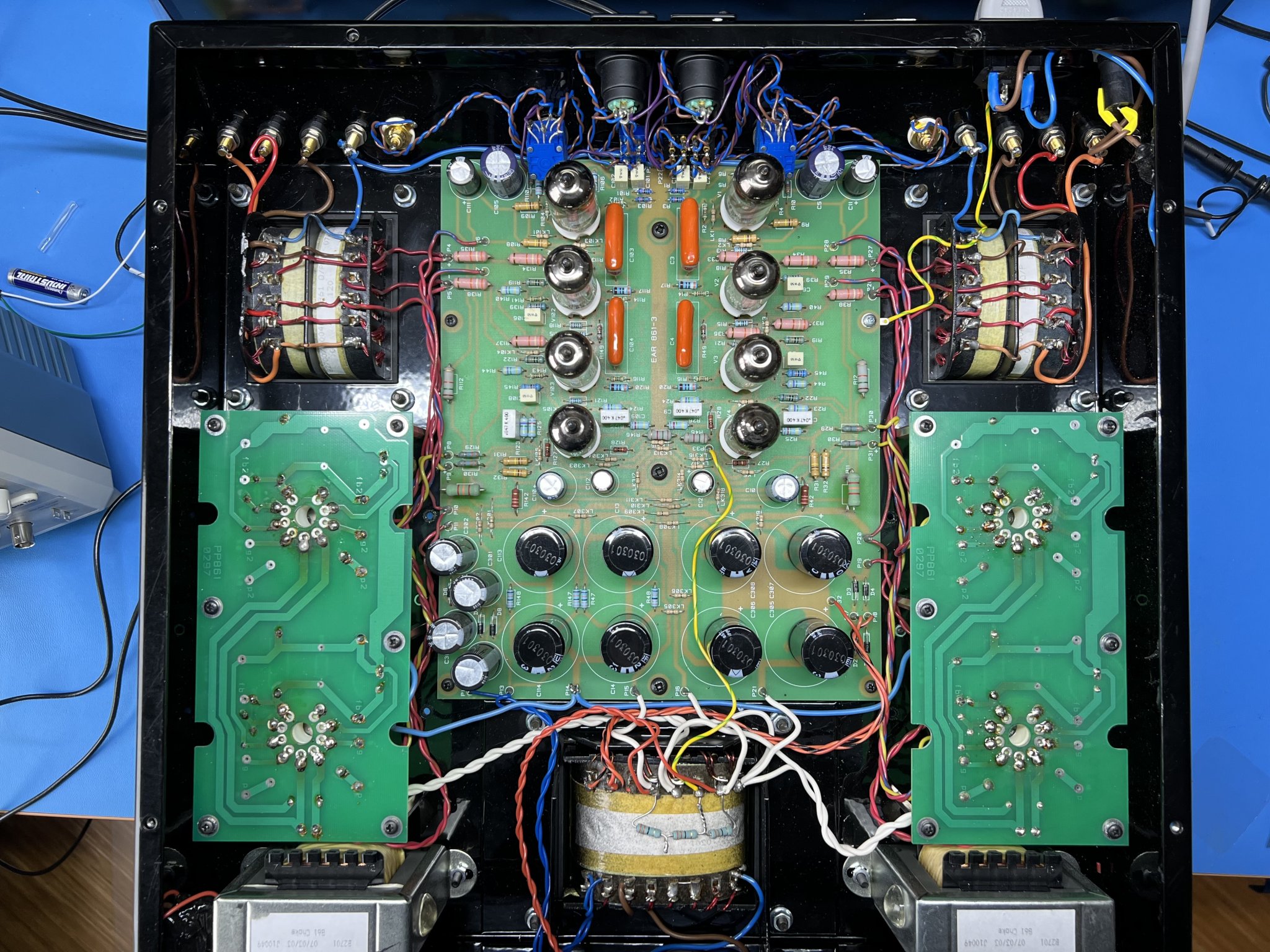

Hi.
Well made tube power amplifer with 4 EL519 output tubes. One channel is playing with less volume. Cant figure out what is problem. Attached oscilloscope photo. Input signal generator with identical voltage. Changed tubes from one channel to another, no change. Input to first tube grille identical. Voltage to output transformer is different. It is about 26 years old. Attached photo from inside also.
Hoping somebody with more experience can give ideas what to check.
Thanks advance!

What does the scope show? Output of both channels?
Do you have a schematic?
Does this amp have global feedback? If not, such differences are not uncommon.
What are the blue things in the top of the picture near the input connectors, are these potmeters, level controls?
Do they adjust level?

Hi. Yes scope shows both channels, on output with 8 ohm dummy loads and voltage difference almost 20%.
Yes blue things are potensiometers for level and with theses can adjust to equal. It was before equal and now need to adjust 1/3 turn equal to. Thinking may be some component need to be changed.
Power for both channes coming from one supply and therefor it cant be problem, or I am wrong?

Chris, thanks. Your replay put me thinking about calculations. Could you please explain barely noticeable 1 db difference you wrote. I see that with exact same voltage input, amplifier output voltage is 3,08 and 3,64. By ohms law it is 0,38 and 0,45 amps with 8 ohms dummy loads. Power will be then 1.17 and 1,64 watt's respectively. It seems big difference. Of course it can be adjusted with input but can it be taken then as normal with tube amplifiers?
Connected speakers are high sensitivity 94 db, maybe because of this I hear difference. More speaker sensitive, more you hear channels difference in small room environment ...?

This amp has two important gain-setting feedbacks. The first is the input diff stage's degeneration resistor (10K Ohm). These need to be pretty close to the same for each channel. The second is the ratio of the three-in-series 39K resistors to the 3K9 cathode resistors that they're feeding. These need to be as close as possible to "the same" for all four ratios. I'd look hard at the 39K resistors because they've been running the warmest.
All good fortune,
Chris
