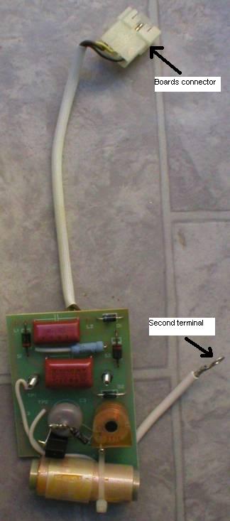

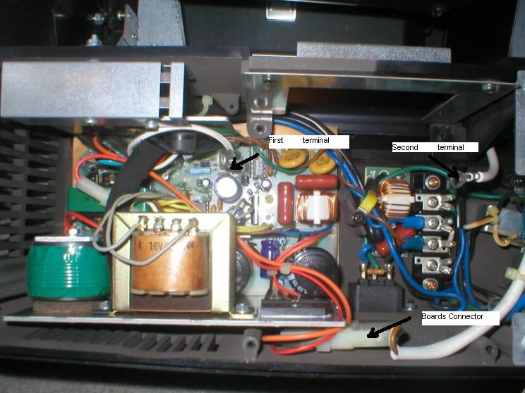

I don't know its type....
My ballast consist of two boards. I will try to post here their images.
First Board:

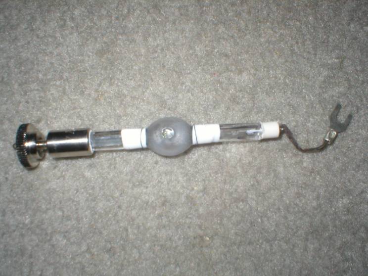

give me a pic of your new lamp
I attached a photo of my poor lamp. I don't have a new one.
