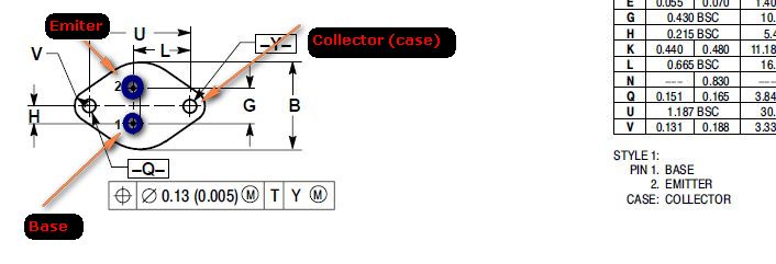

The A1N are NPN Transistor like MJ15003
The A1P are PNP Transistor like MJ15004
Both of them has the same schematic, with the same position of Base (B), Collector (C), Emitter (E). Look at the bottom of transistor, don't look the upper letters.
Look at attachment schema and marks the signs (B,C,E) to your transistors. Then look at the A1N & A1P where are the cables and doing the same.
Are you understood?
(Greetings from Greece...)
