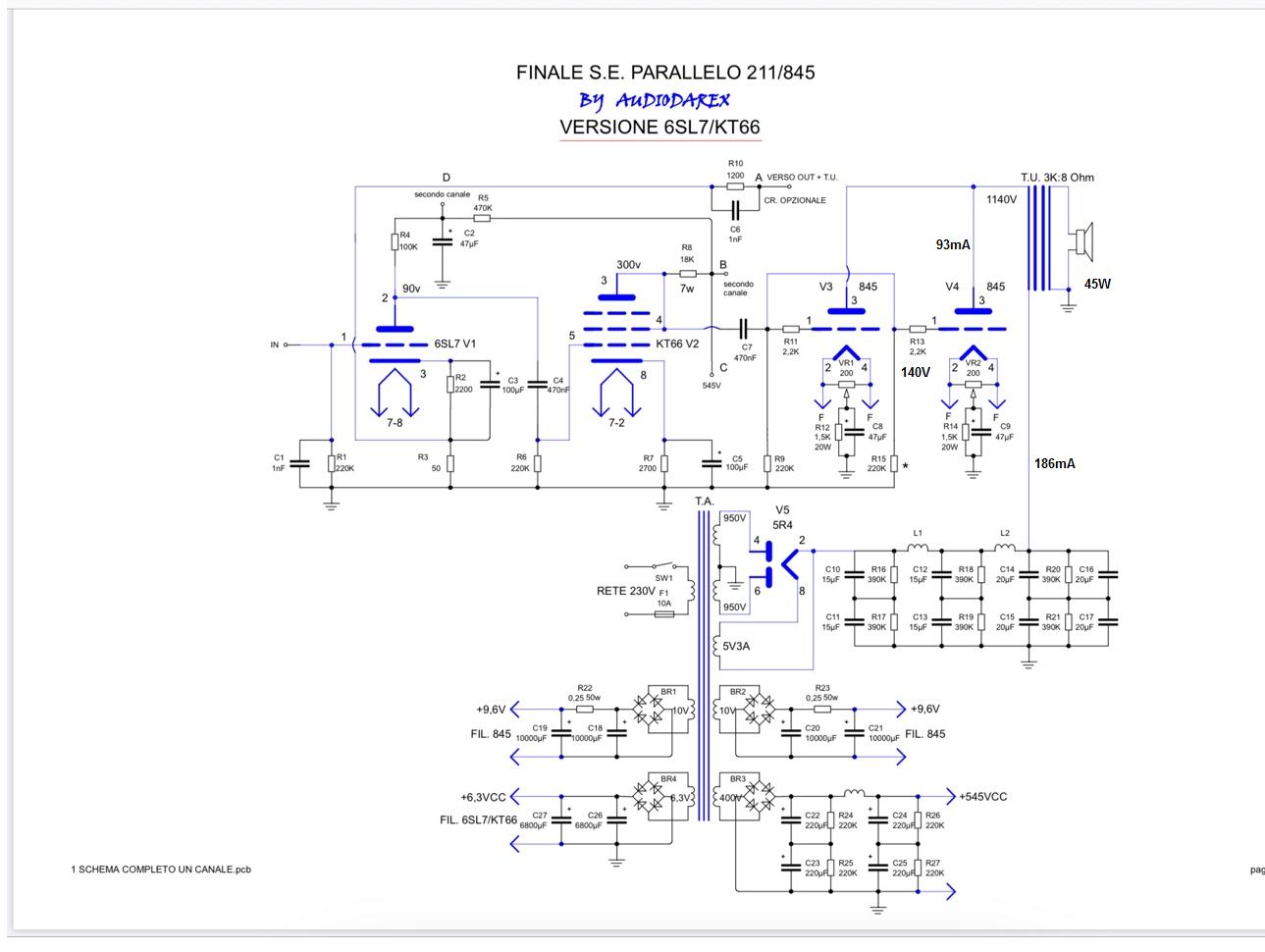

I would have some question about an amplifier with 845 tubes on behalf a person who I know, that doesn't work properly. In the case the main problem seems to be in the PSU since I observed having just one 5R4 in the first side of the schematic (for the 845 B+ supply) and this goes over the max V, from specs, even for the proper C(in).
In fact, the other consequent problem is the overheating of the transformer (it reaches up to 80-90 ° measured), which has probably led to "cooking" it.
The other doubt, is the OT with primary impedance of 3.5K wich is supposedly too low for a pair of these power tubes and leads to some distortion.
Now, since this job is quite out of my reach I wondered an opinion in order to solve the more importants problems, then any finishing touches are left in the following times.

Not an expert but I think the schematic design and load are acceptable in fact quite nice. I am sure you could have a custom winder make you a much bigger power trans which would improve everything provided they could fit it on the chassis and there is no nasty surprises like filament bridges potted in with the power trans..

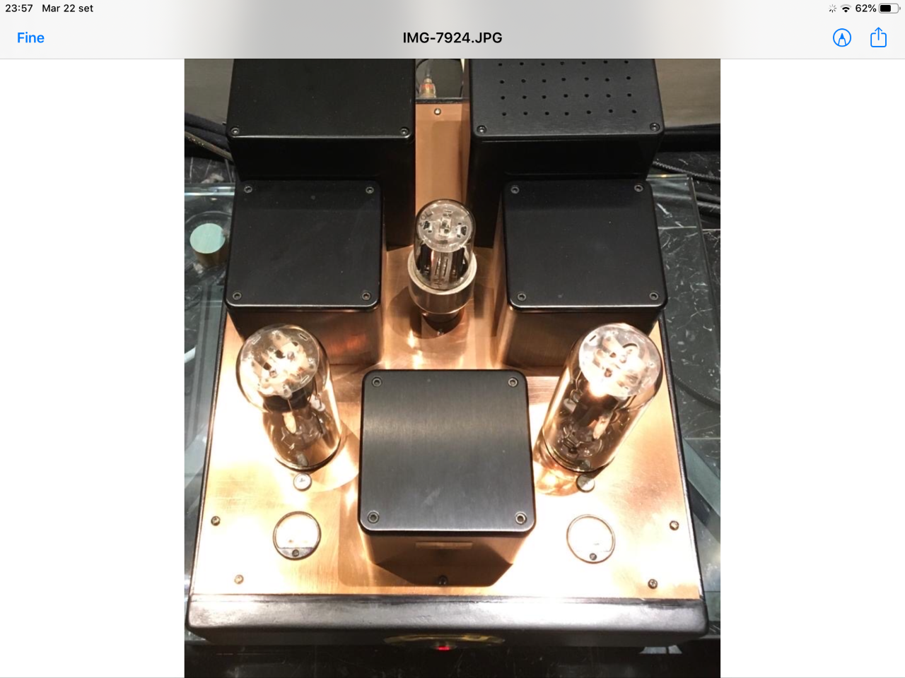

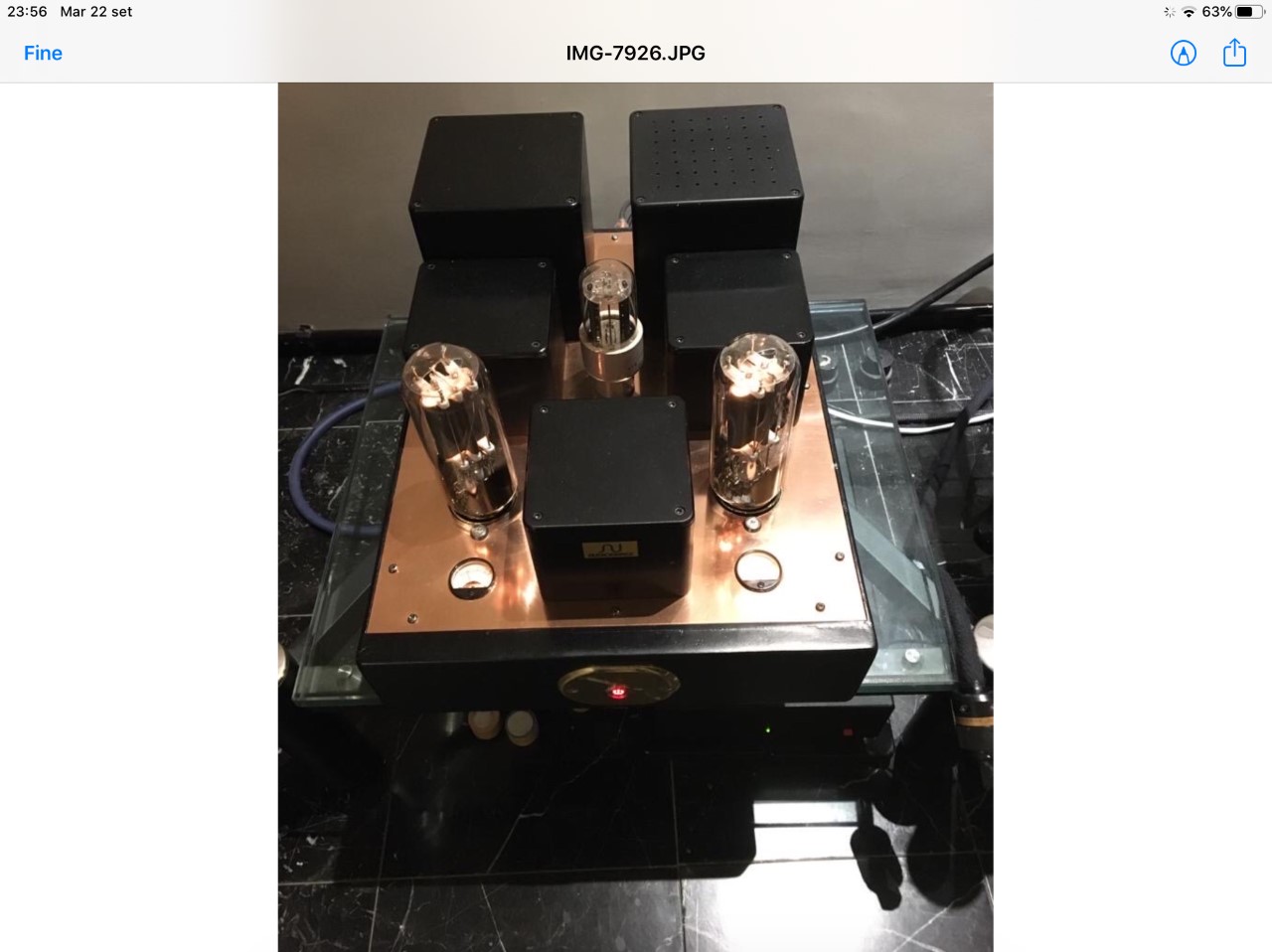

5. Post some build photos here. In particular, we can look at the size of the OT with respect to the 845 to assess if it's sufficient for the job. The 3.5K load for paralleled tubes is fine.

He called me, and said they were measured. At the input of the OT primary is a less above 900V, while it should be at least 200V more. It's clear that the main problem is the power transformer , as me too supposed, to be faulty. Current at each 845 is ok, with 70mA when full operation
It's probably a good idea to at least take the covers off the shrouds and photograph what's inside.
The 5R4 specs call for 575 Ohms of primary DCR for a 4uF cap input filter.
You have 7.5uF cap input filter (two 15uF in series).
Check the DCR of the secondary.
The 5R4 PRV rating is 2700V (depending on other conditions).
With the amp in a No load condition (like the 845s not warm, the PRV is 2687 minus the rectifier drop.
And at 93mA per 845, as well as the 13mA for the driver, you are exceeding the current and max PRV combination specs of the rectifier.
Check the ratings of the Exact 5R4 tube you have, 5R4, 5R4G, etc.
This seems like an attempt to really push the parts hard, to and or beyond their specified limits.

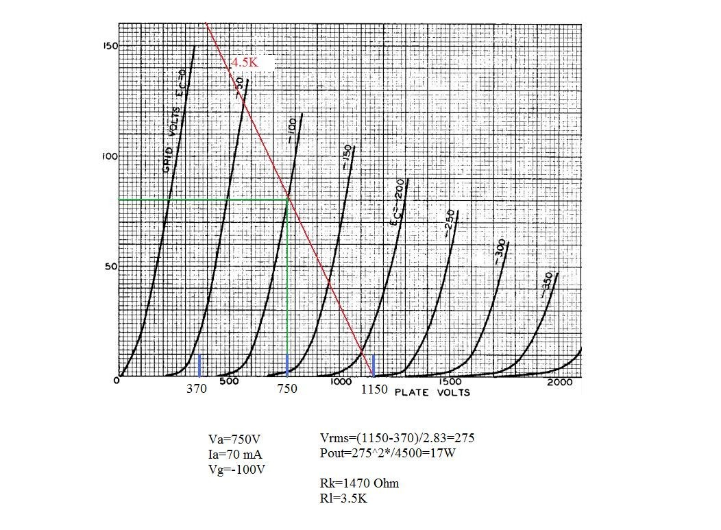

The 845 (not 211) plate resistance is 1700 Ohms, for two 845 in parallel, that is 850 Ohms. 3,500 / 850 = about 4. A damping factor of 4 is fine for a triode output that is not using global negative feedback. Each 845 "sees" 7k Ohms load.
You will have to reduce the reistance of the self bias resistors on the 845 tubes, to get the current back up to 70mA, or whatever value is needed.

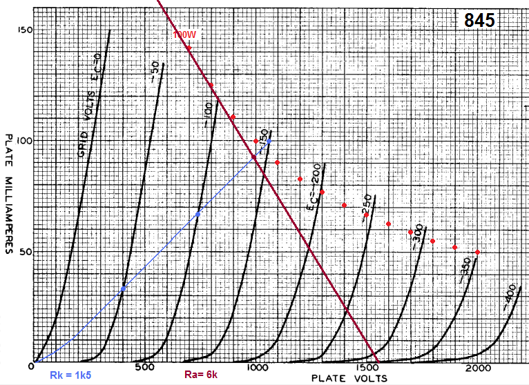

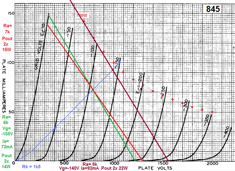

So V(ak) is 800v or so with 70ma. This seems to be a good operating point for your 6k OT (3k x 2).

That's right and more easy for the 5Z4.But this seems to be allready the case and still a hot transformer 🙁So V(ak) is 800v or so with 70ma. This seems to be a good operating point for your 6k OT (3k x 2).
The schematic has a 3k OPT and the TS is saying 3k5 (@#1), makes no big difference.

Just on going down with V(B+) I read that for Shuguang 845 tube (the owner of the amp has these ones) an option is 750V/70mA, so could be ok this graph?
Confusions confusions 😱Just on going down with V(B+) I read that for Shuguang 845 tube (the owner of the amp has these ones) an option is 750V/70mA, so could be ok this graph?
Schematic Ra=3k , you say 3k5 and the last graph is with 4k5 ???
What you have is the green or red loadline post #16.
Mona
