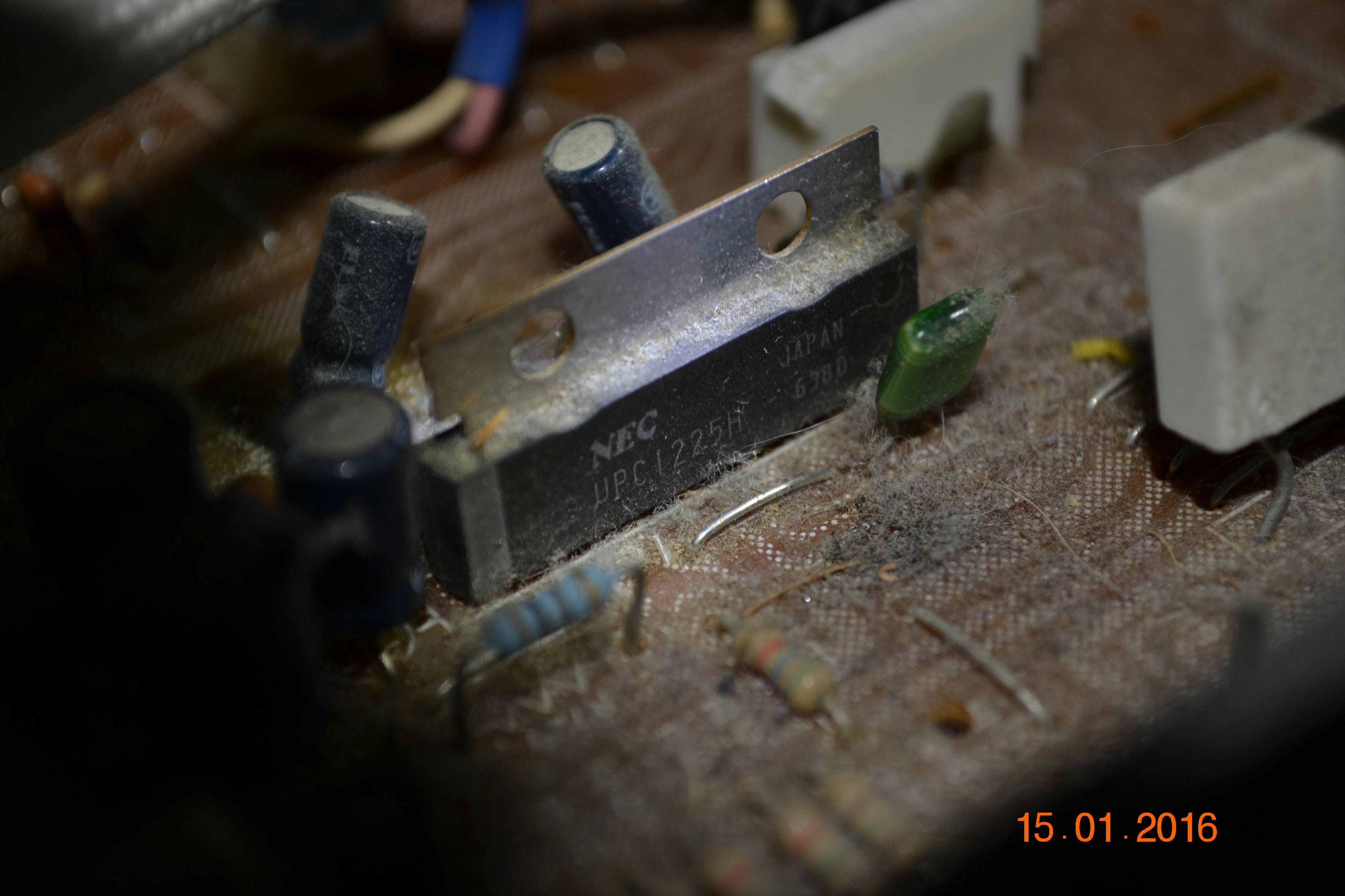

With a head torch and a precariously placed camera, I managed to get a picture of the chip. 🙂
The number isn't the one you linked, but as you can see it's similar.
I think the one you linked was a newer chip.
As you can see, it the font for the logo is different, the chip in my amp being the font the company used to use.
It has 12 legs as far as I can see, so the same, yes.
to get the picture right I very gently pressed the chip forward, and now when I've tested the amp again with my speakers, all channels appear to be working longer than they usually do.
The amp sometimes produces a clean signal, as I explained, but then reverts back to the crackling after five minuets or so, or if the amp is turned on and off, it depends.
This time though, it's been okay for about 15 minuets, which is odd...

Well a quick comparison of data sheets show them to be similar, very similar. Donberg list the 1225.
Before you jump in and start thinking about replacing this, you should first check for all other possibilities such as poor soldering on any of the pins (and on any of the other circuitry)
If the amp is OK at the moment then it could be because the lid is off and its running cooler. Try a hair drier on the area around the chip and see if the fault appears. Also give the board a clean with a vacuum and soft brush 😉

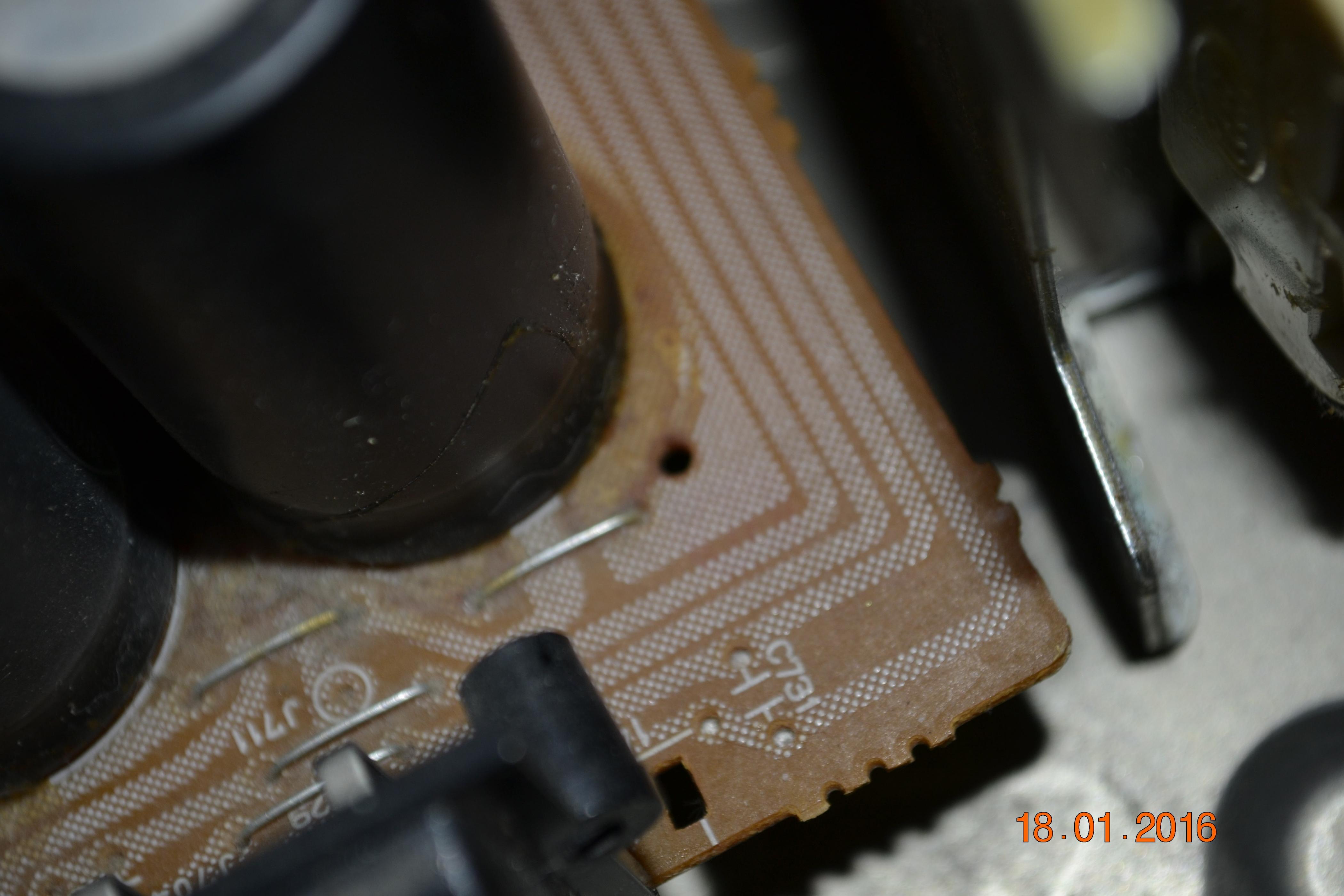

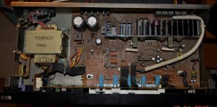

I've dismantled the amplifier amplifier now.
removing the board from the actual casing seemed to be impossible - the power supply was fixed and irremovable to the outer casing, and the outer casing's parts were welded together, so It was a bit cumbersome.
What I have now though is the parts separated from each other at least after removing the screw.
It's enabled me to examine the soldering of all components.
I've attached images explaining my findings.

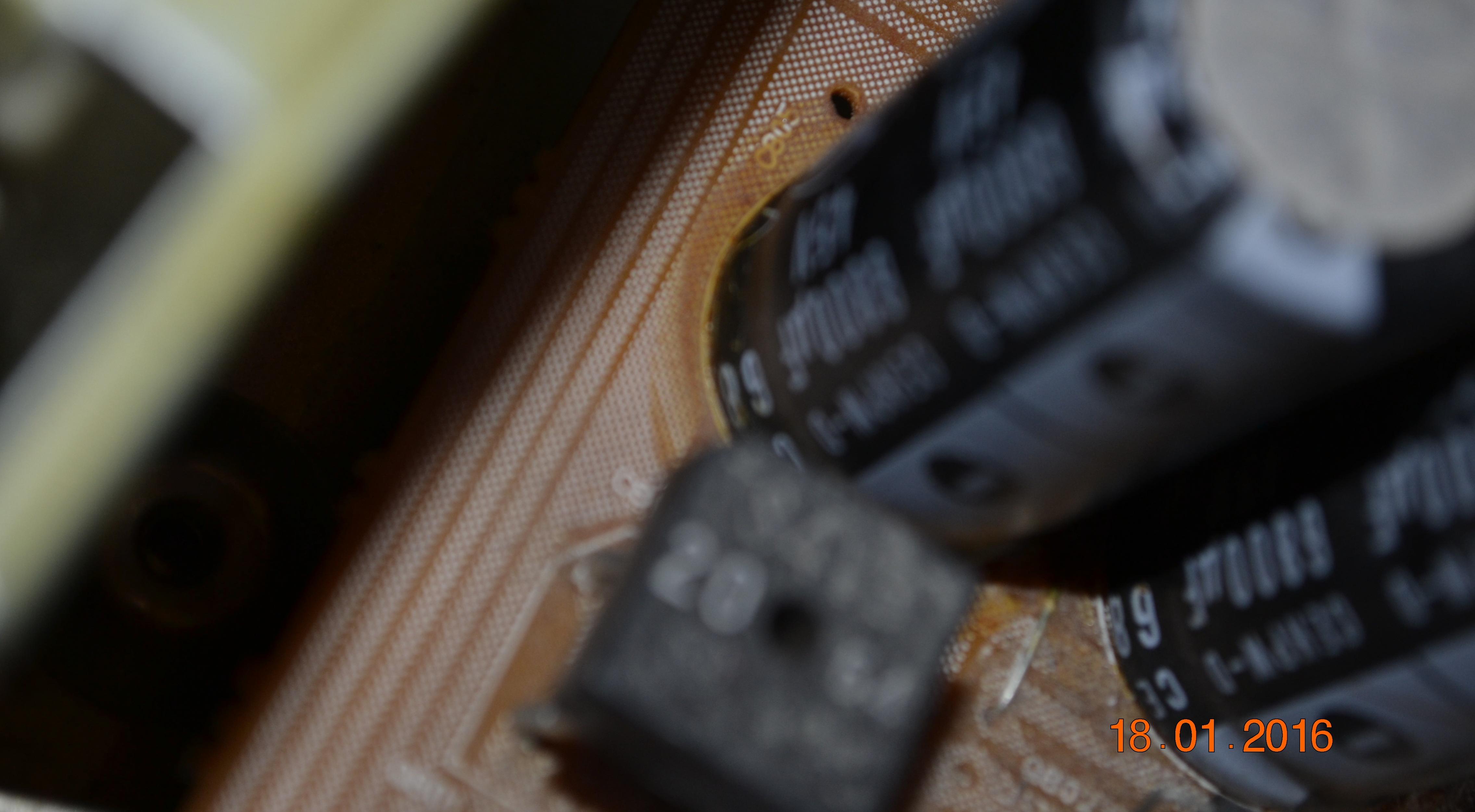

The first thing I noticed was a yellowing underneath the big, black capacitors.
Wasn't sure weather this was normal or not or weather it was a leak, but a quick search online showed a leak to an average cap leak to either be visible from the slits at the top, or most cases to have completely destroyed the PCB underneath creating a hole.
the second thing I saw was some candle wax, that appeared to have seen spilt through the grill on the outside case, onto the PCB and through to the bottom.
It was only on the board, and didn't come into contact with any components, and I got rid of it and wiped the area clean.
Next I started to examine the soldering on the main board, to see if I could spot any examples of drying, and I saw that on a fair few solder points, there was an orange, sticky looking substance around the solder.
In terms of the drying, I have to say I couldn't really tell weather it's dried up or is okay.
Obviously, there are examples online I've seen where it's obvious, but may like the picture you linked, Mooley, weren't so obvious to my untrained eye.

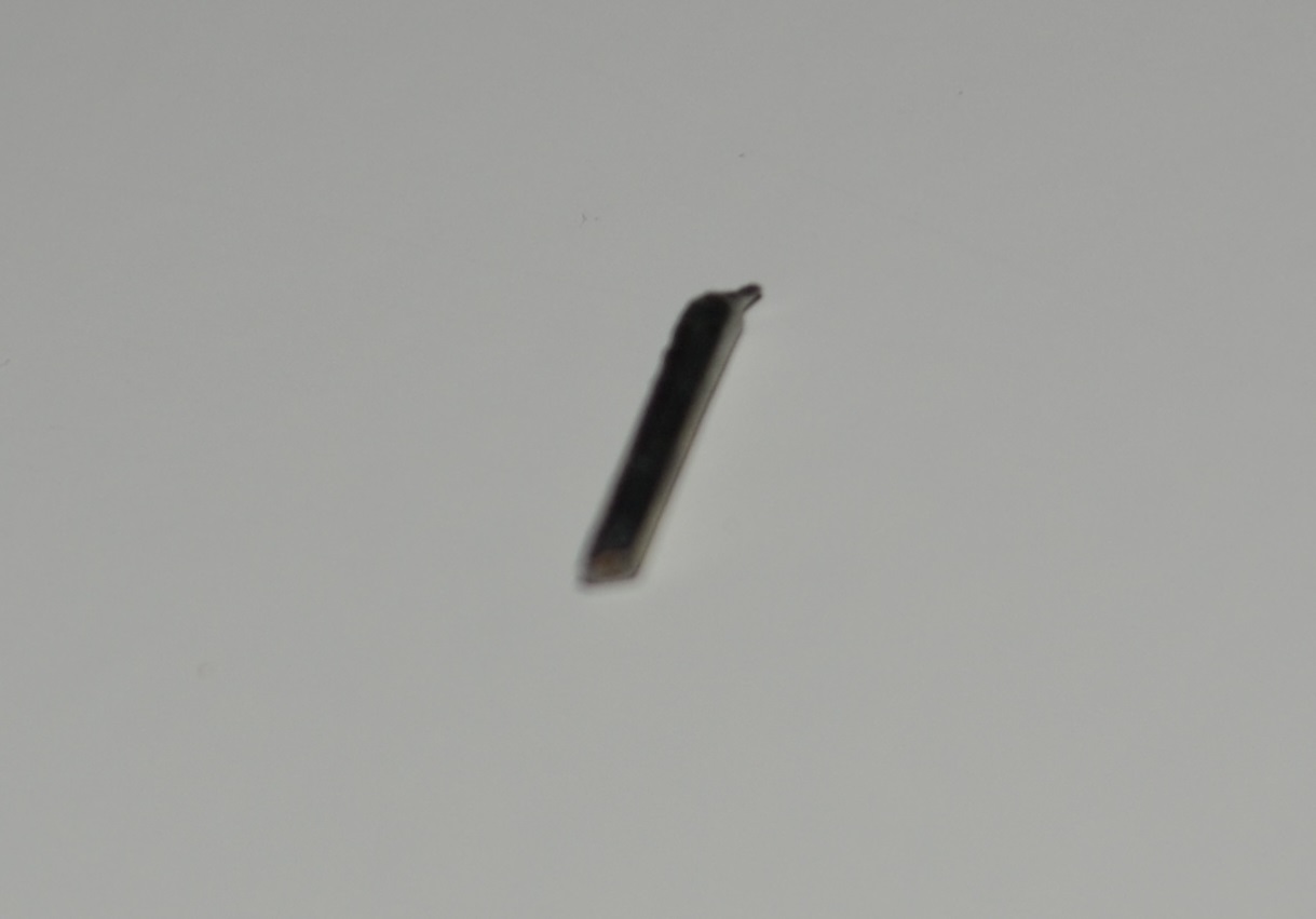

The last thing I found was a leg of a component that broke off when I brushed the board clean - It had clearly been hanging on by a tiny thread for some time and came right off as the brush passed over it.
I didn't even realize until I heard it drop down into the case.
I picked it out and tried to find where it came from but unfortunately I couldn't, so I have the broken piece here next to me.

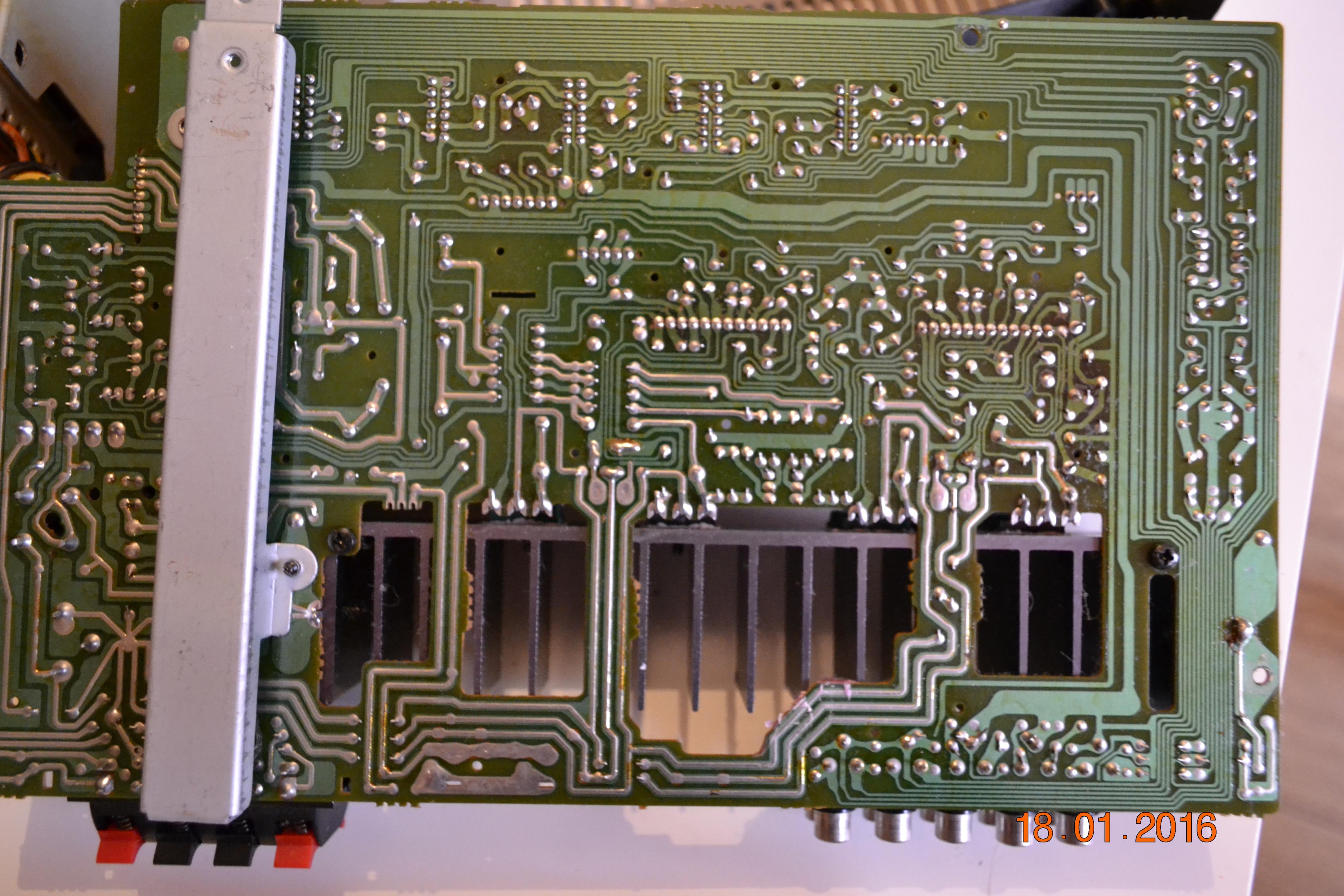

The photo's attached show all of what I explained as well as a full shot of the board.

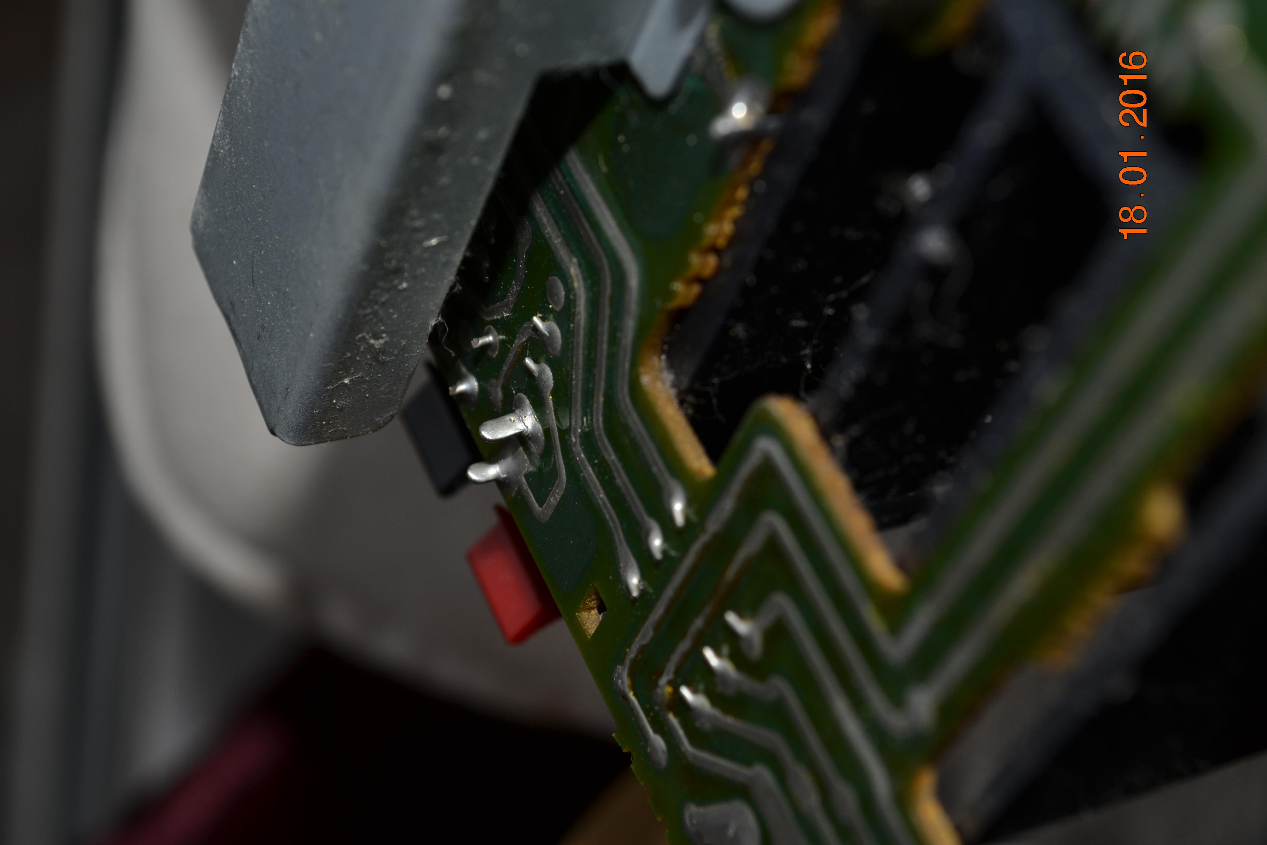

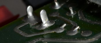

EDIT: After looking again I've noticed what looks to be cracked/dried solder.
The solder appears to be connecting the 8 inputs on the back of the amp.

It looks like the IC pins have all cracked off the board/ can clearly see circular cracks in the solder around the pins. I think a full reflow is in order. Not sure what to do about the broken pin, but if you can't see any component with a pin missing (look for it like you would hunt down a broken tooth, it'd be pretty obvious) so it may be random debris.
The capacitors will need replacing/lots of heat damage from the brown colour on the board, likely caused over the years. I can see a bit of electrolyte corrosion on the board just under the cap, but the pic is not in focus so can't tell for sure.
That brown stuff around the components and tracks is essentially flux that was originally around the pads, but melted and flowed around the board because of the heat (at least, that's what the pics indicate). Capacitors that have spent so much time under heat will need replacing.
Oh, So it has.
Just got back home from college so and I couldn't look at the uploaded images I'd blown up on the Ipad for some reason.
It's clear now I'm on my desktop PC and can, to the naked eye that wasn't visible.
Perhaps there are more pins that have dried throughout the board.
All I spotted initially was the one by the inputs.

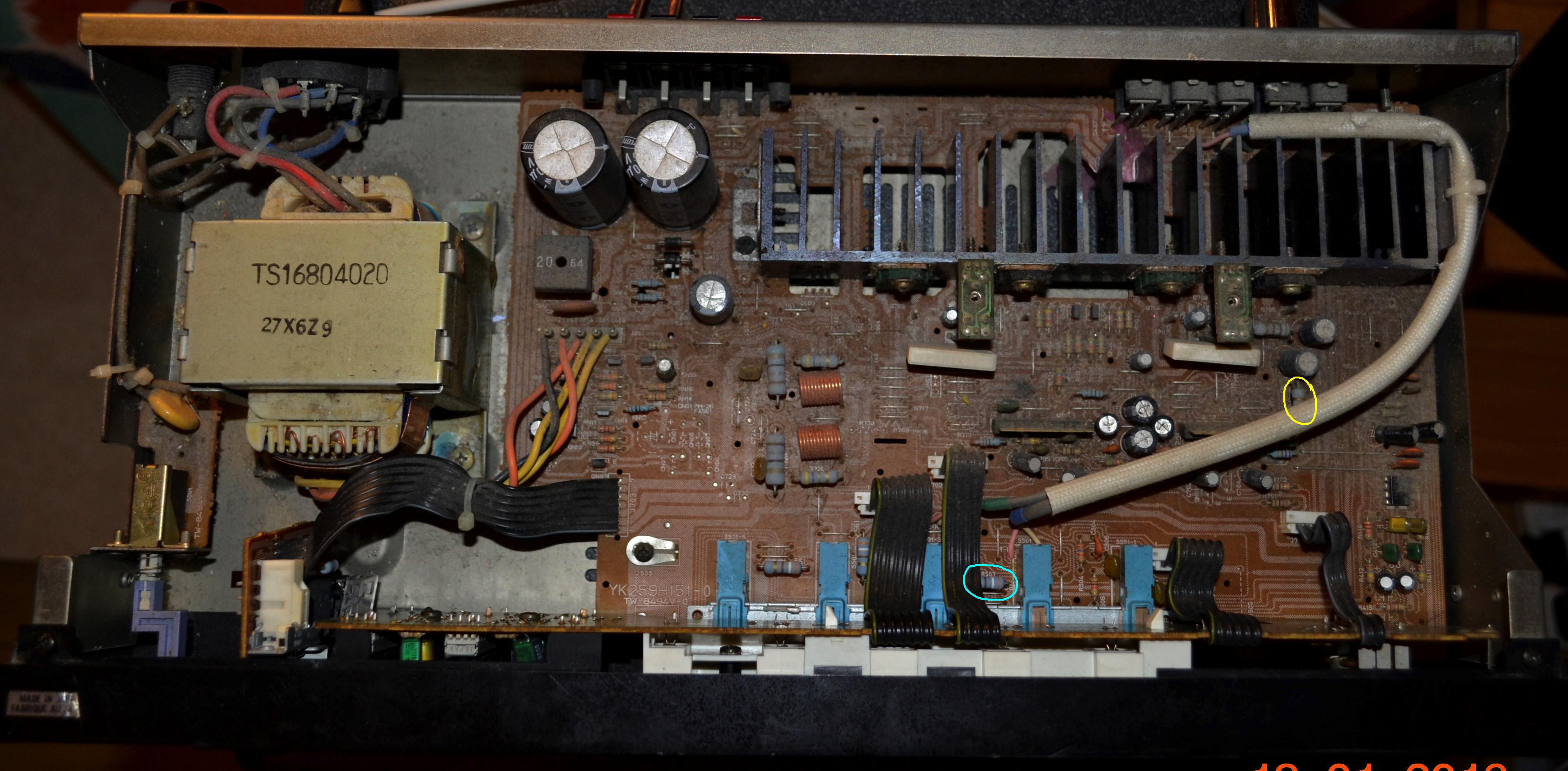

I've linked a picture because I wasn't sure what the signal input wire was, haha!There is a lot of discoloration around the right-hand side driver IC, likely caused by the big blue resistor. My guess is that it is the supply resistor for both the driver chips, unfortunately can't see the colour code as it's obscured by the signal input wire in the picture. That is what would have caused the crackling in the first place - and the right channel would have been the one to die first, correct? That chip has lost every single solder pad contact.
Is it the blue or yellow circled resistor you're referring to? I would presume the wire you're talking about is the big one, so the yellow one?

Yes, a full resolder is in order here. Those IC's look as though they could almost be removed 🙂 I would advice going over all the joints although those obvious ones are almost certainly the cause of the trouble at the moment.
You need to be careful when doing this work because its easy to accidently short something and not notice, or for a blob of solder to fall on the board and go unnoticed.

From what I can make out from the pictures, I don't think you will have difficulty reflowing the majority of joints. The solder should take to the pins instantly.
Pads... are any of the points the components solder to.
In the third picture of the first group I can make out several suspect joints apart from the IC.
You need the correct type of solder, nothing fancy, just a traditional 60/40 flux cored type. Don't get lead free, its harder to work with. And you need a good iron with a fairly large tip that will hold the heat.

Yes, I see them now.
Didn't notice until the image was enlarged.
Thanks.
EDIT: Just noticed another two now as I posted the picture 🙂
