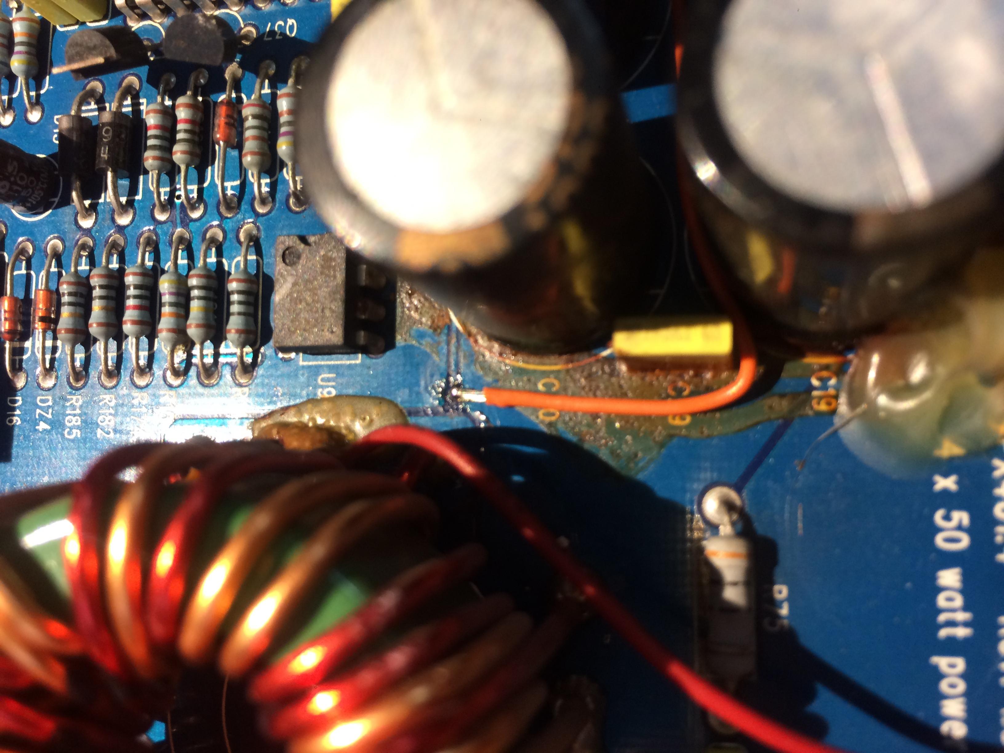

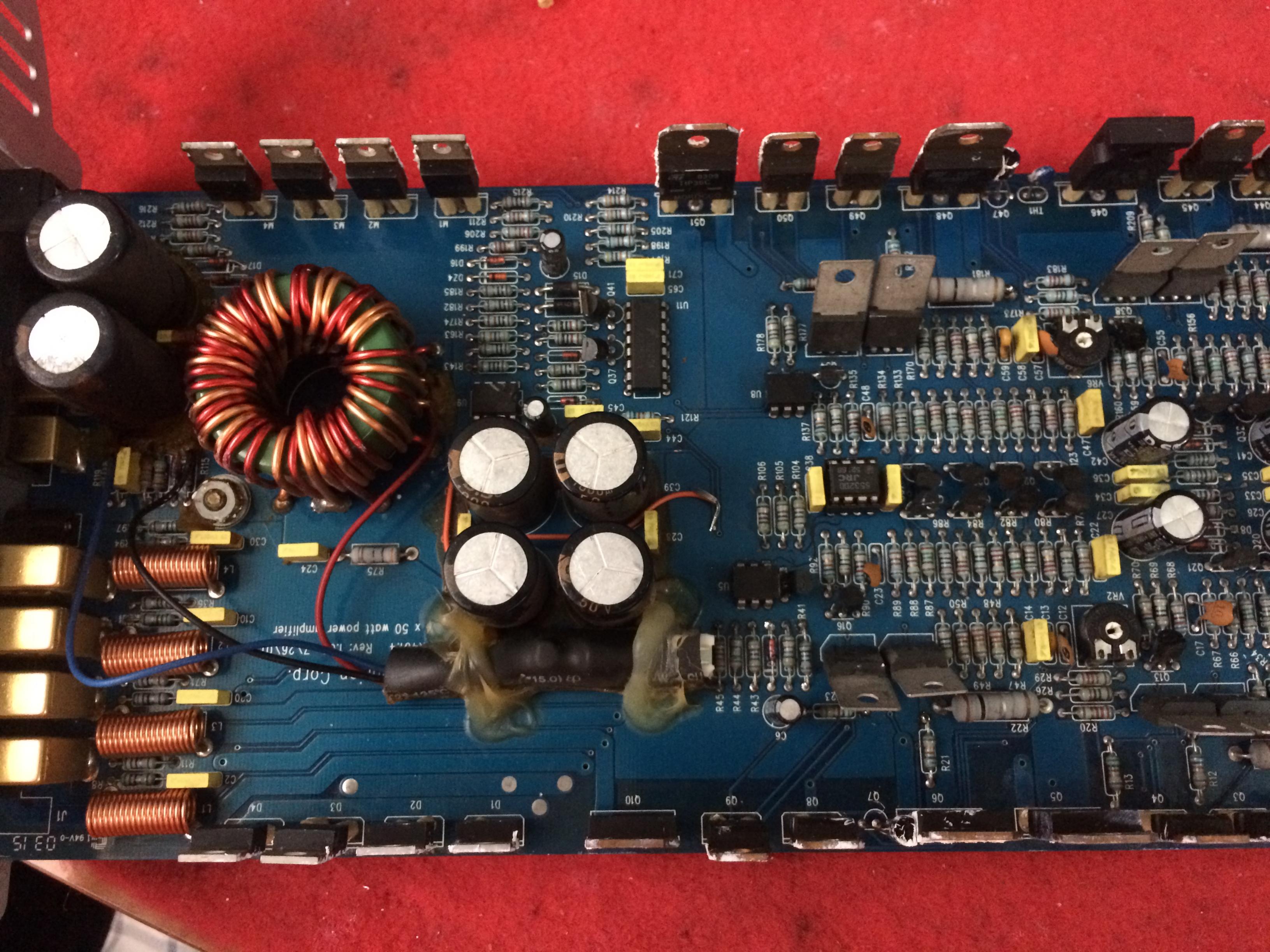

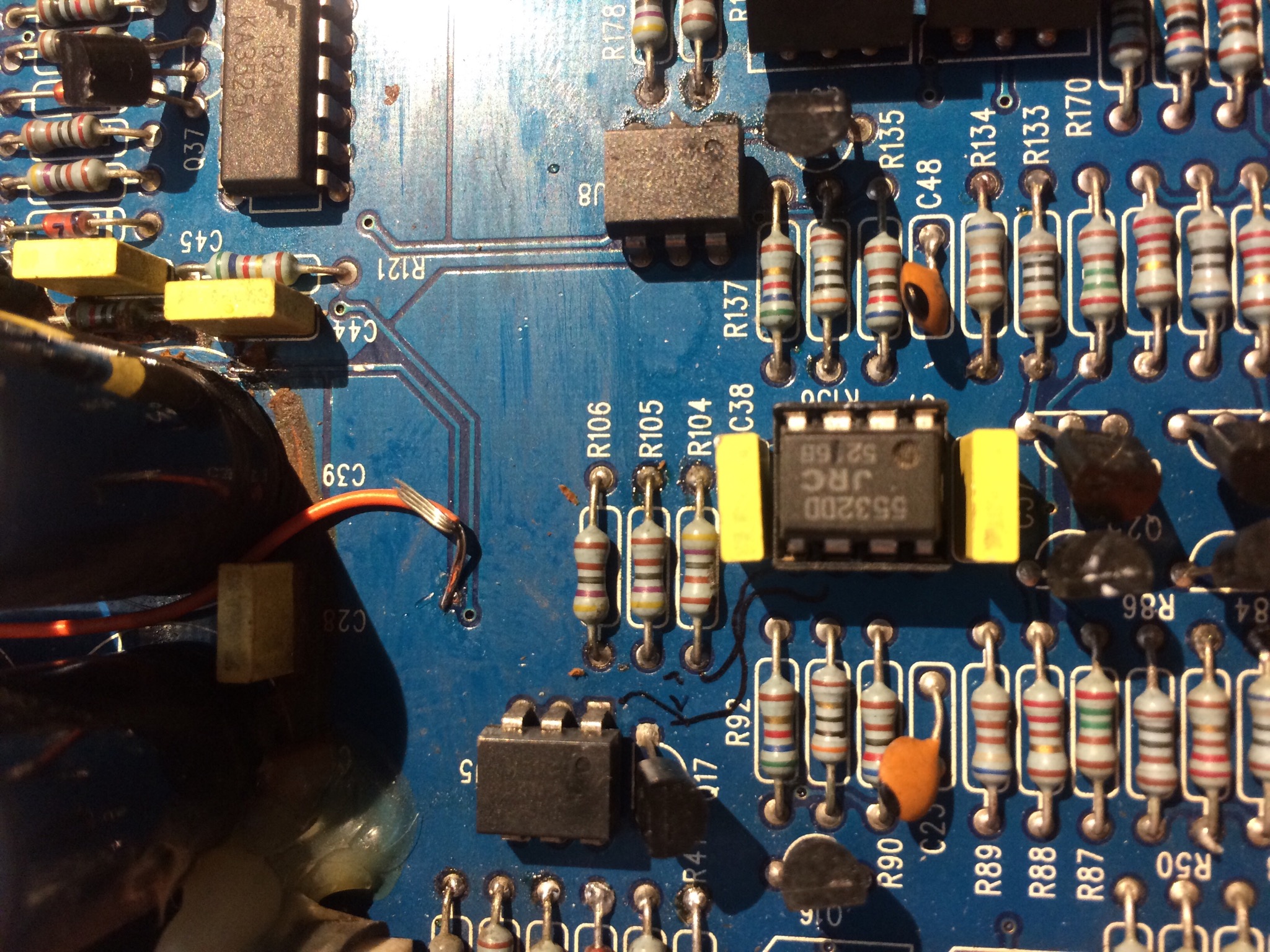

I have found the solution to the problem at the absence of sound
The problem to the absence of sound is this:
the fault is the absence of power in the IC U5. the communication has broken like a fuse, we have to put that communication back together. a simple cable will connect +12 to pin 1 Like a photo

Thanks adrian74 for the tip! This appears to have resolved the issue with my amp. How did you ever figure this out?

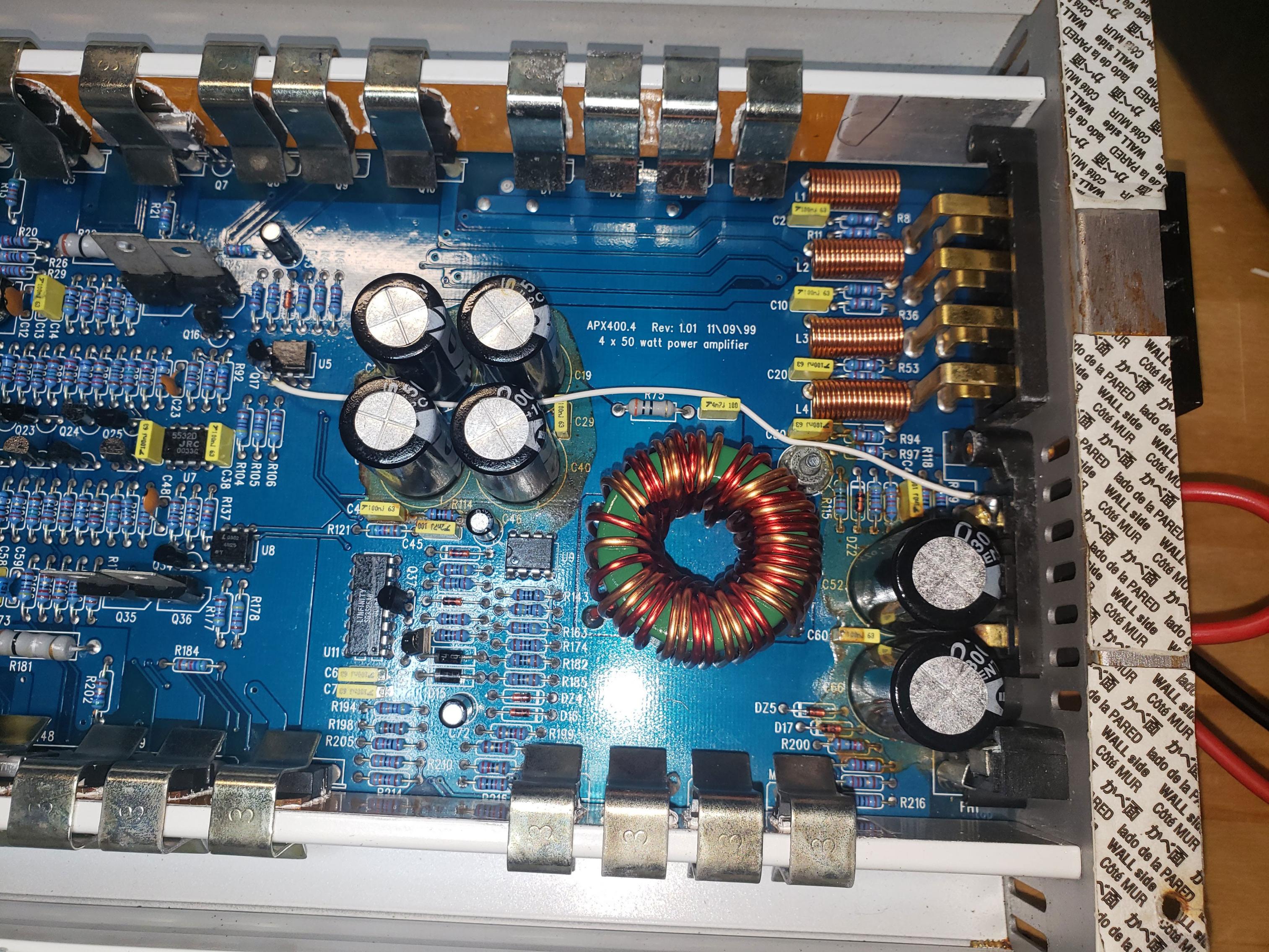

I followed your instructions to assert +12v to pin 1 of IC U5. I didn't solder a jumper directly to the PCB though. I wrapped one end around the leg of pin 1 on the IC and soldered. On the other end, I wrapped it around the remote power (input to amp to remotely switch it on) and soldered. I'm not sure how much power this IC draws and if it won't work correctly getting its supply from the remote power pin. I did it this way because it was easy and I didn't want any parasitic draw. The amp worked on my bench successfully. Now it is time to reinstall to the boat.
Thanks again! You saved the day.
I just looked at the datasheet for IC U5. This is a 4N25 phototransistor coupler. It looks like pin 1 only drives an internal LED for the optocoupler, so this pin should have minimal power draw. I feel better now that I wired it to the remote power switch. Should not have any ill effect.
