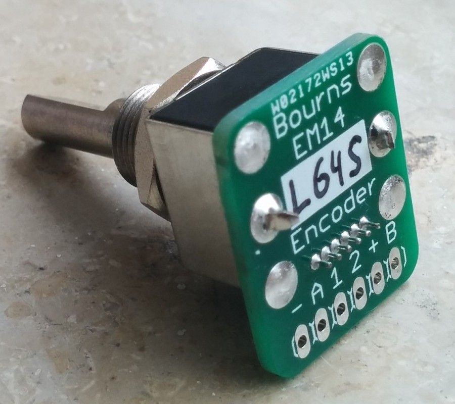

I have good experience with Bourns EM14R0B-M25-L064S optical encoder. It works smooth and does not require debounce except for the push button switch if you use it. In my setup I skip 3 out of 4 steps since I only need 64 steps for my volume controler.

Hi oleg thanks.
will it make 256 steps in one revolution like you suggested earlier?
I found this one:
ENA1J-B28-L00064L | Bourns 64 Pulse Optical Encoder with a 6.35 mm Round Shaft, Bracket Mount | Bourns
It looks like the one you suggested, but no push putton, i want push button.

Well, it looks similar to the one that I suggested but if you need a momentary switch then it won't do it. The one I suggest has five main advantages: it has a switch which has independent connection from the other circuitry, the A and B channels do not need a debounce to operate smoothly, it has a mounting bracket which can be used to hold the adapter board (see attached), it also has a long shaft which is convenient and it has natural metric dimensions - 6mm shaft diameter and M10x0.75 bushing thread. And yes, it will do 256 steps in one revolution. It took me a while to select the encoder which has all the features which I may ever need. One problem with it and probably other optical encoders from Bourns (but I haven't tried the others) is that the shaft does not have snag fit in the bushing and have noticeable "play" which results in wiggly knob motion if mounted directly on the encoder's shaft. The solution is to use shaft extension and mount the encoder a bit deeper in the enclosure to minimize the knob wiggle when turned. The encoder that I suggest is available from mouser (it is out of stock now but will be back in stock at the end of August). It is also a bit cheaper than the one that you found.

you guys should really try this 'motor looking' encoder with bearings.
it has to be tried to be believed. please trust jeff and myself, this is an amazing part and 2 orders of mag. over the crap most people use for rotaries.
don't go more than 360 or 400ppr as the software will start to lose events, even if you do very little in the polling loop. 360 seems to be a perfect res.
I get very close to pot simulation with mine; a full rotation can give me 96db or more! you can divide out the pulses (I have a modulo in my code where I wait until 'n' events are seen before I declare 1 user event) and that's tunable.
no push button on the rotary. you won't want one and won't miss it, either. trust me 😉
buy one for $15, try it and if it sucks, then at least you tried; but you owe it to yourselves to TRY this. everyone I let try my preamp raves about the 'knob feel' and since its opto, its bounce free. you DO need damping or it will freewheel spin. for now, I'm using stick on felt between the knob and the front panel to slow it down and that seems to be an easy and effective way to do it. will be trying other ideas, later, too.

Thank you linuxworks.
I guess ill oreder both, what you and Oleg suggested.
How do you pnael mount it?
Any Handy pics on how to monut it?
What do you mean, i dont understand.
panel mounting is via 3 screws (m3 thread x 8mm deep, assuming 1/8" plastic front panel, which is my standard). if you search on ebay (if I find it, I'll post) there is a diagram on the hole pattern. its exactly 3 holes around a circle, evenly spaced. I use flat head screws. on amazon, you can find samples if you search on 'axa144' (expensive for those screws, but its what I ended up using).
I'll try to take some pics of my panel without the rotary on it.
the other way (that I think is better, if you have room) is to put the rotary far behind the panel, inside the box, and use old style shaft extenders (like old pots that were mounted near the back panel of the chassis). this way you further decouple the knob from the device.
as for free-wheeling, if you turn the knob, it will spin for many turns on its own. some may like that, but if you have a full 100db of range on a single turn, you won't want to have the volume run up so fast like that on just a 'bump' of the knob.
so, I put felt (cloth with sticky side and fibers on the other side) between the front panel and the knob. that cushions and slows the spin so that it won't spin and spin and spin on its own 😉
felt is not the best material, but its my first try at damping the free-running spin of this motor-like bearing based device.

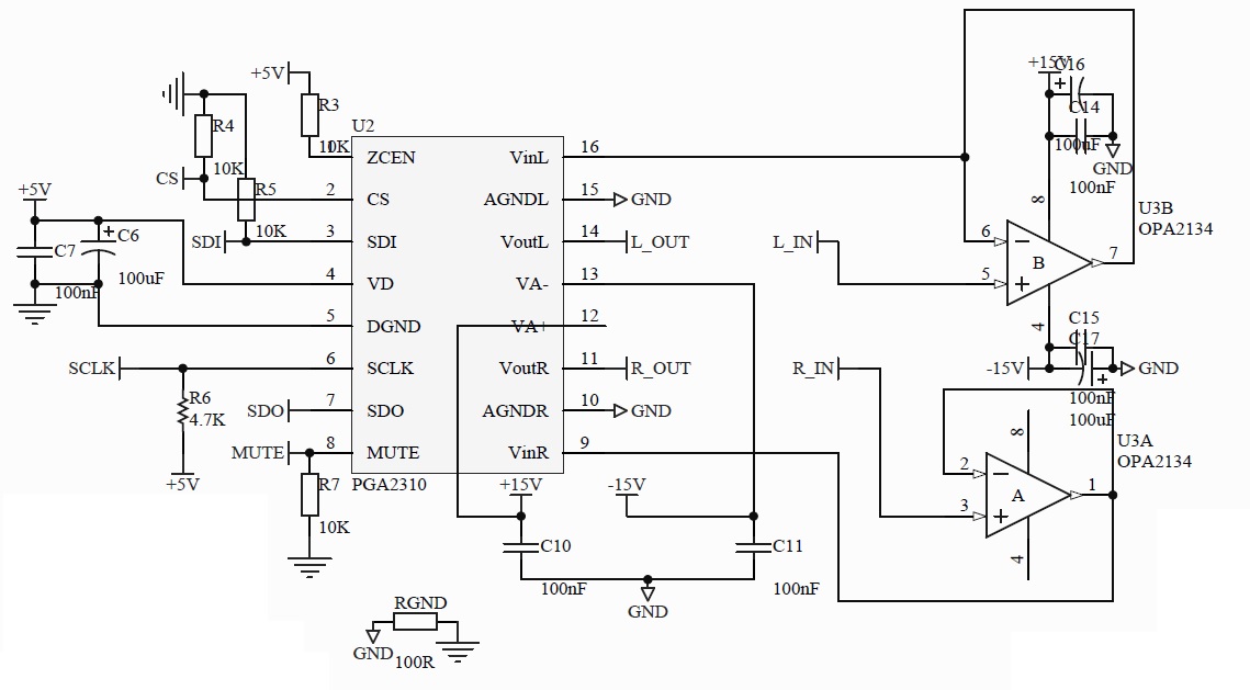

hi guys.
i need some advice using pull up and down resistors.
i found a design over the net but i cant see any where if its verify.
pin1 - ZCEN - to 5V via 10k (in series).
pin2 - SC - pull down 10k
pin3 - SDI - pull down 10k
pin6 - SCLK - pull up 4.7k
pin8 - MUTE - pul down 10k
what do you guys think?
