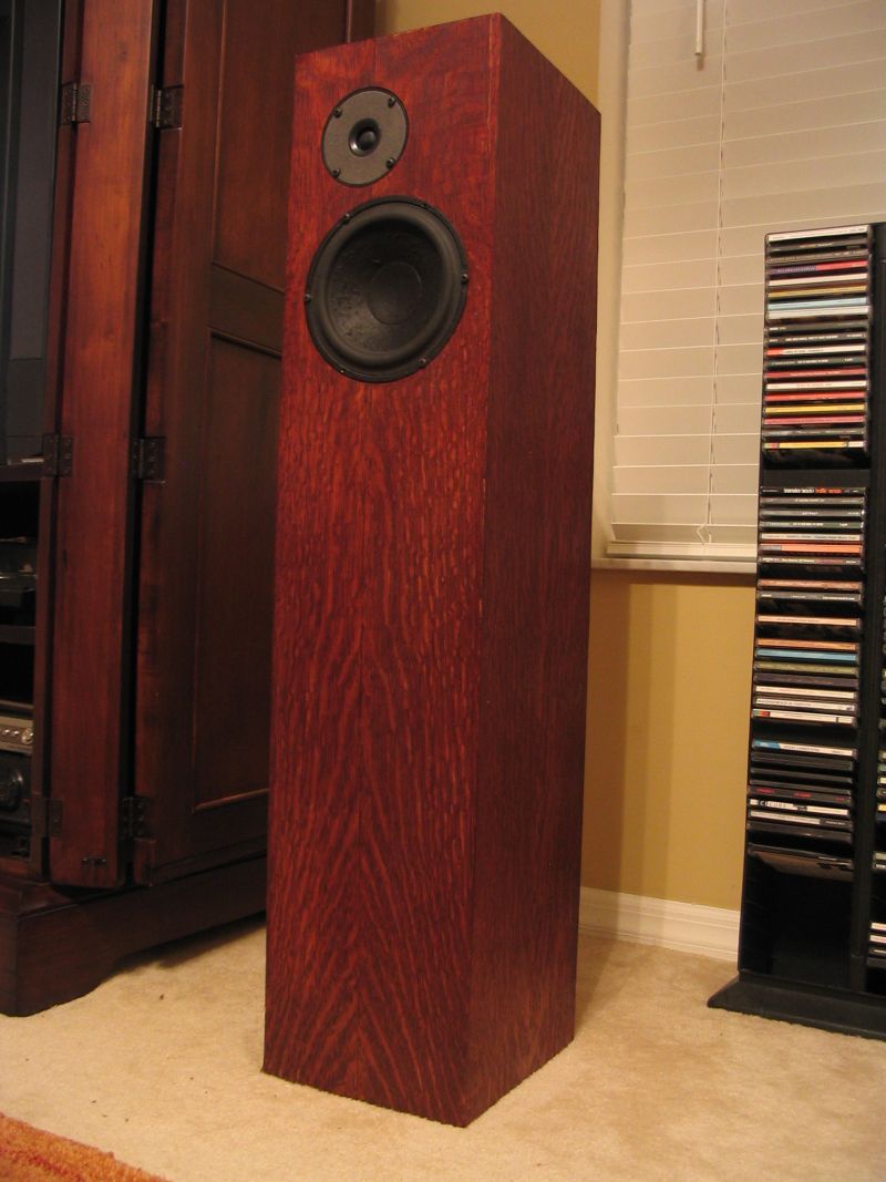

tktran said:very nice!
what type of veneer and finish did you use?
enjoy your work and please post some comments about the sound sometime.
Thanks! Getting the finish remotely close to what I wanted took some effort. The veneer is quartersawn white oak that I purchased from Constantines' Wood Center. (www.constantines.com) The finish took several steps. Basically:
1) water based dye stain
2) shellac to seal the smallest pores
3) oil based pigment stain to fill the big pores
4) shellac
For more detail: First, water dye stain in cherry red. Then a coat of Zissner's Bullseye amber shellac thinned to a 1 lb cut. Then burnt sienna oil stain wiped on and then off immediately (just to fill the wood pores with a dark color). I made this stain from 1 part Ronan Japan Color, 2 parts boiled linseed oil and 8 parts mineral spirits. Then another couple of coats of full strength (3 lb) shellac.
I was really aiming for a mission style look, but using the cherry color was a little too red... I probably should have watered the dye stain down to 1/4 strength and used orange shellac.
As for the sound, well... Its been well described by others on line.... Though, I think I am having some sort of slight dip between 50 and 100Hz... (though I haven't measured it... Im guessing at the frequencies) I think I have seen others online that had the same results... I guess it is either room suckout or I and some others have made the same mistake in our building of the speakers... It might be the room itself... I have them in a pretty huge room.
I had built the original chinese design crossover as well, and actually got to liking the extra bump in the 2k region. In the end, I wound up using the basic Jacq+Troel crossover.

Well, I got my 2.5 clone finished a few weeks ago. Cosmetic results were stunning. I had a cabinet maker build the boxes for me, and I veneered them with Yew veneer. The finish is absolutely stunning. But...
The sound was a disappointment. The bass - astonishing. Lateral imaging - wide and precise. Depth imaging - wonderful. Highs - sweet as honey. The problem was the sibilance that drove me mad. I found myself particularly sensitive to it and it drove me mad; as another poster put it, it resulted in a love-hate relationship with these speakers.
I tried different equipment, but that had no effect. My design, incidentally, was with the original 8513 tweeter and the Jacq modded crossover from Al.M's site. I remembered the mention of Troels' notch filter, and when I went back to Al's site, it was removed and replaced with a single resistor. I found the original notch filter in Troels' paper, and experimented with that and the single resistor.
It would seem that the single resistor has solved the problem. I no longer find myself wanting to turn the 2.5's off. The top end is still definitely forward and present, but not grating anymore. Now I expect great things as these units break in.
In the future I may try the various iterations of Troels' crossovers, but for now I think I am going to stick as close to the original as possible.
Thanks to everyone who participated in the discussions...the information on this site and the other aforementioned sites is invaluble to the builder of these speakers.
