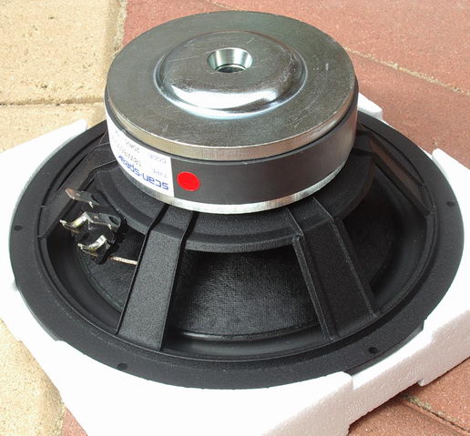

I came across the Scanspeak Reference Plus http://www.audiocomponents.nl/ after 4 weeks of searching late last yr.
The design and driver choice grabbed my attention immediately.
Was a difficult project due to the slanting/angled box, but the drivers recommended were the best from Scanspeak. Revelator 9900 tweeter, plus 8545, 8546 for mid & bass.
Completed the speaker at around A$1800 (US$1400). Parts from Parts Express (US) and WES Comp (Aust).
The music from the Scanspeak Refplus is miles above Poac 2.5. It sounds more like the Sonus Faber Cremona, (at A$18,000).......for a mere A$1800 outlay plus 2 weekends in the garage.
My advise for Proac2.5 DIYer is to move on, and save yourself the aggro . The Scanspeak Ref is the best kept secret, Put the 3-way Proac 3.8 and DIY Scanspeak side by side, and the Proac 3.8 will lose out big time even before the Scanspeak ref has time run in.

Bass: Scanspeak 8545 - Deep & tight, but much better extension than 8535 in Proac.

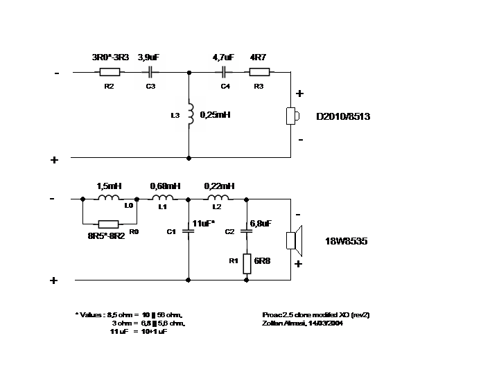

After reading elsewhere about preference for the Chinese XO, I built another and spent a few days comparing it to V6.1 (note that my speaks have modded drive units as per Troels' recommendations).
I can certainly understand why some people prefer the Chinese XO - it is quite a bit livelier and faster sounding with more apparent detail. In comparison V6.1 is fuller sounding and more coherent through the midrange. As I said before though, it does lack some "air" and is perhaps a bit unexciting sounding. If I had to choose only one it would certainly be V6.1 because female vocalists are an uncomfortable experience when the warp factor is increased a bit.
Anyway, I wanted the best of both worlds so I analysed the response of the various crossovers and investigated the box tuning a bit more, with the following conclusions:
1) The box is too small for the SS 8535 resulting in about 3dB boost to the bass at 60Hz.
2) Proac deliberately designed 3 or 4 dB of boost at 2KHz into the XO.
3) Troels' treble XO has relatively less high freqs (above 6KHz) than the Chinese XO.
All we can do about 1) is too increase the port length a bit and tweak the box stuffing - giving a bit more of an EBS alignment.
2) I believe Troels reduced the mids level too much (my speaks measure with a 3 dB dip at 3KHz as well - both XOs). The 47R resistor in \\ with the 1.5mH inductor helps to damp the 2KHz peak but Troels idea to put 3R3 or so in series with the bass inductor is a better way to do this.
By increasing the mid and treble energy a bit the bass seems to tighten up and become more tuneful.
In summary here is my suggestion to get a response (and sound)half way between the Chinese and v6.1 XOs:
Starting with the Chinese XO...
Remove the 47R across the 1.5mH choke
Change the 8.5uF cap to 6.8uF (I actually used 6.9uF)
Add 3.9R (I actually used 3.3R) in series with the 6.8uF cap
No changes to the treble XO - make sure the 47R is across the inductor not the tweeter.
I have yet to measure the changes and do fine tweaking on the freq and phase response but listening tests so far have been favourable - IMHO it is undoubtedly better than the Chinese XO and I think it may well be better than V6.1.

I have played a lot with various crossovers, including the original XO and Troels mods. None of them really satisfied me, so started to tweakening a new layout.
The idea is coming from Loudspeaker Lab 2, so that I use two different coils in series for the baffle step compensation and for the first coil in the LP filter. For the first sight it might look a bit complicated or non-sense but works for me.
I think with this XO the midrange is considerably better and the sound lacks the boxy sound which sometimes characterize the clone.
The best thing of all that you can set the BS step compensation very easily, by changing the resistor value only. I haven't heard this mod on other clones, so some feedback would be welcome.
There are some minor mod in the HP section as well. This is to flatten the 8513 raising response and also changes the slope a bit.
Please feel free to try and comment.
Zozo
Zozo
