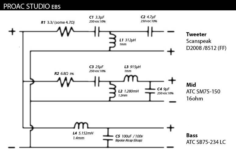

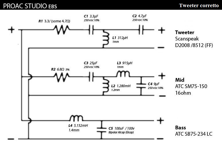

Original Proac crossover for 15 ohm unit:

Jeff Bagby seemed to think you need to take care of the mids enormous Fs, with a parallel resistor. There is also some unpleasant looking breakup on the waterfall around 4.5kHz, so the resistor might help there too. The Volt 752 is remarkably similar to the 9 ohm ATC unit.
Wilmslow Audio did something similar:
It's a long time ago, but I was unconvinced you need to do much to the crossover at all when changing drivers to the 9 ohm version. But best to sim it. It might just be that the Monitor balance is a bit too flat for domestic use.

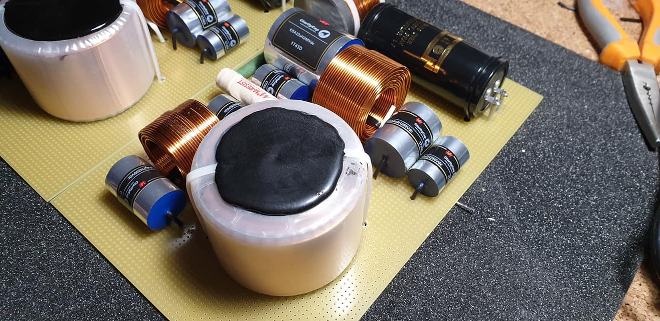

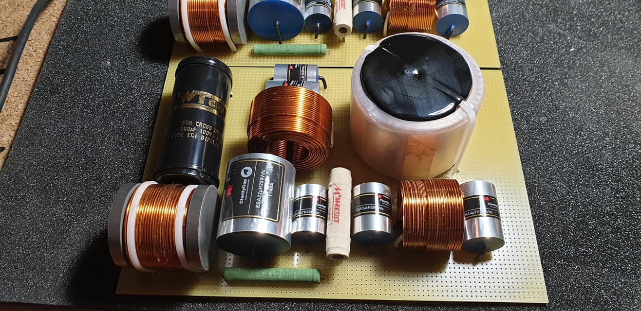

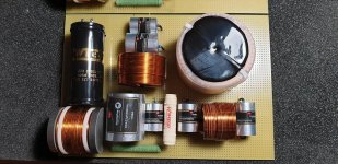

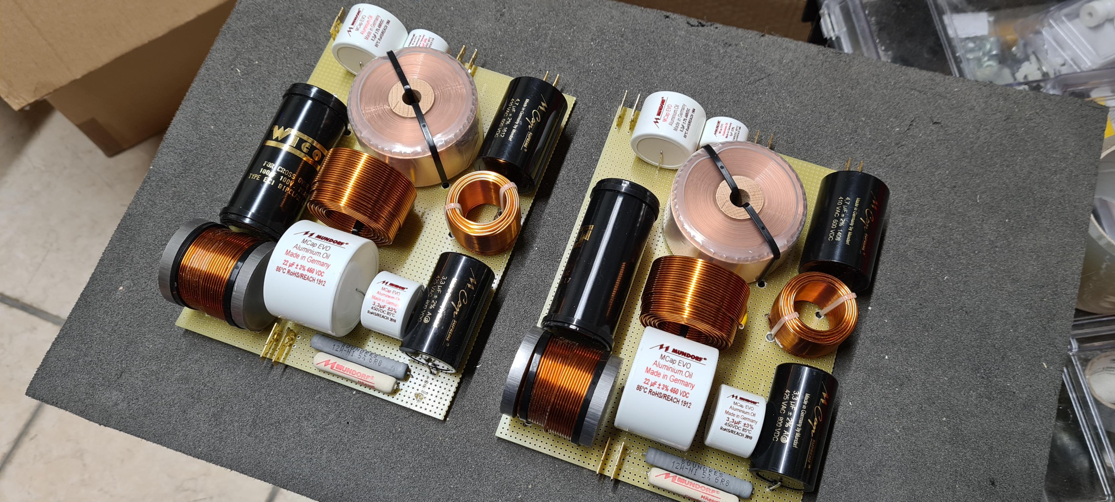

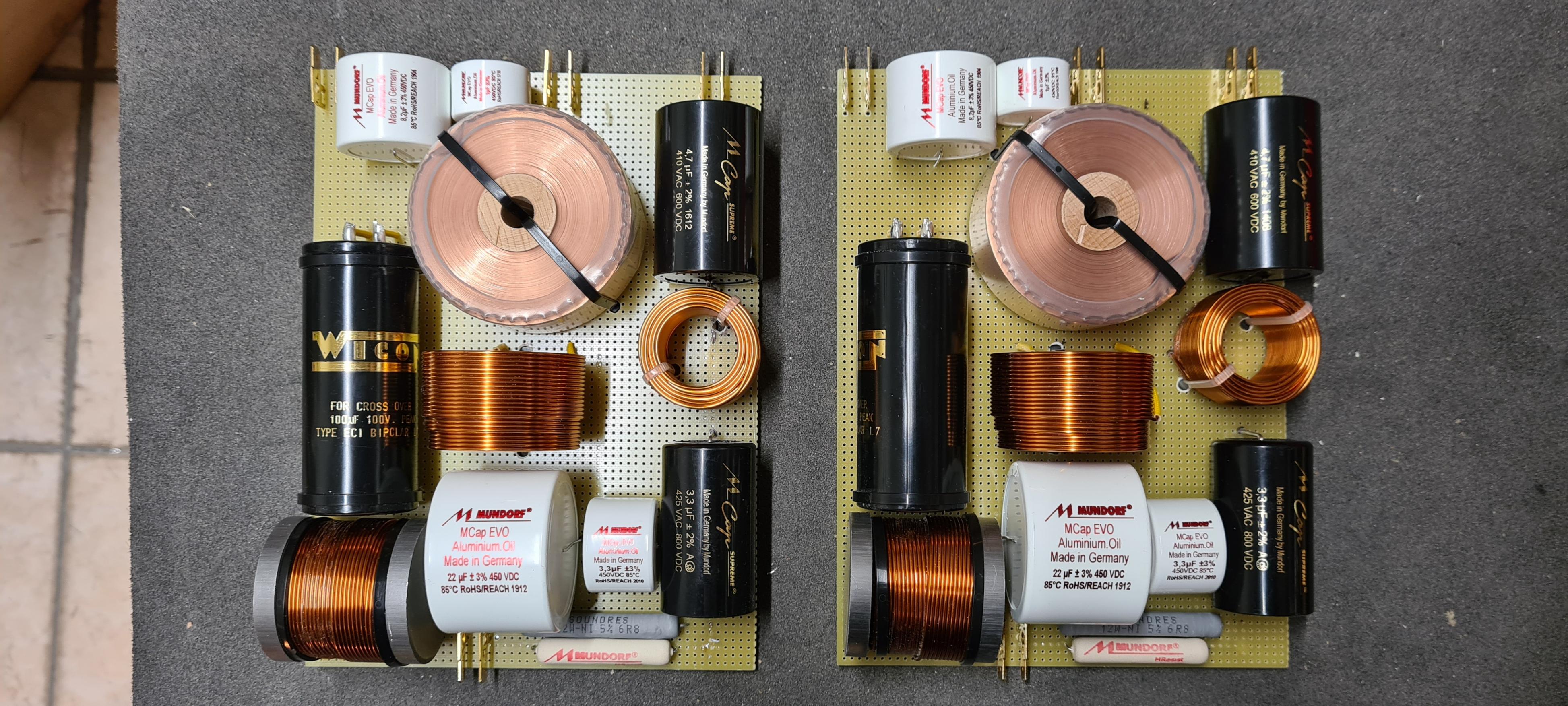

this is my version of the upgrade I made for a dear friend!!!
capacitors clarity ESA cap 250V and Wicon (for me the best electrolitic capacitors ever made)
Coil by jantzen and mundorf resistors
(25uf= 22uf+2,7uf / 9uf= 6,8uf + 2,2uf)
after assembly I checked the frequency response with the clio system
the correct tweeter polarity is that in the diagram
the sound has improved a lot (in my opinion) both on the details and on the articulation

Still wondering about the polarity of the drivers , some schematics show midrange reversed, others not.

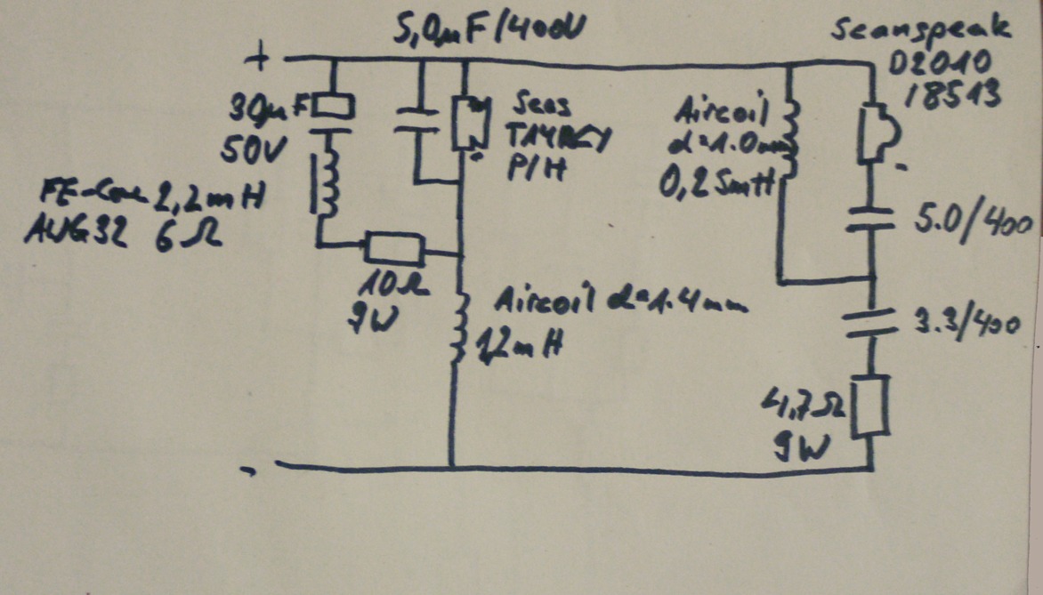

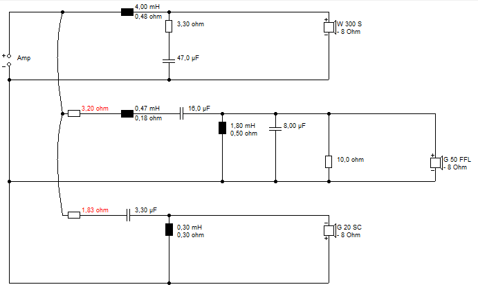

Hi everybody. i'm Newbie. Could you please help me the details schematic of Response 1s crossover ?
I have bought a pair of used response 1s but i suspect the previous user had changed the component value. I want to restore the original value of component to see what different.
Thankyou all
Thankyou all

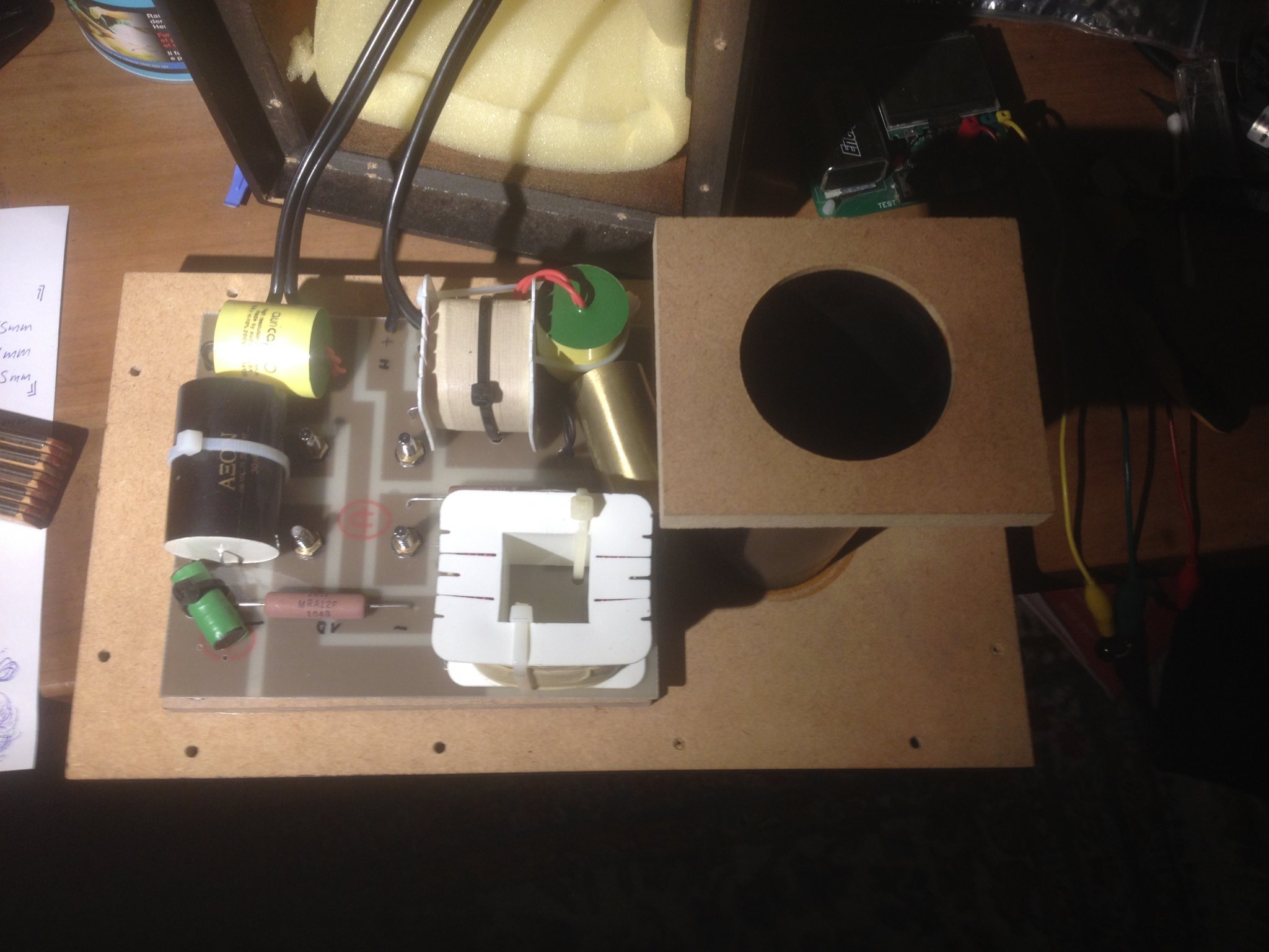

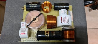

i've changed Caps from solen MKP to Auricap & new resistors from Dale. The Hi Z-Filter C (30uf) is original AL type for crossovers, not a huge black one like here. The Wire for the Ferrite core is 0.18mm diameter

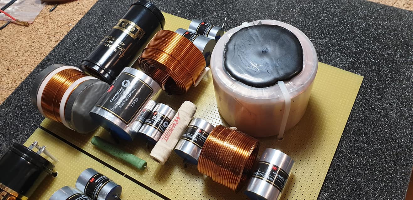

What about this Wicon caps can't find them anyware.. what about some help with some help upgrading the crossover on ProAc 1sc can you help with that ?
