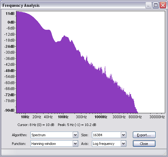

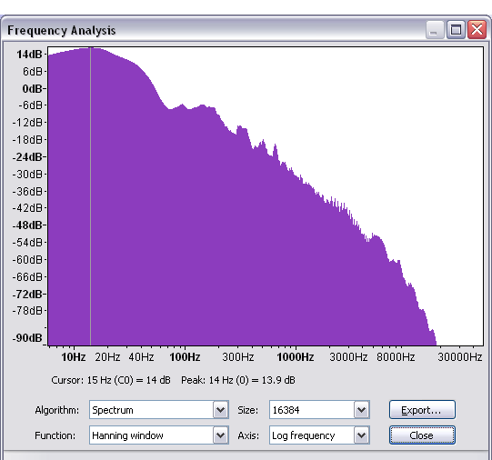

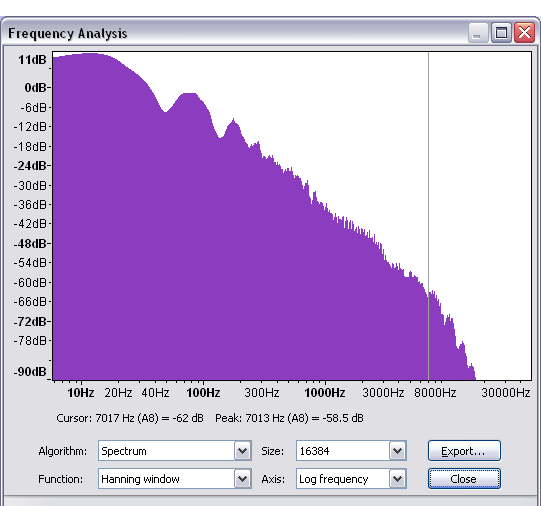

OK, regarding Borat's Lady Gaga track:
The LF noise is from the original tracking (recording). It's not present right through the track. Most obviously, it's not present for the first few seconds until the vocals and second synth comes in. There's also a spot at about 1:05 where there is only vocals and synth, where the noise is present, and several short spots later on where it is not present. I would hazard a guess that there are two synth tracks in the mix, and the second one is the one with the LF noise present on it. It's not harmonically related to the music, so it's just plain "rumble". It'll make cones move visibly but not make any effective noise. As for actual musical content, there is nothing below 35 Hz.
For an example of a track where the musical content goes all the way down to 10 or 11 Hz, check out the WaxAudio mashup I mentioned earlier.
For something a little more organic, try "O Varium Fortune", by Corvus Corax, from the "Cantus Buranus II" album. (There are videos on Youtube, but the sound is not good.) As well as huge bass drums about 1.5 metres in diameter, there is a synth sub-bass in the low to mid 20 Hz range that adds real weight to the music.
Or if you have a fairly good home theatre system, one that can do over 120 dB flat down to 15 Hz, go to Audio CD Mastering, Mixing & Replication, navigate to Media --> Downloads --> General. Grab the "Launch At Dawn" video.
And if you have a really good system, one that can do over 125 dB flat down to 5 Hz, open an account and download the 24-bit 96 KHz 4 channel audio-only version, without the music. This is so clean and open that you won't think it very impressive unless your system really is as good as I said. I'm deadly serious - you will not get the full effect unless your system is capable of sucking the breath from your lungs and making the doors to the room flap back and forth by several inches. This is TRW sub territory.
See the attachments for some spectrum analysis samples:
