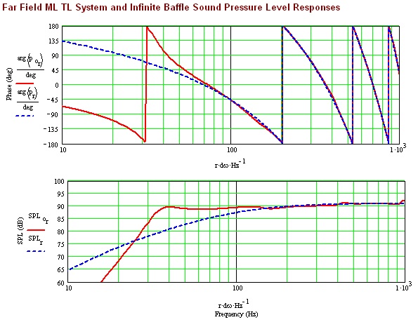

From my experience, they don't always show on the frequency response, only the big ones does. The smaller ones that smear the sound are not easy to spot on a frequency spectrum, and they are often only visible when you really measure them.
I measure with a Umik1 at the listening seat. I use REW on the left and right channels separately, then playing together. Applying auto-EQ adds about a dozen filters from 20 to 100 Hz. I add one custom filter at 25Hz and a house curve. There's no way I could get this kind of accuracy without auto-EQ.

And box alignment also, sealed has the lowest group delay, then TL types, then BR and then horns. But sealed are hard to get real low in frequency.
But an amp won't make the difference, it's the driver(motor) and the enclosure who do that. Plate amps or pro amps won't make a difference on that.
