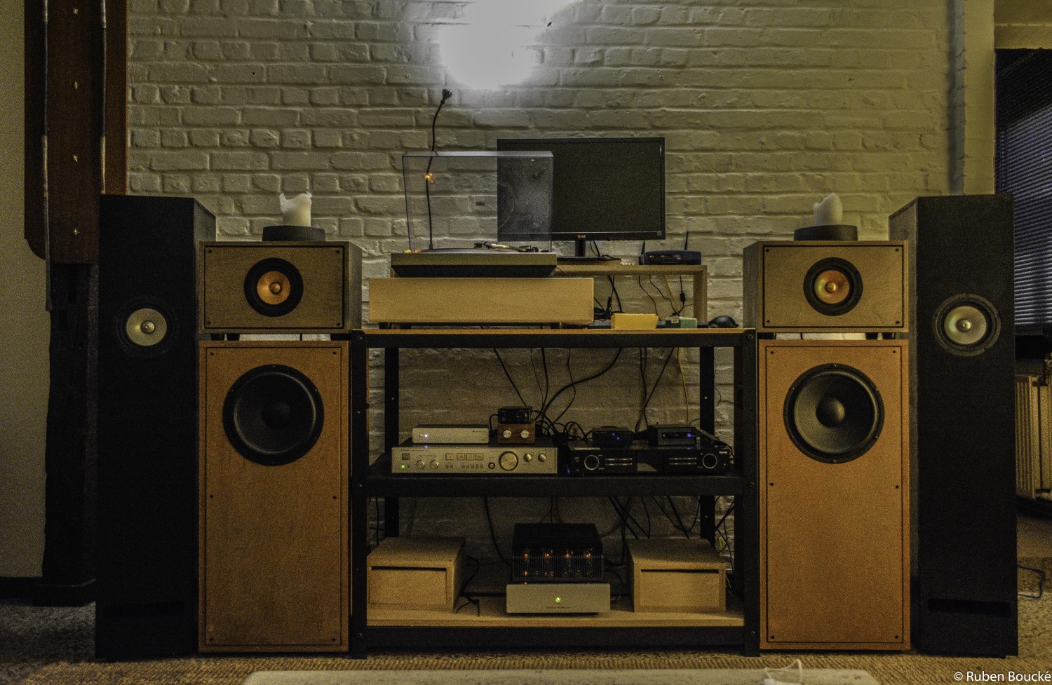

My speakers are Bamberg Audio S5-MTM sealed standmounts, each containing a pair of SEAS Excel 6.5" magnesium drivers. They are not stressed running at the highest levels I use, so the level gains from filtering the lows are not a worthwhile compromise.
I must admit I have never experimented with time delay. There's no way I would run the main speakers through the miniDSP 2x4, it is most definitely not good enough. I came very close to buying one of their SHD models. The Studio version is a temptation, but still a risk given my previous experiences. Time delay of the miniDSP 2x4 is specified as only 2ms, not sure about the plate amps. Is time alignment really that significant? Seems to be dismissed as unimportant by some.

Well, that is an opinion, many experience different. I did sell most of my multiway systems for a fullrange MLTL and a 2 way waw system with a fullrange driver and a woofer (see picture) and those do all i need for me. But i use very engineered drivers (Mark Audio) where the shallow cone gives a good dispertion and with enough xmax to give real bass. My MLTL (the black one) goes from 20kHz to 32Hz flat within 10dB with a 6" driver, but it does not go very loud (still hits 100dB, but not more) and is not perfectly flat in response (which is the compromise).
But if you're after a perfect flat response and a very controlled dispertion or want high volume, it's much easier to do it with a multiway. But all systems are compromises, and it's a personal choice which factors are more important for you. So if you prefer multi way, buy/make those.
And Troels is a very good designer, but no the almighty know-it-all in speaker building. His philosphy is also based on his preferences, which are subjective. I do read his stuff and learn a lot from it, just like i also learn from other people (Toole, Martin King, Linkwitz, ...) but don't take their view as the absolute undisputed truth in audio.
