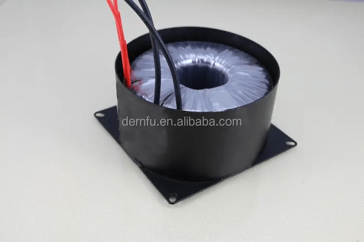

The transformer will not alter any hum or buzz from the speaker, it will only affect physical noise from the transformer itself and tbh you have no actual guarantee that the new one would be any quieter.
To improve the transformer situation noise-wise you can try to add more soft rubber on both sides of the fixture
or mount them inside dedicated potting items. A "dc filter", described elsewhere in the forum, can also help.

I am not sure I understand you reply properly, but adding more rubber
or other suitable soft material to the transformer mounting is always a
good idea. Most of the time only one thin layer of rubber is used, this
can lead to other problems also, see here :

Pictures of A20 inside clearly show a standard poor way of mounting the
heavy transformers.
