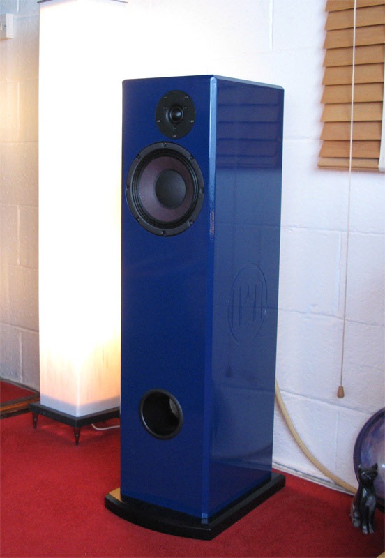

Pi One , Eminence Alpha 8A & Vifa DX25
https://www.pispeakers.com/catalog/product_info.php/products_id/34
https://www.pispeakers.com/Measurements/onePi.html
https://web.archive.org/web/20171223233616/http://www.iol.ie/~waltonaudio/pione.html
