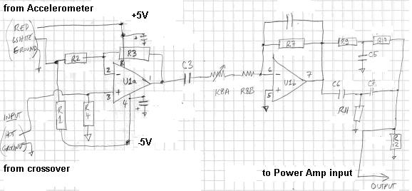

>@bwaslo: could you sketch your filter topology, please?
Sorry to take so long getting this on the board, I was out of town and didn't have any files with me (other than a few plots on my laptop).
Here is a sketch of the topology (sorry for the crummy drawing). I took the parts values off, as I don't know how AudioXpress would feel about me giving out the design before they publish it. But you can see what is happening from the topology, I think. Notice that the ACH-01 accelerometer output is inverted, so its signal gets fed back in-phase (to the inverting input of the summing stage, and then inverted again by the leaky integrator stage). R8A gives an adjustment for the loop gain. R9, 10, 11 and C5,6,7 make up the Twin-T notch (and when loaded by R12, there is a relative high frequency boost from the notch, which gives a phase lead). You can calculate the Twin-T notch frequency to take out any peaks in your loop, using the formula at
www.radio-electronics.com/info/circuits/rc_notch_filter/twin_t_notch_filter.php
>Bwaslo how much feedback can you achieve without oscillation?
For the article design, I'm using about 10dB feedback (at ~70Hz, the highest point in the "raw" response), leaving 8dB or more of gain margin over the full range. The feedback is at about 0dB at 20Hz, and phase shift is what kicks the response up below that frequency, from slight peaking. I could use more feedback, but the peaking starts to look ugly and scary if taken too far, and I wanted to keep it moderate for the article.
I've done another in which I had stiffened the cone and dust cap with a coat of epoxy (to move the resonance to above 1200Hz) and was able to use about 15dB of feedback, without visible peaking, with that one. But that approach will only work if you can measure the resonance and custom tune the notch for it, since I doubt the resonance shift would be very repeatable from smearing some uncontrolled thickness of epoxy on the cone.

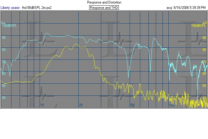

Redone distortion plots, at long last
I finally got a chance to rerun the distortion measurements on the servo-d Sub120. This is the design that will be published in AudioXpress.
I set the sub up in my listening room, about 1 meter from a wall and with the microphone 2 meters away, a meter from the floor and toward the center of the room. That's a pretty typical listening distance for small rooms. Then made measurements at various drive levels.
Here is the series of fundamental sweeps, to show how the output compresses. You can see the room lift along with the usual modes and nulls. The design has a highpass filter at about 16Hz, but the response is still strong below that in this case because of the room. The input drive at lower frequencies is rolling off fast, so you can see that the compression lets up below about 10Hz -- the output there is mostly being peaked by the room. Which would be advantageous if I had any CDs with actual content that low!

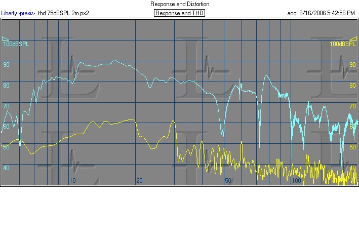

Servo'd Sub120 Distortion Plots, cont'd
Here is the fundamental (top trace) and summed harmonic distortion components (lower trace) for the highest level sweep at which the woofer still was moving linearly at all frequencies.
This shows the difference in levels between fundamental (only) and all distortion components below 12th order. The measurement method (log-swept sine) is able to measure fundamental level by itself.
To get to %THD, if you need those values, take the difference between the fundamental and the distortions at any frequency and level, call it "D", (a positive value in dB). From that calculate the fractional equivalent "E", as : 10^(-dB/20). Then the percent distortion is
%distortion = 100*E/(1+E).

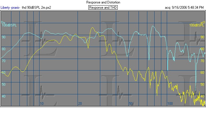

Servo'd Sub120 Distortion Plots, last one
Here is with 10dB more drive. 90dBSPL is pretty much all there is below 45Hz. But this seems to be quite adequate for music listening (for me anyway...but I don't go for rock concert levels).
