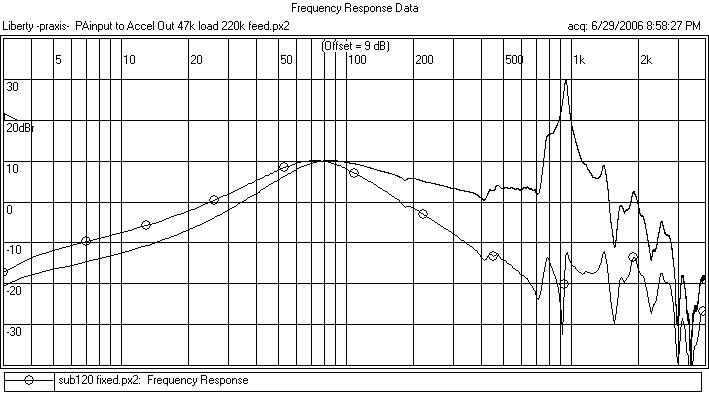

The 800Hz oscillation is because of the cone breakup resonance. I did a similar MFB sub (but using an AHC-01 accelerometer) and there was a huge peak in the woofer/accelerometer response at around the same frequency. I measured loop gain, and without EQing, that was the highest gain point and the phase moved fast through there, just about guaranteeing oscillation.
What I did to fix it (and what may work for you) is to put a passive Twin-T notch network, tuned to 800Hz, in the feedback path. With an integrator in the loop there was a region between about 300Hz and 700Hz where gain was reasonably far down, so the phase shift from the Twin-T sitting at a little higher in frequency didn't cause a stability problem. I also loaded the Twin-T with a smallish resistor (compared to the resistors in the T itself), which gave a bit of phase lead, so the notch ended up not hurting the phase much at all.

Here is a plot of the loop responses before and after filtering.
The trace marked by circles is the "after" (gains offset for comparison).
The "before" is what comes out of the accelerometer when driving the amplifier directly. The "after" is what comes out of the accelerometer when driving into the filter circuit where the accelerometer will connect when the loop is closed.

The peak in FR at 1kHz looks to me like the resonance of the mechanical system consisting of the dustcap/accelerometer's mass .
Could be. The sensor is glued to the dustcap (which is inverted). I figured the cone was flexing where the cap bonded to it, pretty far up from the voice coil.

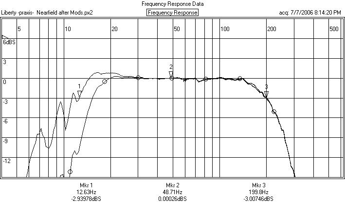

I only made a cursory look at THD, it's about 1% (at 90dBSPL two feet) away down to about 30Hz, then climbs from 30Hz down till it is about 15% at 20Hz. Not amazing, but pretty good for under $200.

The original B&M used the same mic position as this Manger sub does:
http://www.manger-msw.de/images/produkt_abb/icon_subsonice_2_kl.jpg
It wouldn't be bad if bobo101 did a sweep of the driver-mic response as well. One doesn't have to be scared of phase-shift introduced by EQ networks if they really represent the complementary of an error with minimum-phase properties.
