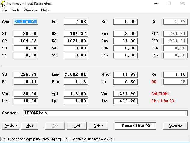

Those are excellent results. How did you get a bandpass injection to be so flat?
Just play with hornresp, i am better in these then akabak.
a pity hornresp has no tractrix, but with bass the exp is oke for testing.

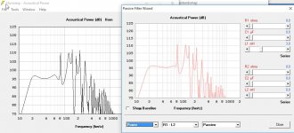

play with the wizart and look at the thickness of the wood, in my case it was 1.8 cm I have use 12 cm wide port devide to 2 in hornresp to get total surface but it is not critical, go smaller als works until to much compression occurs, some damping on the wood under the cone can help also.
wtih two woofers I get a dip, I can flatten it but woofer get to close to mouth giving problems. but the rising peak at 300 hz is not a problem, easy to flatten with a 6 dB lowpass filter and together with the natural low pass of the port we get nice respons. see pictures.
beware, the phillips are quite high in qts so the coil act different with power qts types. (better)

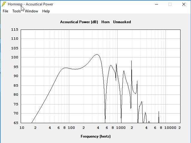

This you need to ask hornresp, I have fill in the ports as in your script 12 cm to cm2, and the thickness of the wood the woofers is on. And filtering because without it do as akabak, give a peak on 300 Hz, but this can be changed with moving the woofer back and forth in the horn, however when get a good respons the woofers are to close to the mouth, so I move back, happely a single coil do flatten it, like I did see in a tapped horn what I did sim.
You now get the woofer more close to the throat there is some loading of the woofer giving more spl, but it has to be play with.
Do now I am green behind my ears with speakers, because I do just play with it a year or two.
Do you devide the ports for the woofers? hornresp do use one port in sim of all the ports together with 2 woofers so it are small ports 2 each woofer.

I am not good at HR so not the right person to ask. The second one looks more like what I expect with a bandpass woofer injection into a horn. The peak is there and the sharp cutoff dip.

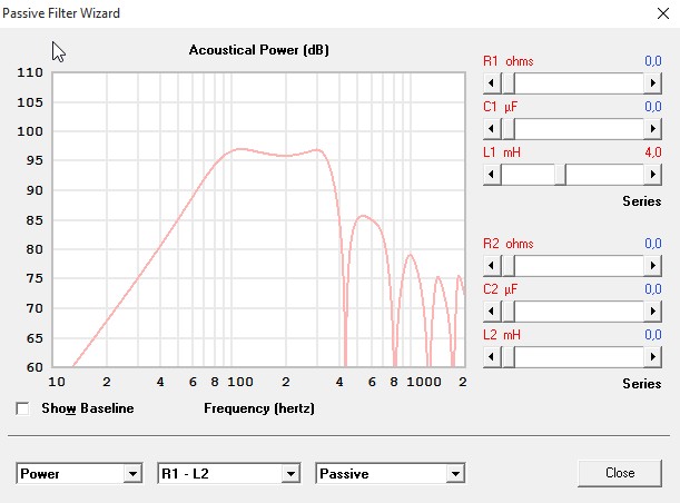

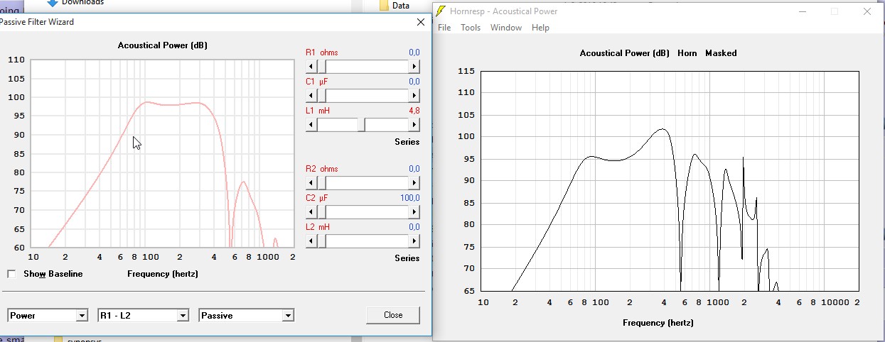

X your right, it looks like your script, however I can flatten it nicely out with a passive filter in hornresp, see first picture with it, even a single coil does the job, it is not all standard but hee we need new look at this stuff..
The picture you mention is pure without filtering, but I can flatten it by moving the speaker towards the mouth, but it is not complete possible because it it is to close ad the end of the horn, you now what I mean. Also the specs of the speaker play a role, with a low qts I think it can more towards the throat, hornload the speaker also a little, maybe extra reason of the dip also.
I am better with hornresp I did make the tapped horn with it and the dipoles.
See pictures with the only a coil making respons flat, it change the qts..

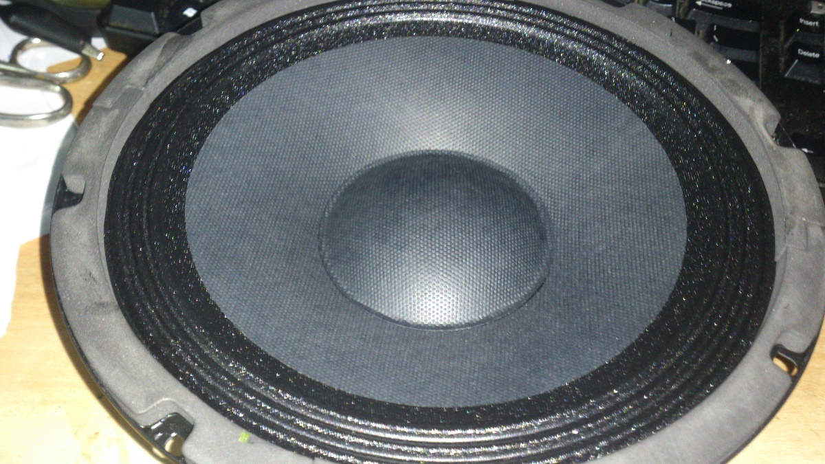

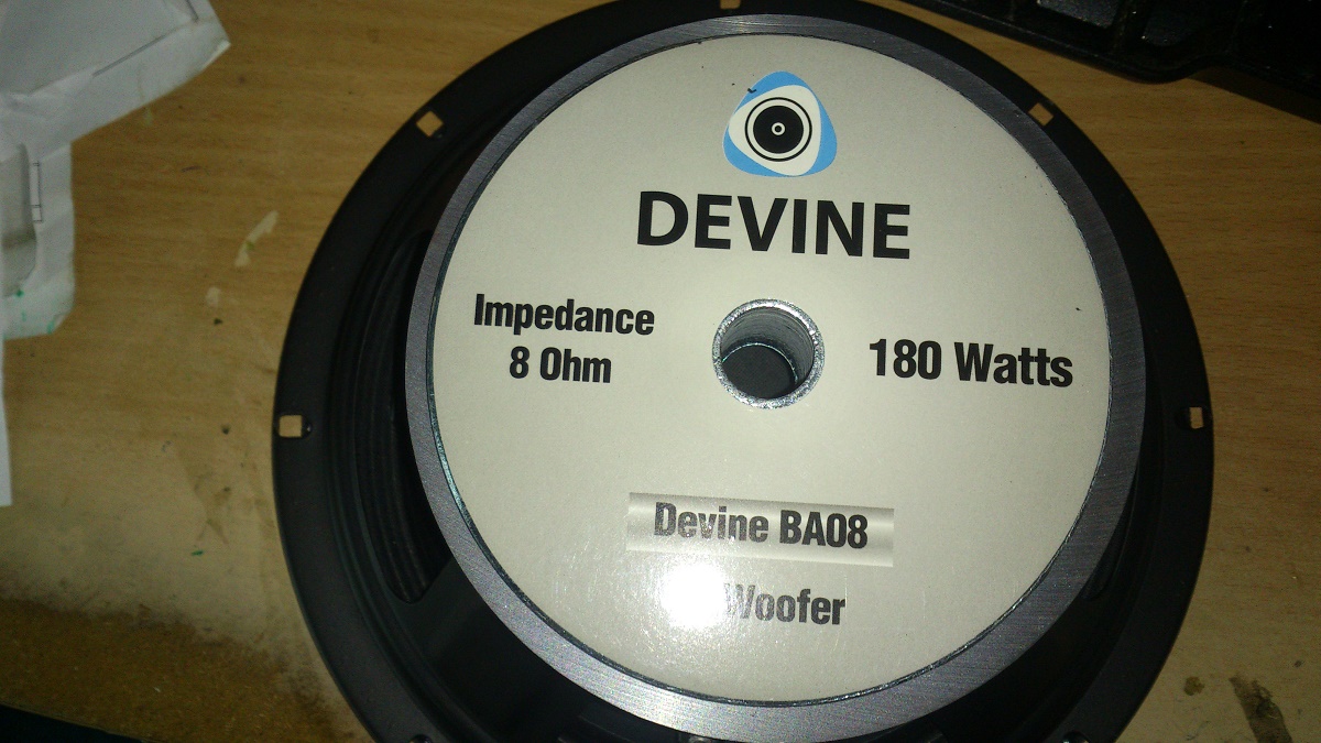

Have received some speakers for the bass part.
I have to measure them for the parameters because I have not.
But has big magnet en clothe surround, I go not lower then 90 hz
so it is oke.

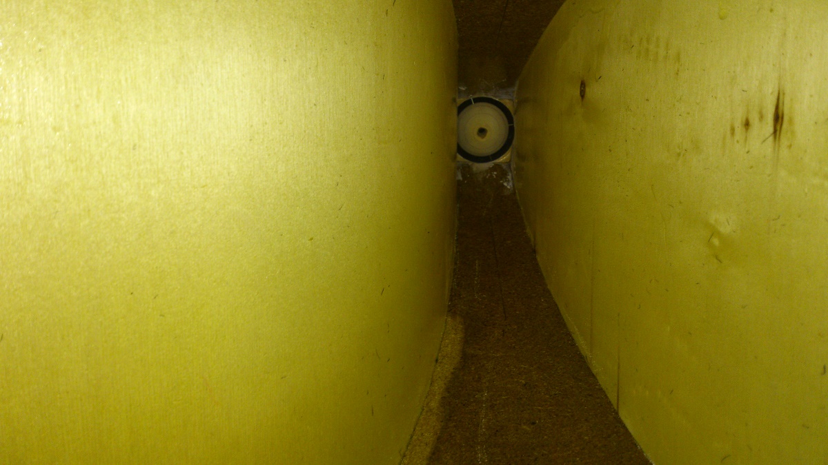

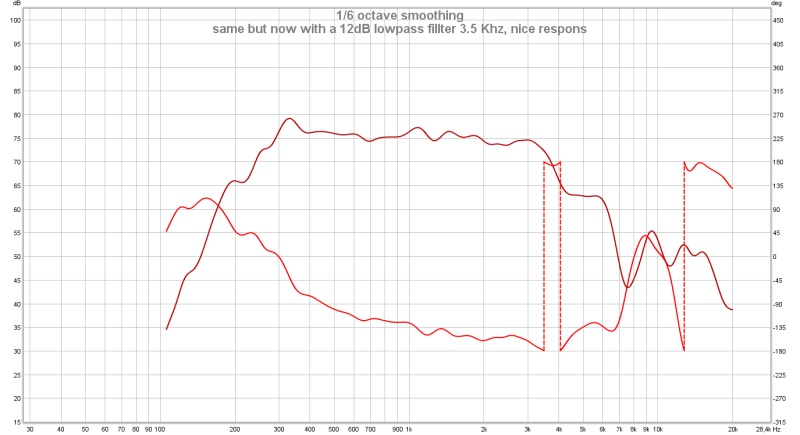

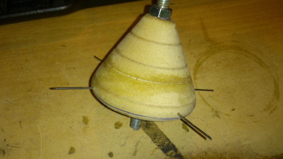

Hi All

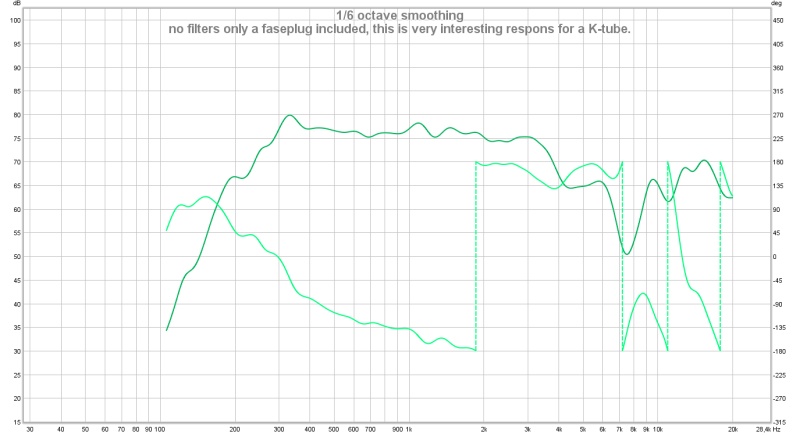

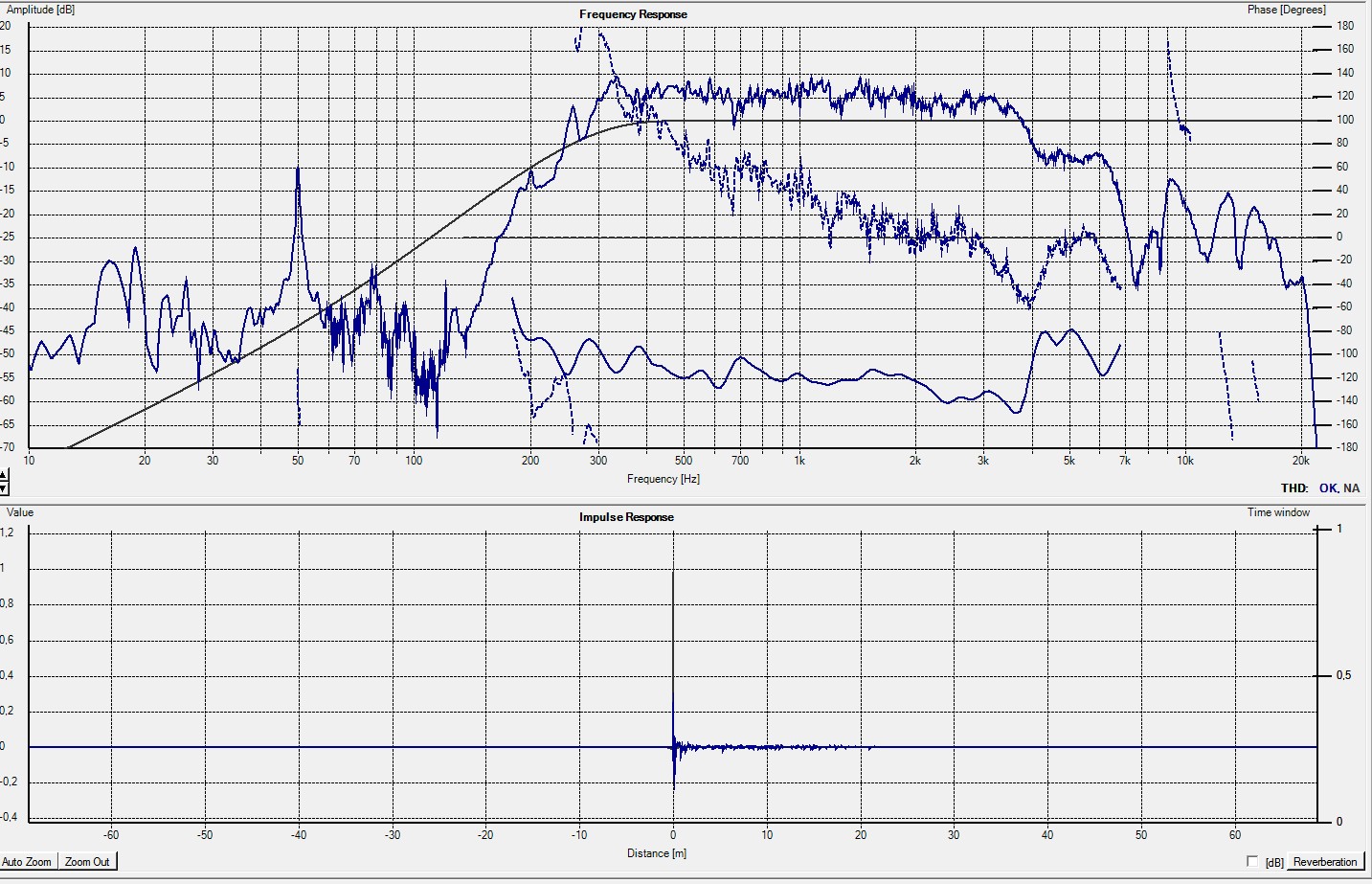

I have now did tests with faseplugs and the respons without filters is very good, and it go very loud, now it extens from 1.2 Khz to above 3.5 Khz making a K-tube easy to implement, but need a compression driver for I think, it is dependid of the bass units. the first holmresp plot has fase and distortion included, you see it is -64dB down.
The bass units ware cheap, 35 euro for two, sounds pretty good in free air, so I go measure them.
See also the raw sim from holmimpuls, as you also see is the 12,dB lowpass do improve the fase, possible because above 3.5 Khz is down now, and interact very little.
Looks like 18 or 24 dB filters do better with horns, and the little bump around 300 hz is because of the small box behind the visaton, but not a problem or i make the box a little bigger.
regards
kees

Nice work with the phase plug. Is the response flat to 3.5k without filters?
No there no filters, straight on the amp ouput, I have now making a more narrow split between speaker and throat, and it go less far, so motor of speaker is truly a factor here, I can go to 4 Khz, that make K-tube more easy.
The new plug now do go to 2.8 Khz, it is 1 Khz less far with a more narrow split around the plug,
regards
I have make smaller split between faseplug and wall, giving not as high as I did get first, maybe because the compression is higher the speaker has to weak motor..

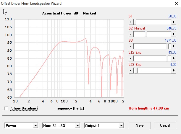

arcgotic
Here are the sims. But as X say, I go analog so need more work to get there, with possible also a K-tube. get the woofer closer to throat do give horn loading but it get not as low I want without loose it again.
The nice plot is with a 12 dB crossover you not see.
