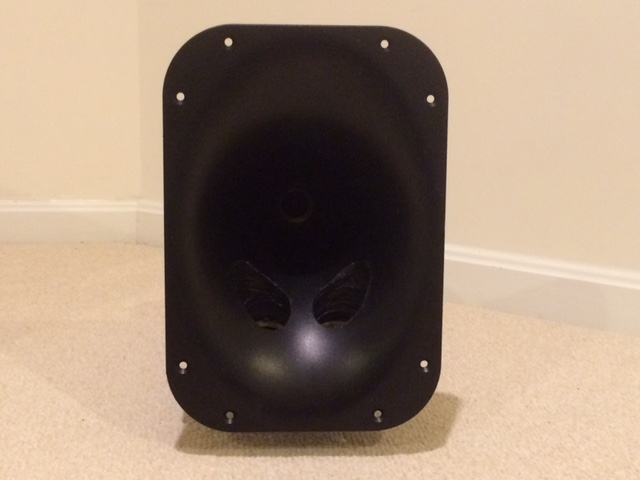

If you don't mind a 3-way design the adding a K tube tweeter like this can work well. It will certainly give more detailed HF output. The physical alignment is excellent and for all intents and purposes remains a summation point source horn.
I think a compression driver on the K tube is overkill and they have higher HD. A 1in dome tweeter with a low distortion motor and damped rear chamber will work nicely. Even a cheap DC28F-8 would be excellent.

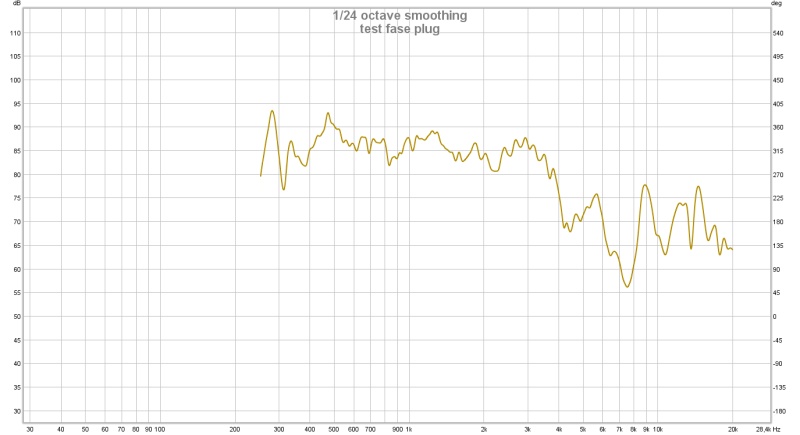

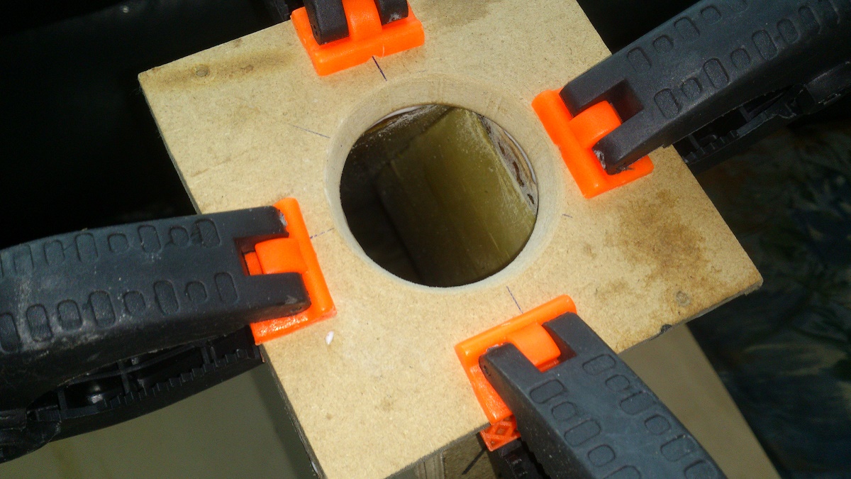

Mking a tangarine faseplug for a normal cone is not easy, it works but you get a lot of IM.
pointy faseplugs with rings however do work to get less peaks and such and extention.

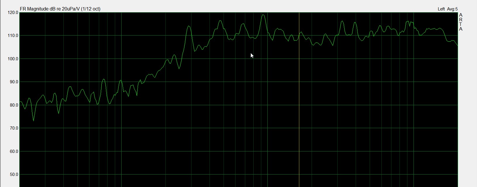

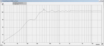

Last picture is with arta and a K-tube tweeter, it go way more loud then a high pass correction.
second picture you see the cone can not keep up with compression, I think a horn in a horn in a horn
is bet best way, but for 80 Hz it is litlle bigger, why I think this is when have the full efficienty of
a horn give the most transparent, detailed and fast sound.
I gp put a K-tube in, maybe some deeper in throat getting fase equal.
see picturs.

I like the results of the K-tube! With correct location you can get a spot on phase match. I might have to try this. What are you using to drive K tube?

I am a little late busy and reading, special with the build of the welding inverter, it do well.

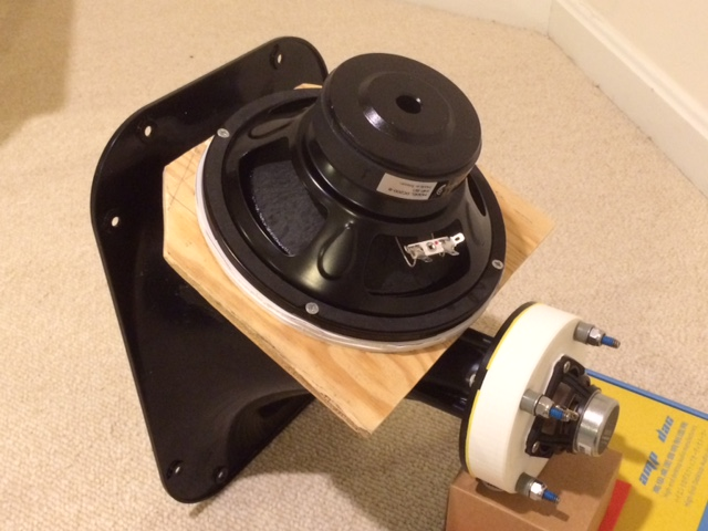

I did see on other threat that a surround damping do work well? just mill some material away under the speaker surround and make a damping ring to fill up again, so it seems the surround is a trouble maker with the dips and cancelations. this is why we need cloth surround speakers for horn and not rubber.'You did make a adaptor and make it round, looks a little as I did to make it round, I go make one with karpet vilt ring.

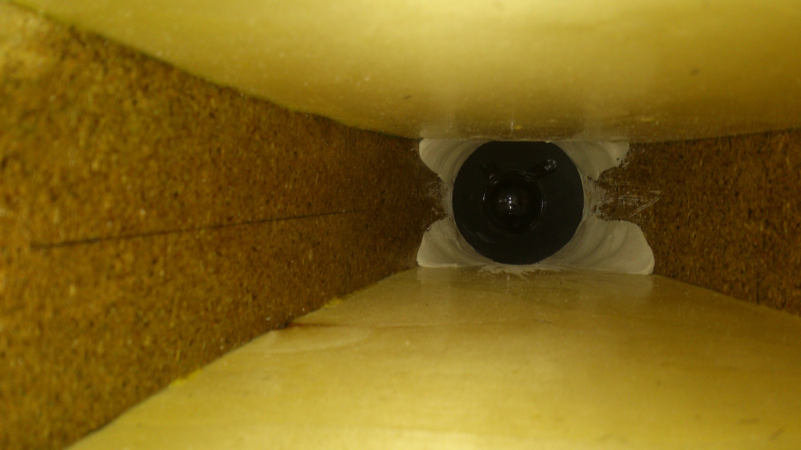

For the K tube, when ik put it deeper in throat and use a 1 inch it work nice I think, and when the voicecoil is in line with the full range it is also in fase, but we can move a lot so find a other fase spot.

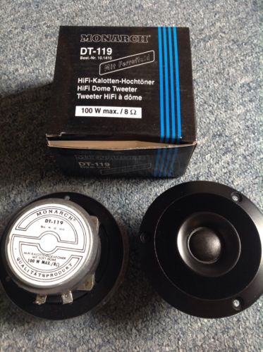

I did use a double magnet monarch dt119 a old one with high sensitivity.
I did think of make a horn with a speaker 8 inch and go from 90 hz to 2 khz and further to a K-tube with compression driver making a high sensitive horn but bigger it is but no need of side woofers.

Maybe that is why I want to try with a K tube tweeter, I did and it sound quite good measuring is less good, but have a really noisy house..
The most problems occur whit path length differences, therefore a phaseplug is used, however when cancel this on hf we need more compression and so hars sound when not done right.

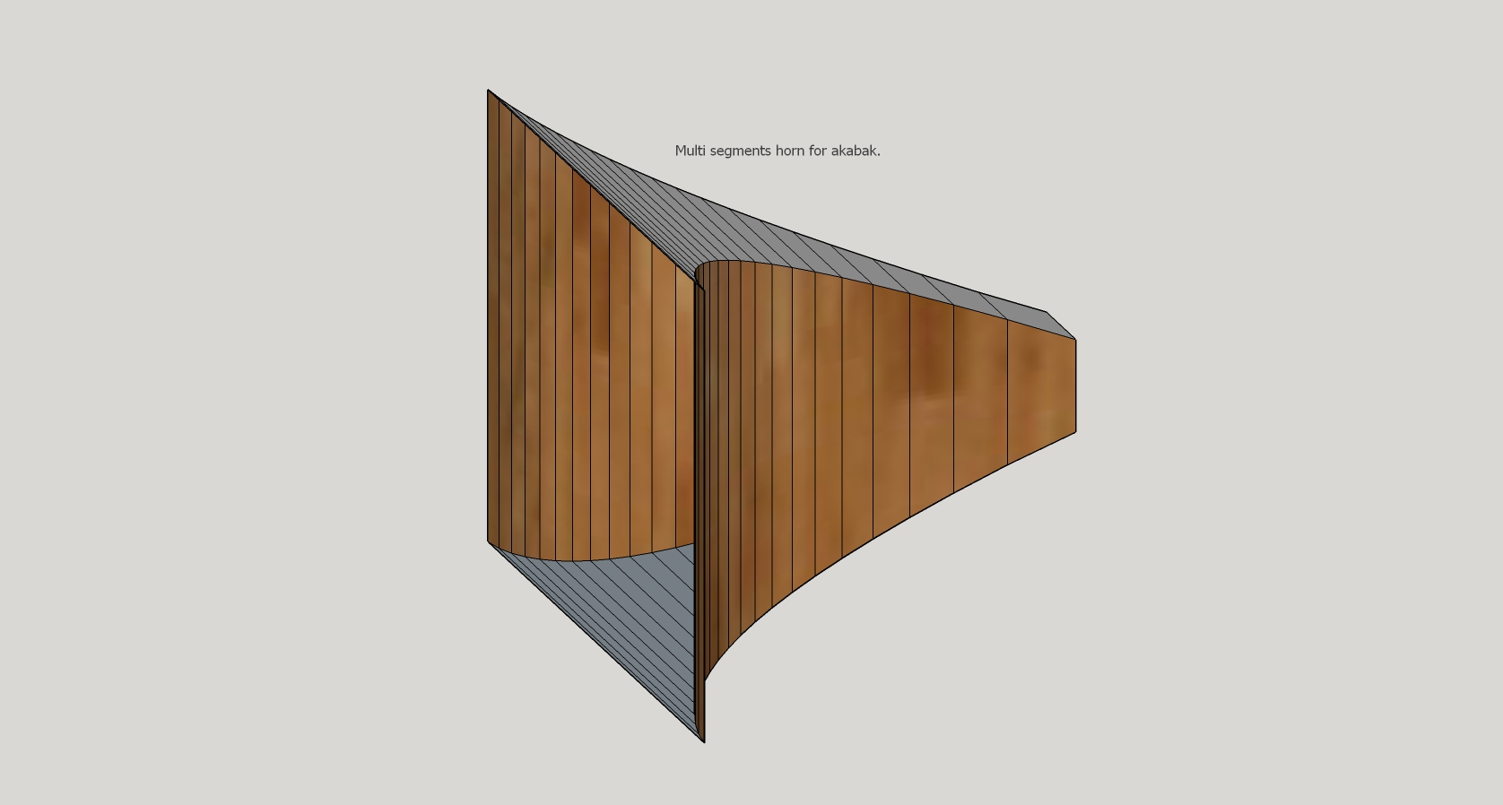

X

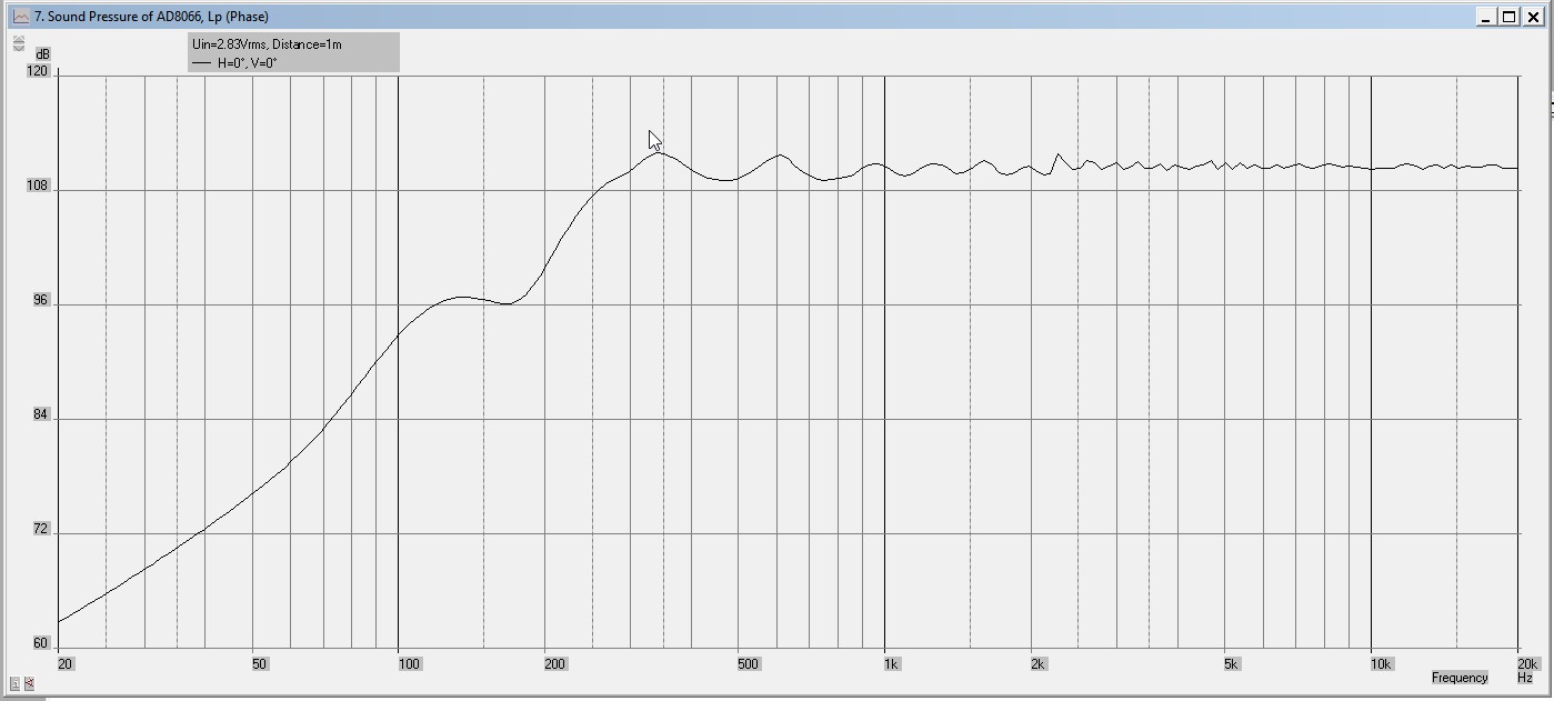

I have done a sim for a 80 hz horn but akabak say it go down on 250 hz, maybe it do not take in account the placing on the wall as 4 pi.
do I have then make a free space horn? then it go bigger.
Also the hf is not real, this is a woofer who stops on 4 Khz, so I need to implement a chamber in akabak.
You can turn on wall boundaries. It's in the script already may just be turned off. All the reflection switches in radiator elements need to be on. Then there is the main wall reflection term that specifies how far floor and wall are away.
Here is a zip, if you want to do a quick look if I have done it right, thanks. Included is volvotreter calc and script.
I have managed to get better plot but not quite compleet oke, I think a corner horn who is not that big is nice for with a K-tube and a tapped horn, then I need a compression driver for high..
Reflection switches? I did see reflection there but not seen a OFF.

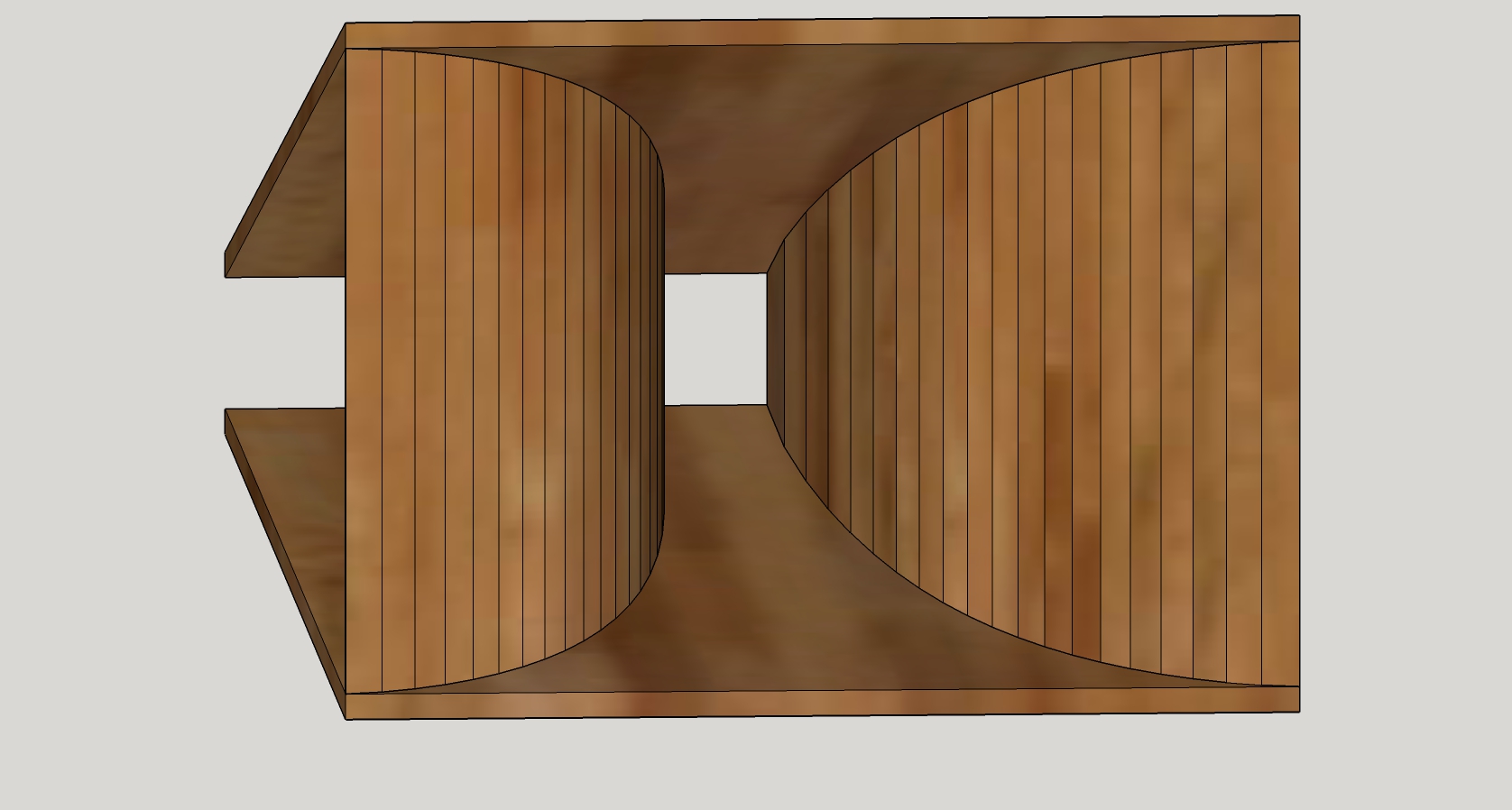

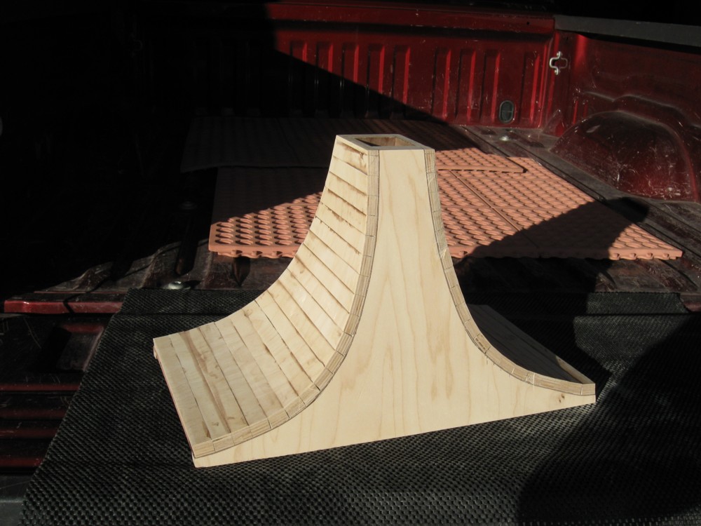

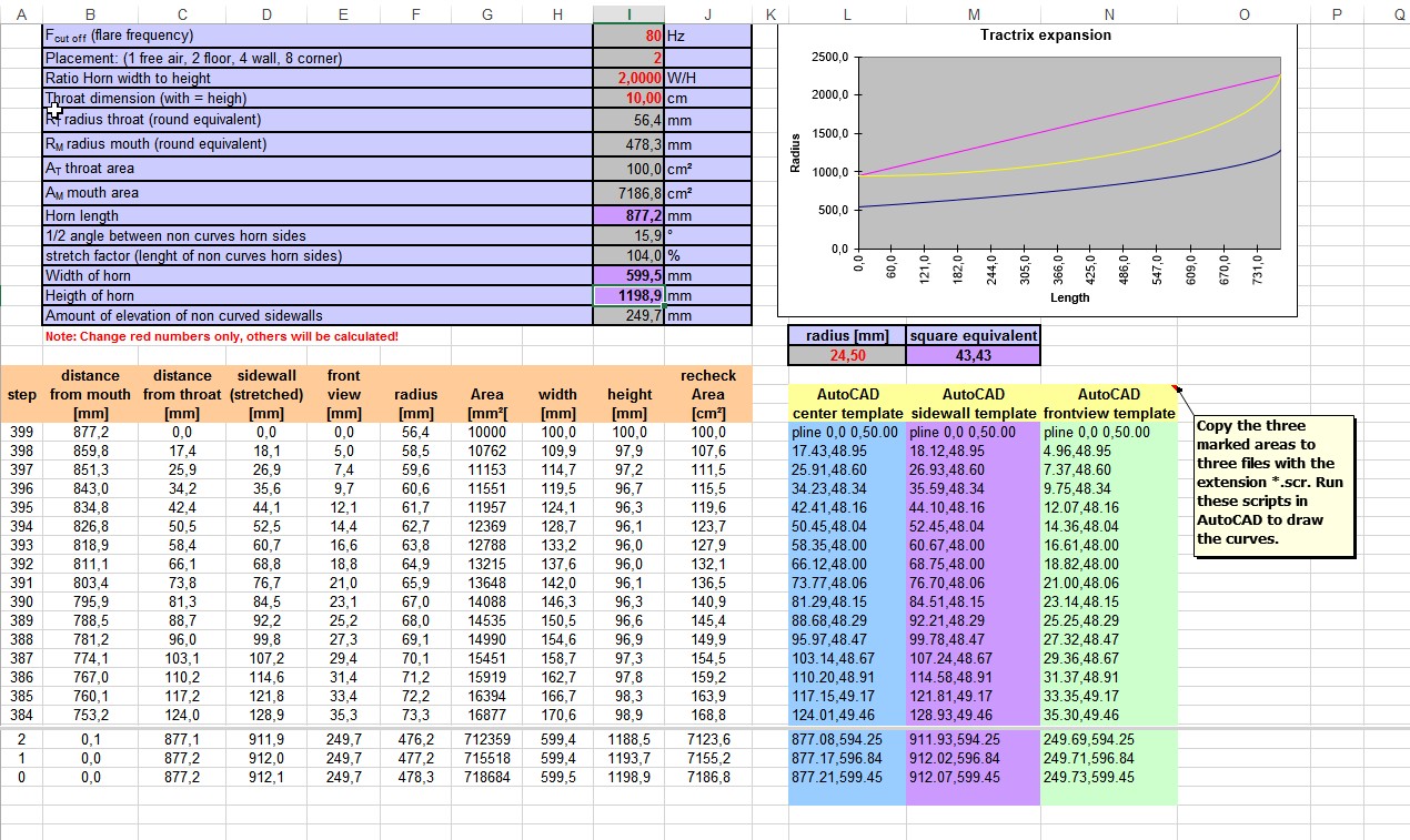

Just a idea, I want to make the horn not square but smaller on the conic side, so I can make the horn bigger and it,s wide smaller, how far can I go with that? I have made the ratio now 2,00 in calculator making it fit right in the house, high is no problem width is.
see the picture, these are quite nice.
the other picture is how I go to make it, with strong birch (picture is not from me but get it from the internet.)

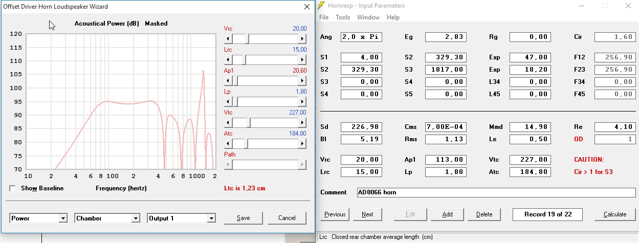

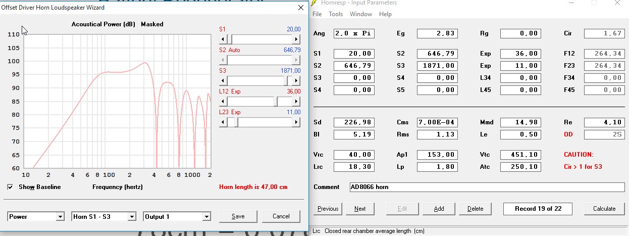

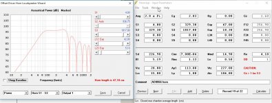

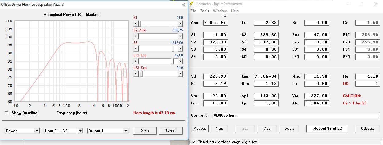

I begin to get something of akabak, but have now done a part in hornresp what concerns the bass, here there is not so much problems sim it and it is more easy.

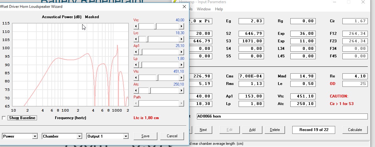

I have sim the woofer distance from throat and have two pics one for 12 cm injection port and one who is mucho smaller, it did not give much lower efficienty until you get a hug peak upwards HF. ports do so not need to be big, compression factor is the limiting factor and a huge peak as result.
Nice respons of the phillips woofers, quite sensitive.
This is with two woofers, ports are not critical except when to small then a nasty peak, see pictures of both, normal and small injection port, good is 152 cm2 and to small is 25 cm2, I think I have this devide to 4 because of 4 ports in hornresp.
