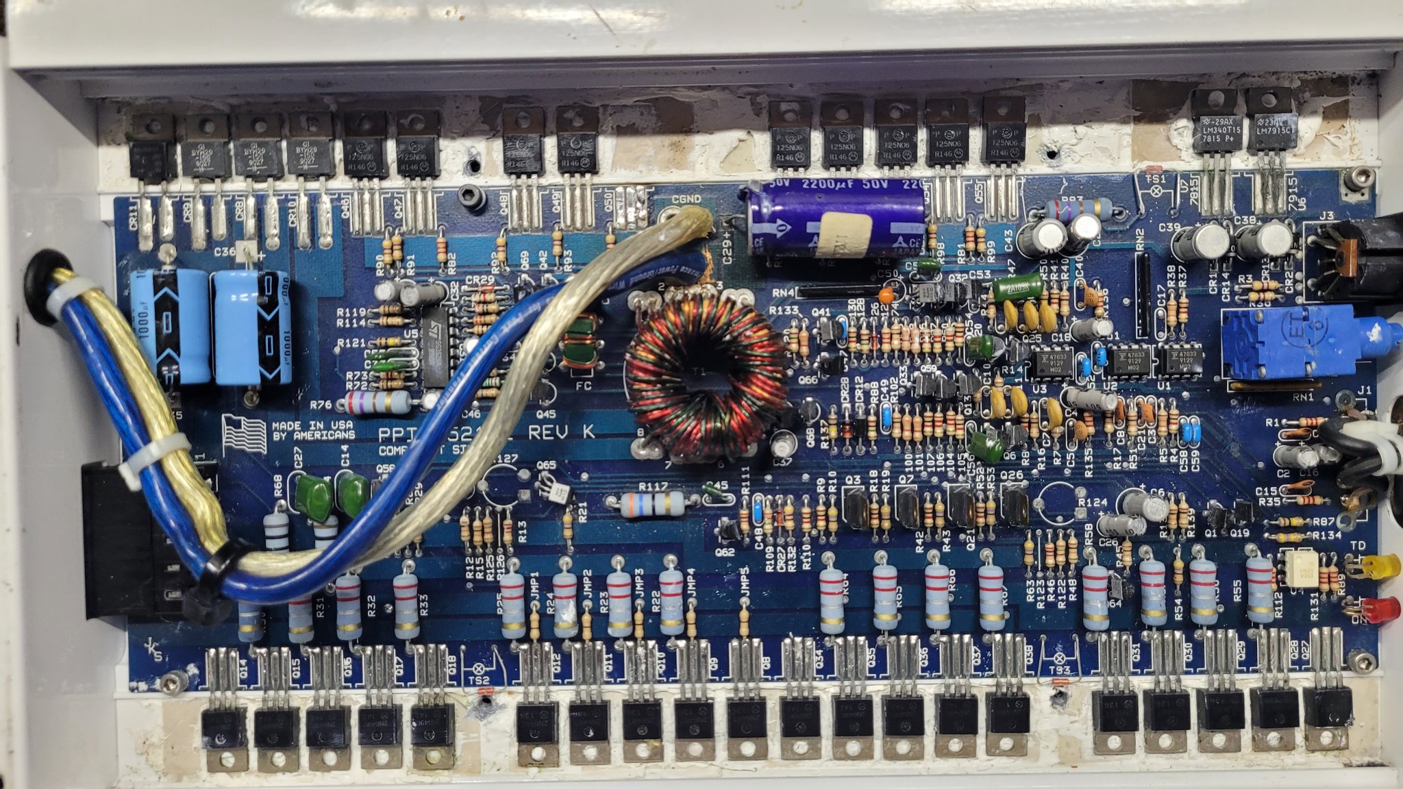

Precision Power 2150AM Repair
Couple other chips are not.looking so good with all the moving and bending (pins bout to break), was gonna replace those as well, they look pretty straightforward
LM7915CT and LM340T15
Must be regulators for the power supply?
Board all cleaned up and ready for parts.
I assume 1/4 watt is fine for those 47 ohm resistors?

Update: Replaced all parts and turned the amp on. Installed 10A fuse on the input. Hooked up a small home theater speaker bridged to the output.
Turned gains up and played some music at 3/4 volume or so, all seemed fine heatsinks were not overly warm. This ran for about 4 to 5 minutes then blew the 10A fuse. I pulled the back cover off and found the large capacitor was completely blown off the board. 1 Mosfet and 1 Output transistor were also shorted. Please see attached for bad component locations marked in red. Picture for reference only (not taken at time of failure) (capacitor pic of actual after it was blown off board). I had also replaced this capacitor with a new one from Mouser, but wouldn't know why that would have made any difference (the capacitor was also quite warm). That capacitor seems to just go across the line voltage? Possible I put it in backwards?
I then replaced the shorted FET and Output. Replaced the capacitor back to the original. Tryed my test again at 1/2 to 3/4 volume. Amp ran well for 2 to 3 hours without problem. FET side of the amp ran quite cool considering, the output side seemed a little warm for only running this small home speaker, however maybe that is normal? I know these amps run on the hot side. 10A fuse held and called it a day.
Next step is to hook up a 12" sub to the amp and see what happens, think we are kind of at that do or die point with this amp.
Any thoughts what may have happened or anything to check before I give it the big test? Thanks Justin

If the transistor didn't lay down properly (as is shown below), it could overheat. Make sure that all are parallel to the sink before installing the cover.
If the cover wasn't properly tightened or one of the fingers on it wasn't in line with the rest, that could do it.
It appears that the PS FETs are fully encapsulated. Fully encapsulated components don't use an insulator. It makes them run hotter than they will laying directly on the heatsink.
If you have a question about the polarity of the caps, measure the DCV across them when the amp is on. Connect the meter, power up for a second, read the meter and then power down.
Measure the resistance between the actual gate leg of each of the parallel PS FETs. They should all read 2x the gate resistor value.
