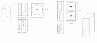

Have you concidered these kind of s-frames? I was planning to build a dipole bass stand for my speakers and wanted to make the "box" as narrow as possible so I designed these. These frames probably suffer from resonances above 150 Hz but for subwoofer they probably are ok.

DIAR said:Have you concidered these kind of s-frames? I was planning to build a dipole bass stand for my speakers and wanted to make the "box" as narrow as possible so I designed these. These frames probably suffer from resonances above 150 Hz but for subwoofer they propably are ok.
I guess this would work the same as a W-frame of a Ri-pole, except for that the cabinet is a different shape.

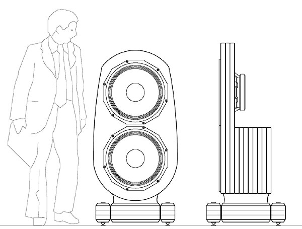

The box design looks definitely cool. But you should redesign the guy as he looks a little unimpressed !

I have a couple more theories why the your particular ripole design contributes toward a more boxy sound. In general I have found that the boxy sound (from any speaker) arises from boxes which are not braced sufficiently. This is really true of horns. I have Hedlund Horns which sounded like a hammer beating a pillow without sufficient bracing. I see several contributing factors to why your boxes may fall into this category.
First, it seems that you are using some sort of MDF. While MDF is great for deadening and thus preventing resonances which otherwise arise from the material, it is not as stiff as other materials. To have a very sharp bass sound, W-dipoles would require very stiff surfaces. To accomplish this with MDF, your various panels would best be doubled in thickness. I built my W-baffle out of 3/4 inch 13 ply birch plywood. This is very stiff stuff. Addiitonally, the baffles on which the drivers are mounted are 1 1/2 inch thick.
My W-dipoles use 18 inch drivers which require smaller panels than your 21 inch drivers which would stress the panels more and allowing them to flex more. I recall that Linkwitz uses 1/2 inch birch with his W-dipoles using 12 inch drivers. I used 3/4 inch for my 18s. Perhaps you should use 1 inch or 1 1/2 inch material.
By cutting holes in your panels, it weakens the panels further from resisting the pressure sources of the drivers.
I did a knuckle rap test. All points of my boxes resonate at frequencies above the crossover point for my drivers which helps to convince me that I would not have cabinet flexure which is too great.
The ripole boxes subjects the panels to greater pressure and are likely to flex more by virtue of their narrower width.
Even considering the points I make here, my boxes still vibrate quite a bit when really pushed with loud bass passages, thus my boxes would benefit further from additional thickness for some panels. I don't think that I would gain too much, but doubling all the 3/4 inch panels in my W-dipoles would likely improve the bass slam a finite amount.

Hi Retsel,
Thanks for the input. My enclosures are built from 22mm mdf (1"=25,4mm). I agree that the sturdyness of the boxes could be better. The various boxes are all experimental prototypes and all have the same general "fault" of being not thick enough. I am sure that the boxiness would have been less if I had made them thicker and added some extra bracing, but at least this way I can compare the relative characters.
