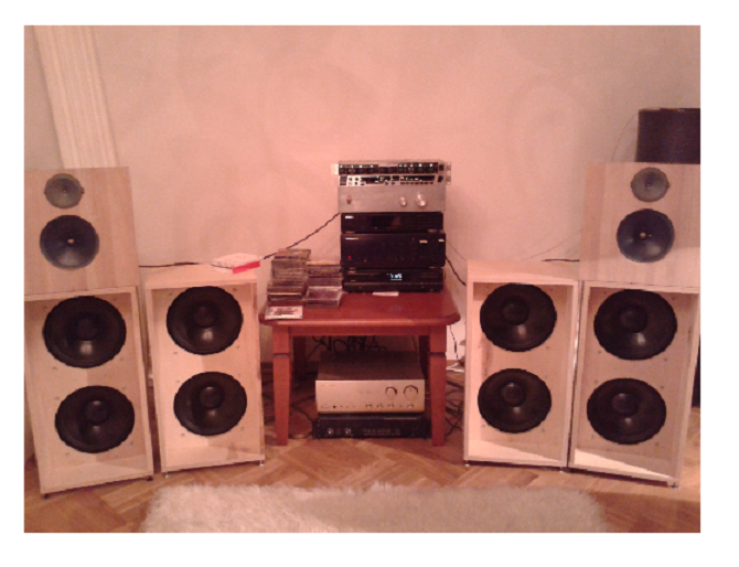

Precision Devices PD.2450 in OB, or alternatives ?
Two main reasons I think
1. Some room boundary coupling to the ceiling.
2. The path length in the vertical plane is doubled, in this case 2 times the max path length is stacked side-by-side.
I measured 16 dB gain at 20 Hz in my setup then I put an additional H-baffle on top of an other. 6 dB from twice as much cone area, and 10 dB from better acoustic efficiency.
Yes, that is true. But to remain a true line source, the length (or height in reality..) must be several times the wavelength, in reality around 4 times. For 20 Hz that means a line 68 meters in length.
An example: my RD-75 ribbons are true line-source with almost no vertical dispersion only above 6-700 Hz. And they are 2 meters tall.
No, not if you couple to the ceiling. Then it is effectively infinate. Excluding the other room effects.
Additionoally, as might have been mentioned by tinitus, your spl drop with distance will be 1/2 or 3db not 6db as in a point source loss/distance.
