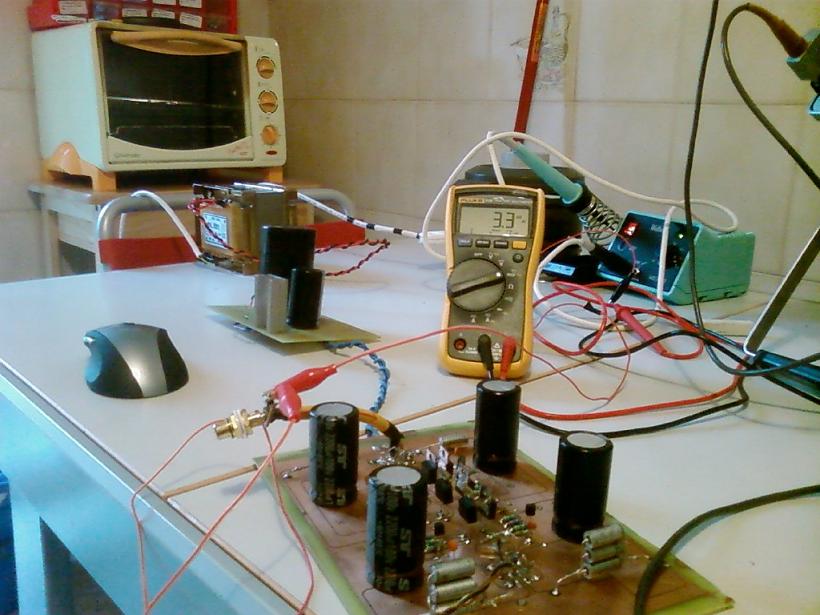

Stefanoo said:main parameters now:
connecting a multimeter together i get an output DC of 0.4mV (very good!) and ....that could already been seen on the scope...but to have a confirm of the result...it says a 3mV AC.....(i guess it is bad!)
Just a few thoughts:
The multimeter measurements are completely meaningless - the "very good" 0.4mV is taken after a cap so it should be zero anyway. The 3mV AC doesn't mean much as we don't know how high your multimeter goes. Not nice anyway.
Obviously you have oscillations. It is easier to advise what doesn't make sense doing.
- do not touch the gain
- do not replace the bipolar transistors. Having different Hfe will have some effect upon the dc conditions. I think you previously mentioned that your dc op-points were all fine.
What to do:
- raise all gate stoppers to 1k. The fact that you're using it single ended is irrelevant
It is not clear how you performed the scope measurements. Were the inputs grounded? Did grounding them have an effect upon the oscillations?

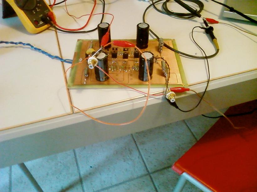

I troubleshooted for awhile the circuit.
I have had found one problem so far: i had a cold joint on the input capacitor of the negative side.
That's good....fixed it.
But....as i outlined at the beginning ..... i have problems with the scope.
I had the oscilloscope hooked at the output by crocoldiles.
so when i unplugged the power supply i have noticed that that wave that i have posted stayed on the screen and so i started wondering what it could be wrong.
Now for example....if i set the vold/div scale at 5mV and attach the probe to the circuit WITHOUT supply, i get that modulation of frequency.
At this point...i guess that the scope is unusable ...at least if i need to measure low noise or check for little problems.
I'll start looking for another scope, i guess it is a must at this point.
anyways....i connected the pre to my system and this time it sounded better than the last time (that cold joint was causing some distortion at the output).
I don't have any hum on the woofer but i just hear a little hiss....liittlee hiss on the tweeter.
Could it be caused by a low value of gate stopper resistor?
I'll try to rise them up as you suggested and see.
Any other advice to fix this hiss?
Could it be a wrong ground wiring?

hi grey,
yes my scope has a power supply related problem.
A 10x probe divides the signal per 10...i knew that already; so if i have a 10V in signal the scope will read 1V.
My question is: how can i measure if the pre is working well and therefore has a noise around 5uV, if the scope has a maximum resolution of 5mV per div ...which is 1000 times bigger than that value ...and more with a 10x probe..?
If i ground the input (there is a switch to ground) the trace goes flat sometimes and some other times not.
Well....i don't have clue of why i get that modulation when i switch to 5mV....but i don't think is normal.
i'm using a P6105 tek probe, i don't think it is not suppose to get anything since it should be shielded, am i wrong?
Could it be the probe damaged?
I actually have two of them...and i get the same exact thing on both...

so i found out what it was wrong.
You were right grey, it was the probe.
I think i have defective probes....since i get a weired noise.
I tried to connect a short bnc to the scope.
That distortion disappeared completely.
So if i have to analyze low noise signal i would need a good 1Xprobe.
Is this correct?
Should i be looking for a good 1X probe?

Well i first want to thank you for the big long answer.
Said that, now i want to outline just a couple of things without getting to dispersive.
1- the circuit is working fine and therefore i thankfully not have to check diodes..transistors...value...and so on
2- i evaluate the sound of the preamplifier just at the beginning, but then i decide to follow the suggestion received here and stop listening to it and check the proper function of the circuit itself. Therefore on the test bench i only have the circuit and the psu...and no....i am not so impatient to listen to it...even if it is, of course, the best part...but before to do so i want to make sure that is working as it's supposed to.
Stated the things above...the only thing i was wondering...and that was the reason of the last post and the email i have sent you.....was:
How is it possible to make LOW value voltage measurements(5mv/div)...with a simple piece of wire or as called 1X probe, without being covered form fuzzy noise on the screen.
That is what i have been trying to do in the last couple of days...trying to shield the probe and so on....but i don't understand how i can get noise (like 8-9mVpk-pk) on the screen just touching the board that is not powered.
Since i had connected it to the system got no hum on the woofer but just a little noise (hiss) on the tweeter, my purpose on doing that was to visualize on the scope this noise to get the control of it.
I don't know if it is the scope and tomorrow hopefully i' ll go to a laboratory of a friend of mine and use the teck TDS210 to get a better handle....
My feeling and my only two cents are for some on the probe on the arrangement or something that i don't get because...when i ground the input of the scope, the trace goes straight no matter what vold/div scale is selected.
I don't know but my way of thinking leads me to think that if it was the scope grounding the input wouldn't have effect on the noise i see on the crt...but i might be wrong.
.... how can you measure for example if the power supply has less then 5mV ripple....or even worse....if the preamplifier has 5uV noise?
Do you guys use a particular probe...a partuclar arrangement.....any advice? that's all...

I had soldered in the bnc cable to the output of the preamplifier.
I had to soldered it in because if i would try to have a little crocodile with a short wire i would p[ick up noise and i wasn't able to make any measurements.
Ground, therefore, was taken at the output of the preamplifier circuit and would go to the cold pole of the probe....i didn't have any particular arrangement....
In this way i was able......adjusting the cable making sure that wasn't capturing external field....to have a flat trace when circuit was off...and therefore to see at 5mv/div 1mv of noise at the output (pretty bad though!)
But....if i would try to disconnect the power supply from the circuit and hook the positive to the hot pole of the probe and the output ground of the power supply to the ground of the BNC cable i would see a very fuzzy trace even without power and in this way i wouldn't have been able to see any noise on the power supply itself.
I don't know....do you usually follow a specific rule when connecting the probe for this low voltage level measurements?
What way do you arrange your ground in for this measurements?
Hi Stefano
The only worrying bit is that the mosfets "act as antenna" when you touch them. This sounds too much like oscillation. Just tried touching mine and the output trace is completely steady.
I wouldn't worry too much about the noise/hum you see at output. Don't know what output attenuator you use but without one there is about 4k8 between the scope probes with some amount of pcb traces on either end. Apart from the thermal noise, which is negligible, this resistor and the output wiring acts as an antenna and picks up all sorts of stray fields. If your circuit is not inside a well screened case you would expect some 50Hz/RF pickup.
As an experiment hook your probe across a similar value resistor and see how it looks on the scope.
