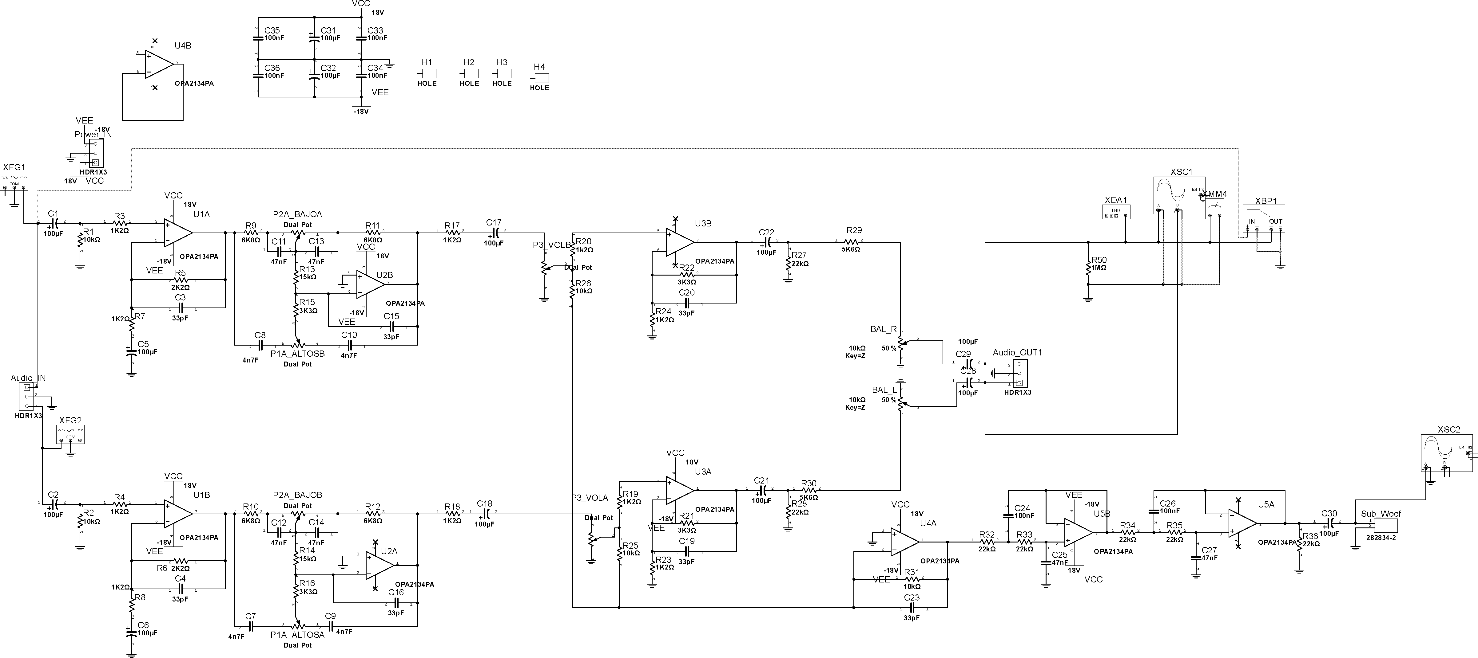

About your preamp, I would ignore c28-29 , they sit right before the coupling caps from the power amp.....
And I think I would ignore the whole balance group, including c21-22...

Thanks for the good points. My current source of caps doesn't run the nichion, so will probably go for the polyester type for economy and ease of sourcing. I may just get rid of c28-29 as you suggest.
I didn't want the balance pots either but my living room/ speaker arrangement means I'm not dead in the middle of the speakers hence the need.
I could probably do away with the entire subwoofer section as well, as I don't have or intend to use a subwoofer. I could then separate P3A and P3B into individual pots and use them for the balance that I need. It would also make the PCB simpler.
Assuming I did remove the subwoofer section. What do I do with the bottom ends of R25 and 26?
if you want not to include the subwoofer section you have to ignore r25-26 completely , but to be honest I would keep that option , you could do a small daughter pcb just for subwoofer .

Ok great, I'll remove r25-26.
I've done layouts for both options but will probably go for the one without the subwoofer, as I've got nowhere to put another speaker.

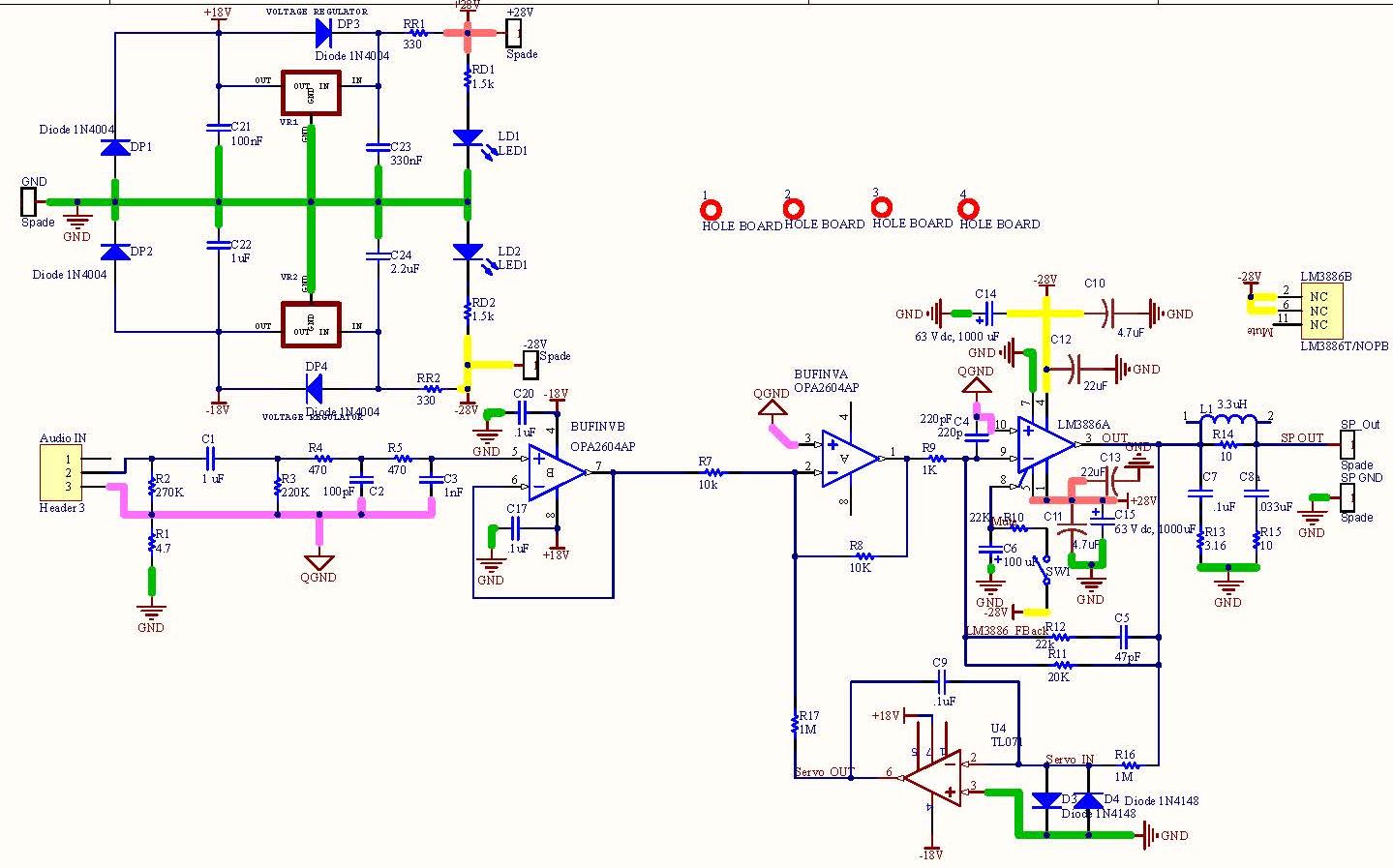

15V dual rail power supply for the Cordell SGC/ SC200 Preamp, done and tested OK so far, with 150mA load. The board measures 85x56mm.
I'd thought about using the LM317/337 combo but settled on the LM7815 LM7915 regs and a CRC (2k2-10R-2k2) filter prior to the regs for simplicity. If it proves noisy, I'll remake with the LM317/337.
The regs have SK104 Heatsinks. The KBU1010 rectifier is over the top but its a used one and all that I had.
There are a couple of LEDs on the output rails that consume almost 4mA each. I've come to realise that using LEDs at their rated current is way to bright for my needs. I just want to see a glow, hence the 3k7 resistors!
The small caps before and after the regs are IAW figure 16. split power supply of the LM78XX Fairchild ON datasheet, so hopefully I shouldn't get into trouble by not using 100nF all round. All but the 100nF are tantalum.
With no load, the DC input to the regs is 21.8V which might be slightly high. I could also use the other tranny winding which gives 1V AC less than the current winding.

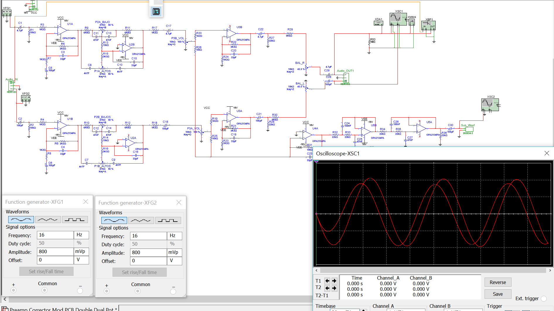

This is the version of the preamp I will most likely go for, without the sub woofer section. I couldn't find a proper Alps balance pot, so used two individual pots for LR level control. As previously mentioned, I found the Nichiocon UES1V101MPM1TD 100uF caps and will use them after all.
I may still make a couple of changes to the PCB prior to build but hopefully it'll work.
Any comments and input always welcome.
