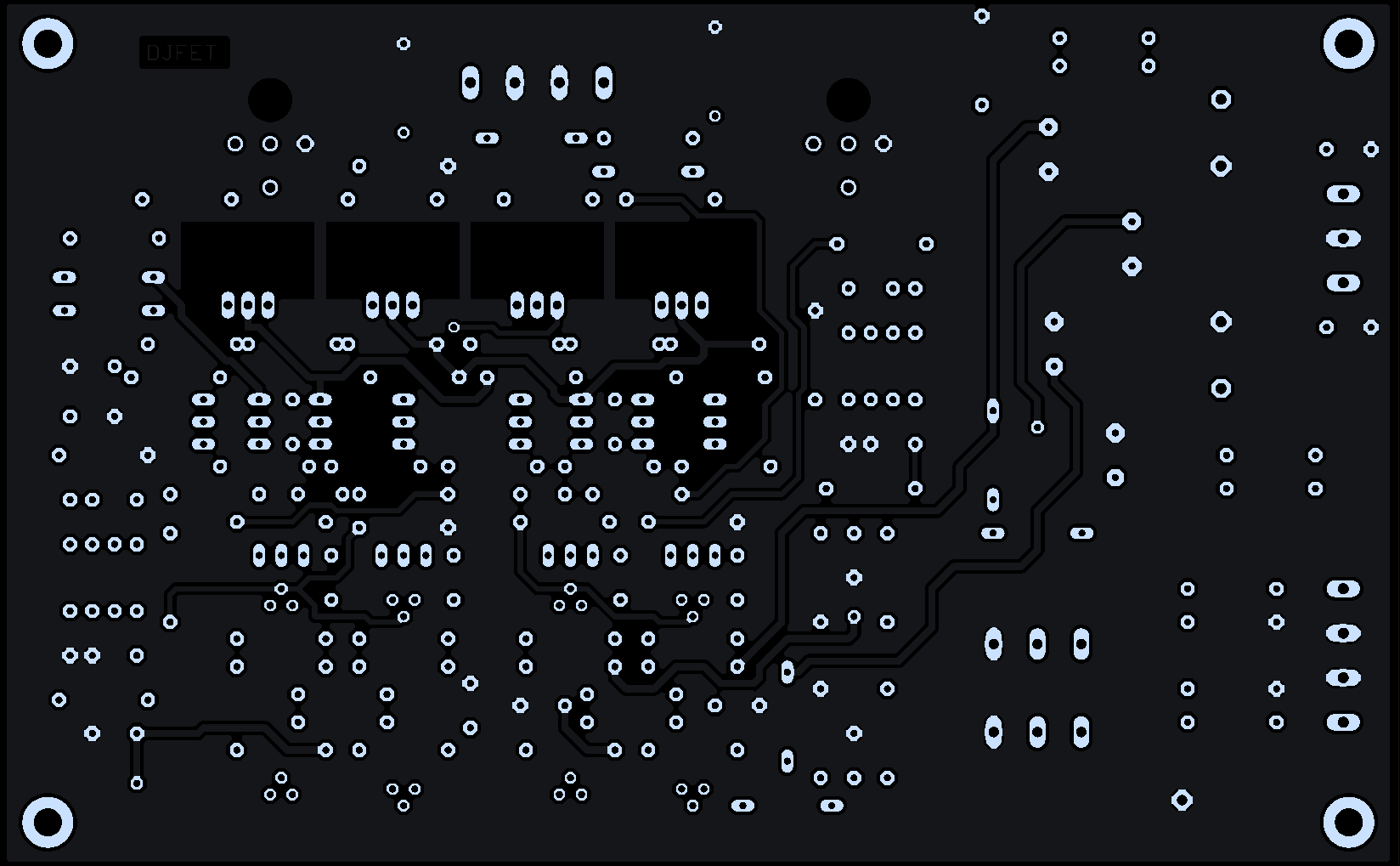

Also interested in a board if they become available again. @PMA is there a (current) BoM available somewhere?
There will be a new BOM available (though not very different from the original one) and the link will be posted. Also everyone who will order the PCB will be provided with a link to valid documentation with schematics and project manual. This will happen after I have the new boards produced, which is supposed in the beginning of the next week.
I have also requested the mods to re-open my old thread in "Vendors bazar" dealing with PCB's sale. I can be also contacted through email through my web page.
Thanks to the mods, the thread dealing with Dispre 2 - JFET boards sales in the Vendors bazar section was re-opened.
Please use it for further communication regarding the project boards, or send me direct email. Thank you all.

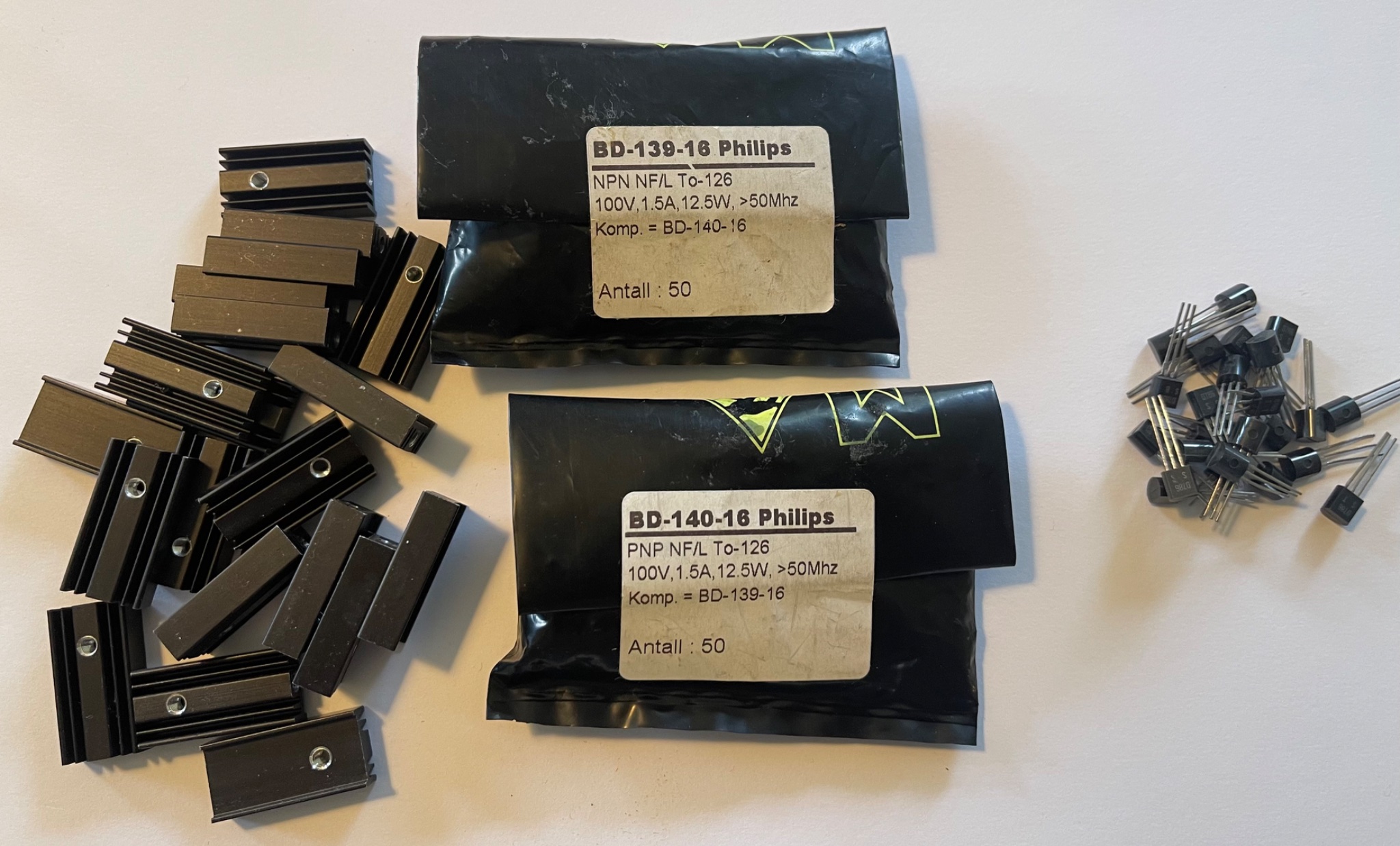

DisPre Key components offer.
As many of you have noticed, I’m currently selling matched octets of original Toshiba 2SJ74BL / 2SK170BL. Which is exactly what this preamp needs.
I’m offering an octet Jfets, four Fischer SK95 heat sinks and matching number output transistors for €100, shipping within EU included.
Please stipulate which IDSS you want.
I had originally planned to offer this via a normal ad, but after contacting PMA he graciously allowed me to post in his own thread. Hats off to that gentleman.
So guys, dig in and order these parts to be ready when the board arrives.
PMs preferred.
Regards
RM

Below please find a link to a preliminary BOM:
https://pmacura.cz/dispre-jfet_bom_2025_preliminary.pdf
I would suggest to wait with components orders until the boards are produced (next week) and confirmed for delivery. By now, the existing board requests should be fulfilled.
Please note the part suppliers can be changed according to your domicile and availability. The BOM is just a kind of suggestion only and rather gives you an idea of parts dimensions etc. Critical suggested parts are the JFETs, ALPS pot and the capacitor types like COG/NPO etc.

Thank you Patrick. It is of course possible to use a different manufacturer of BC550/560. As said, it is not a critical part. However, I cannot recommend the TTA/TTB instead of BD per your recommendation. This cannot be done without thorough testing and results on more than 10 pcs preamps built. Even then we may get surprised with something unexpected. I am more engineer than a hobbyist and to me a new, different part means a new product that is to be tested and approved.

Oh, as an engineer of 45 years, I totally agree that any public project should only be released after thorough testing.
As I always do.
I am always curious to try out new, modern-day components.
And I only trust reputable manufacturers, who only have the resources to perfect their manufacturing processes.
Just my personal preferences.
Patrick

And today, finished PCB's have been sent to me and I expect their arrival on Friday or next Monday. After they are at my place, I will contact those who have been interested in the boards. Expected price is $20 or €18 per pc, plus shipment costs (depending on country of destination). For lowest cost overseas, registered mail is planned to be used. Within EU, everything is much easier.
Everyone who pays to me (PayPal) will receive a link to complete documentation (assembly manual and parameters, schematics with part numbers and values, board layout with components placement, BOM). The documentation is not made available in public, however, this thread contains a lot of technical information and hints for the skilled hobbyists.
Just curious, do you expect any change or improvement in parameters after replacing BD139/140 by TTA/TTB 004? I do not, after checking the datasheet. I agree it is interesting to check SOTA components, but in case of unobtainium JFET based, discrete line preamp we are in another river. It is a hobby and the way to try something that was good but is lost because of everlasting pressure to reduced costs and high production efficiency. Just the opposite of DIY. We try new op-amps, DAC chips etc. But it is not the case here.
However, we are OT with such consideration and I would prefer not to extend it, please.
