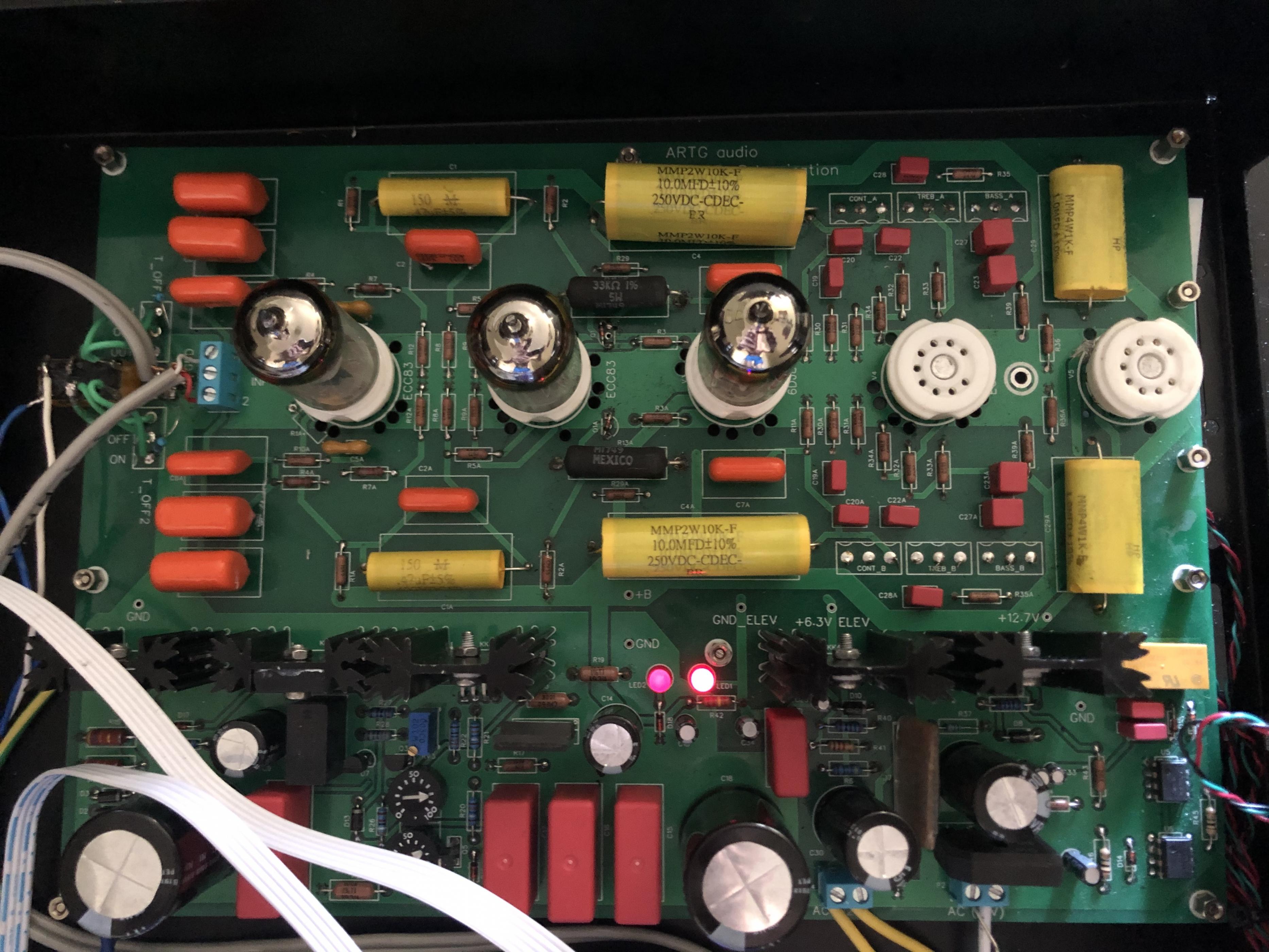

The circuit is working now however it will need some improvement. I use it with solid state power amp, 47k input impedance.When the amp is on first and this preamp turns on, after 40 seconds the muting relay releases and gives an output to the amp. I can hear "thump" through the speaker and also upsets the speaker protection in the amp.
Turning of the preamp first is also no good.
Also, the TONE Defeat switch (driven by relay). At the beginning within first 10 minutes, switching this ON and OFF makes loud thump in the speakers. It gets better after the preamp is warmed but does not eliminate the thumps, they are just less audible.
Any suggestion would be much approciated!

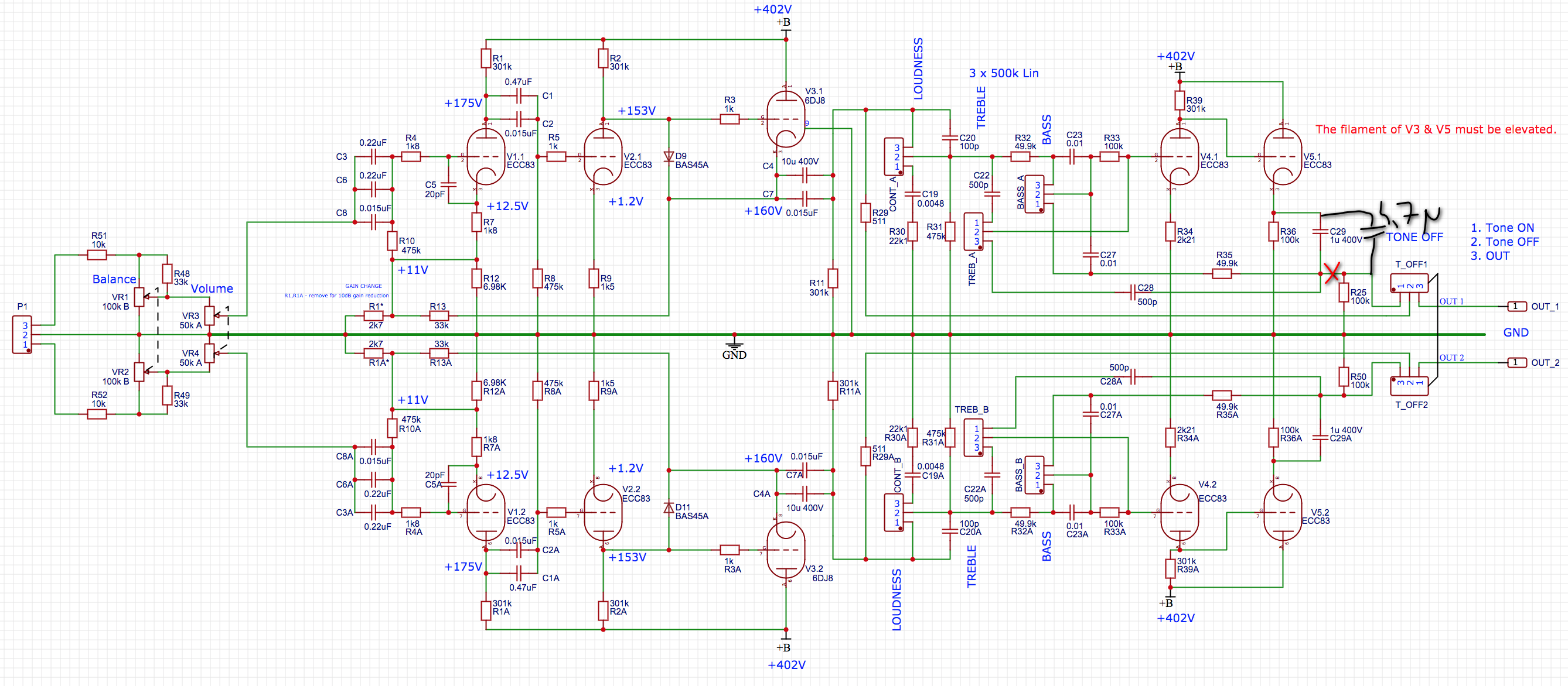

I don't like that the OUT after the capacitor is wired to go back in the circuit ... maybe some DC voltage can appear there , do some measurements .
If this is the case you can add a second capacitor just for coupling the output .
And add some output resistance as I said in previous post .
Where exactly in the circuit is this DC voltage during power-up?
Do you mean C29, 1uF?
If you mean at the output, the cathode voltage goes up, and the series coupling capacitor, C29 charges up, and that causes a voltage at the output, until the time that the cathode is at its final quiescent voltage, and until the cap is fully charged to that voltage.
Then, at that time, the quiescent voltage at the output better be zero.
And that raises the question, where is there a resistor that connects to ground, that the other end of the resistor connects to the output of C29?
It is missing in the schematic.
If your DC meter is the only DC path from C29 to ground, then you need to add a resistor there to ground.
Prevent you power amp from having to "swallow" all of C29's charging current.
at the output. depends on position of the TONE switch. Measured with DC meter through 1k resistor.
1. Sw shorted at 3 & 1 (1 & 3 bottom channel), measured at the output. after the power up I could see 2.5VDC then it goes down to +40mV and -40mV never stabilise on both channels
2. SW shorted at 3 & 2 (1 & 2 top channel) same as a above but after a while channels stay at 0mV.
the 100k load resistor is fitted 1 and the second channel 3 of this tone switch to GND

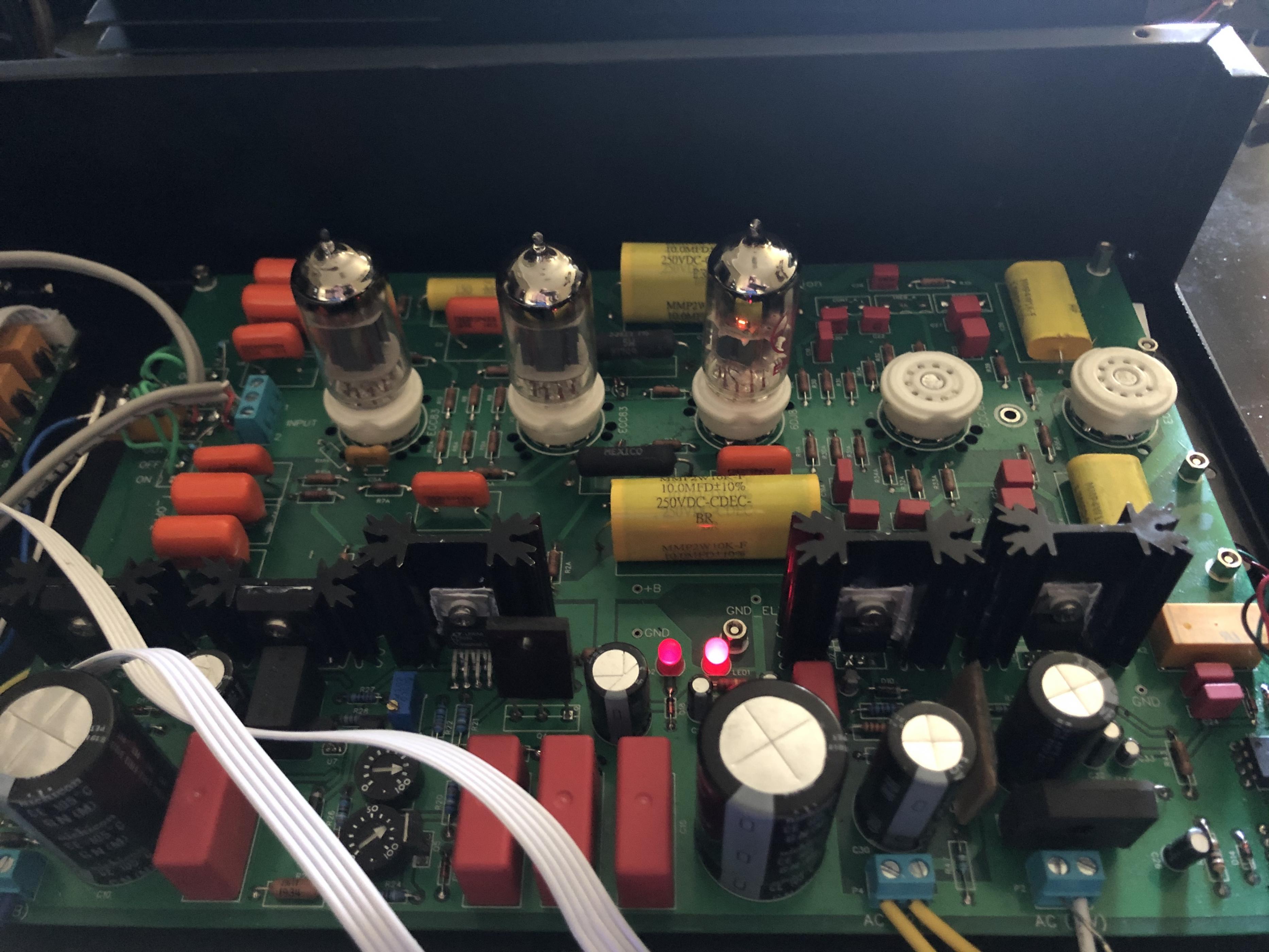

Thanks for participating in the project. I will remove the tone control circuitry and do proper measurements later on to have some idea of the performance.
R1 2k7 resistor is to reduce the gain by 10dB if it is removed which I have this now. I did some measurements some time ago where SNR was around 90dB and the frequency response was really nice. That was when the PCB was not in the enclosure.
I am listening it now and is not bad...

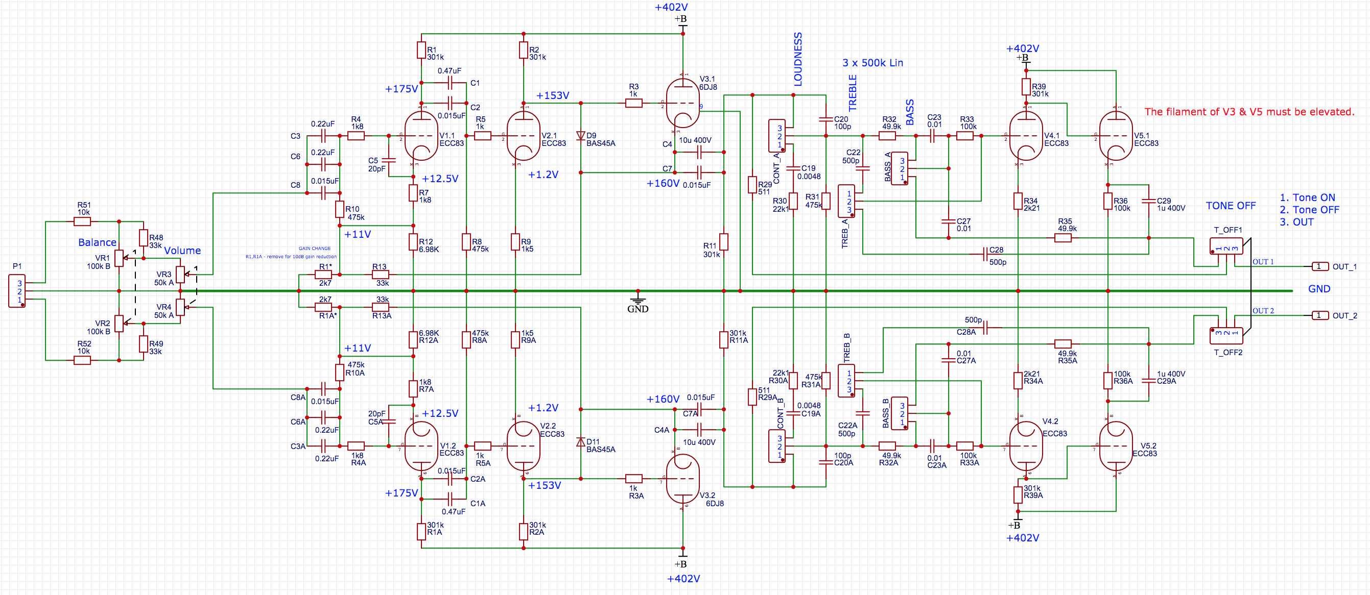

Add a second capacitor from cathode to out , cut the original trace but the old circuit will still work the same for negative feedback . The tome control circuit is active , thats why needs signal back from the output capacitor
thanks mate for the advise, i think it would work just fine. Anyway, I have already decided to turn off the tone control circuit. I ended up having some issues with pots, they are brand new but already have experienced problems with cracking noise, I would have to buy another set and probably ALPS. these were BOURNS - no good!
Besides, i noticed the tone control circuit slightly overloaded previous stage. I didn't fix that.
now. Ive been playing after modification and it sounds great, really! I've swapped ECC83 with 5751, a bit lower gain but is good so far. I will swap JJ E88CC with Electro-harmonics next week.
