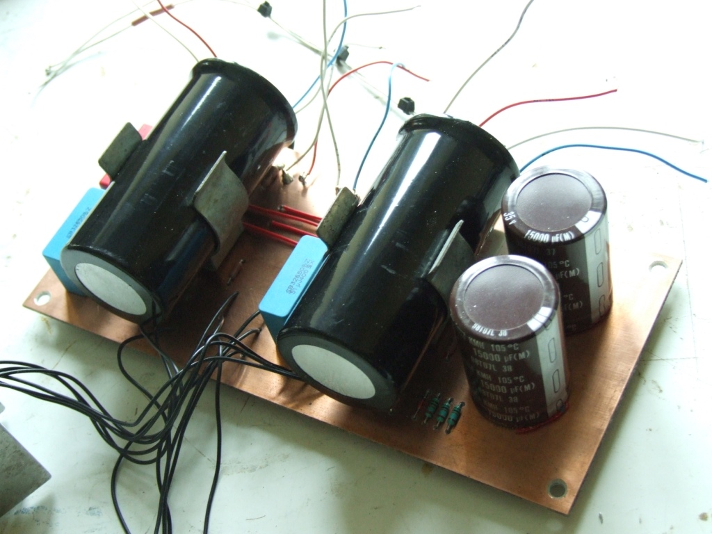

The DCB1 gets around the problem of the PSU choice by combining the B1 (OK in a different format) with a SALAs Shunt Reg. This is the one that I'm building at the moment.
DCB1 PCBs aren't currently available, hence I etched my own.
