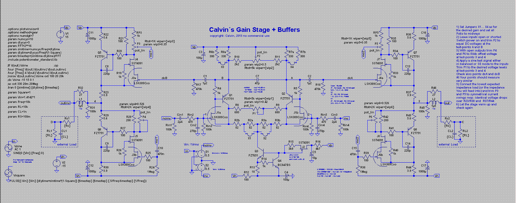

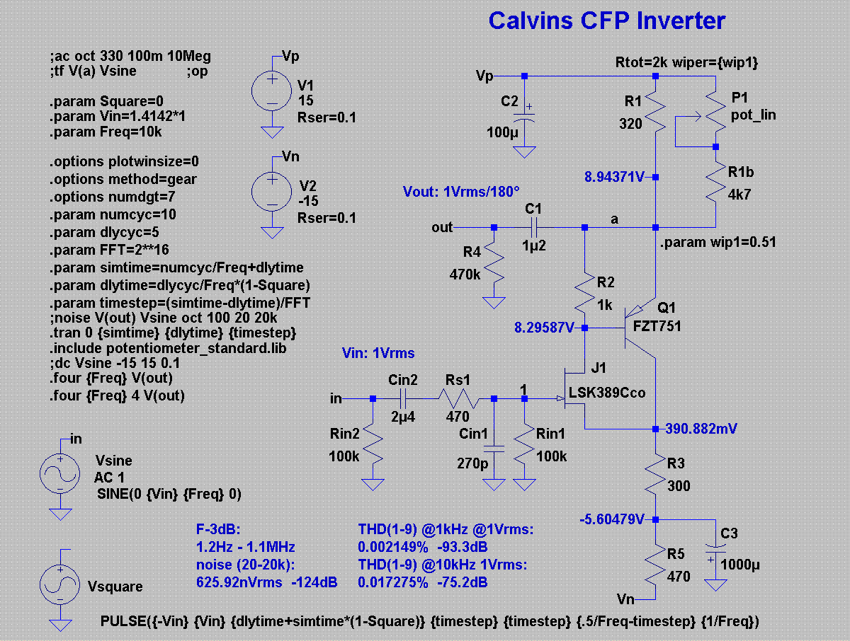

@AndrewT
The bias current was chosen high. The CCS runs on ~37mA and each of the two branches thus on ~18.5mA. Of this the PNP takes on ~17mA, or ~95%, while the JFET runs on <1mA or ~5%.
The current distribution between JFET and PNP can be changed by varying the JFET´s Drains resistors R1 and R5. Decreasing the value raises the JFET´s bias and decreases the PNP´s bias. The THD (mostly K2, K3) slightly increases with K3 becoming the dominant harmonic.
The combined bias current was chosen so high because of twoandahalf reasons.
a- the required Source- and Drain resistors R2/3 and R6/7 could be kept small in value.
The source resistors directly affect on the noise figures. Lower values --> lower noise contribution.
b- a high ratio of bias current to signal current is usually good for low distortion figures. If You reduce the CCS-current to ~17mA (R13=39R) the THD-figures rise approximately 3x.
0.5c- The chosen supply voltages and impedance values required a high value to give a operating point at A and B of roughly 1/2 the positive power supply voltage.

Calvin,
thanks for that very full explanation of your design.
Is the 0.6mA bias of the 389 chosen by simulation, or by measuring the distortion of the built circuit.
Since the bias is so low do you recommend a GR grade?
Maybe the low end of the GR grade?

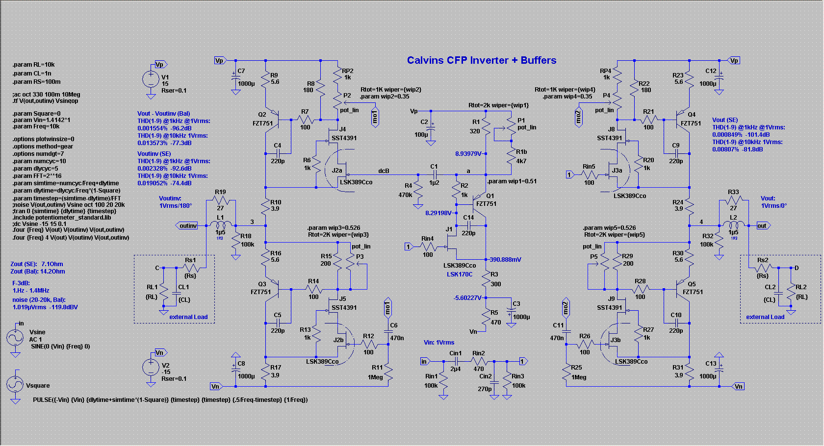

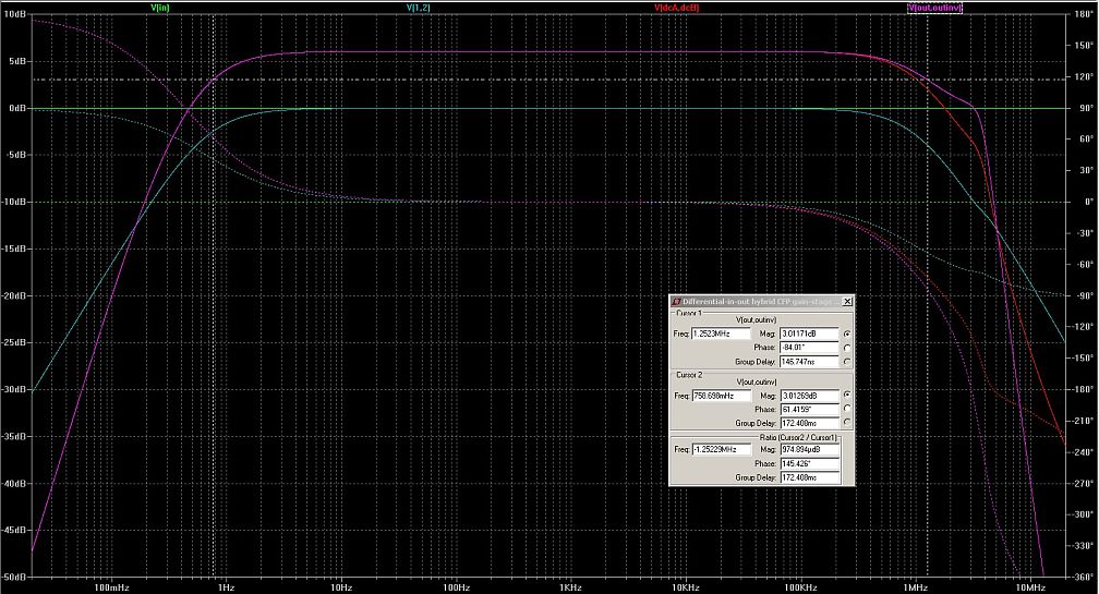

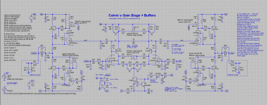

some sim results of the gain stage:

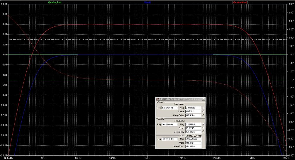

Pic 1: Amplitude response of the gain-stage.
A clean Bandpass response with bandwidth limits (F-3dB) at 0.75Hz and 1MHz. Vin and Vout(SE) are at 0dB, Vout(bal) at +6dB
Pic 2: Amplitude response of the gain-stage + Buffers.
A nearly identical clean Bandpass response with bandwidth limits (F-3dB) at 0.75Hz and 1MHz.
Vin and Vout(SE) are at 0dB, Vout(bal) at +6dB.
The output amplitude (magenta curve) at >1MHz rather shows the reactive behaviour of the output LR-network with the attached RC-load than the buffers behaviour.

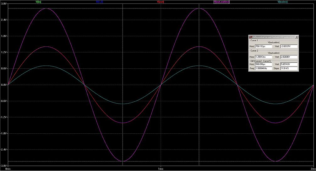

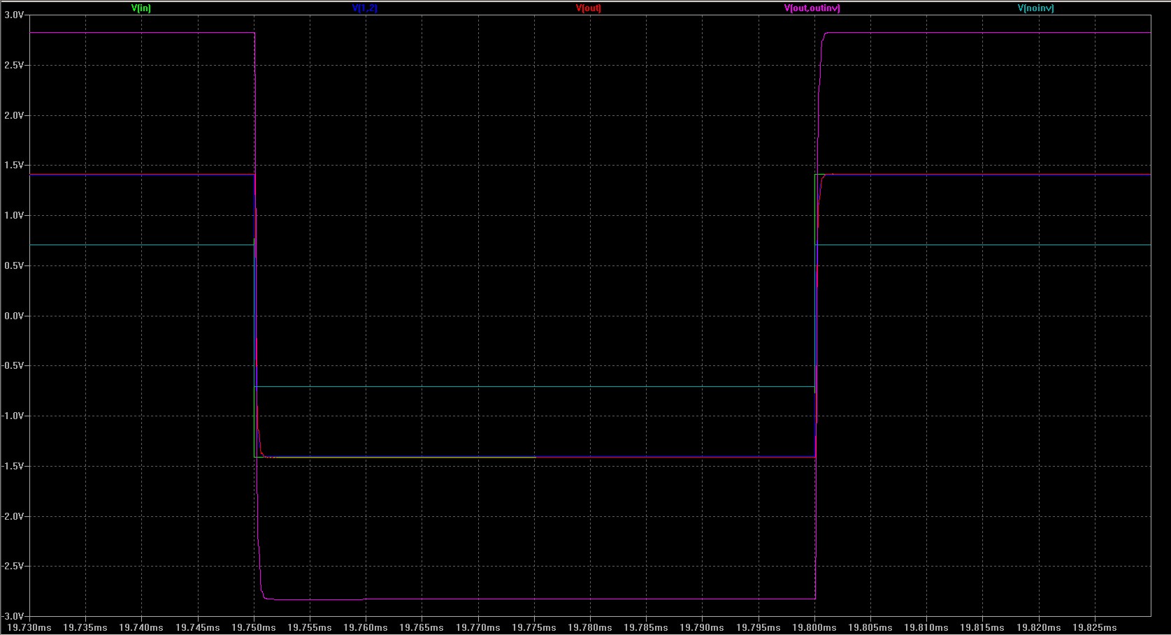

Pic 3: Transient response to a 1kHz 1Vrms in signal fed in balanced mode.
The curves for Vin (green),V1-2 (blue) and Vout(SE) (red) are overlapping and hardly distuingishable from each other.
The single Vnoninv input (light blue) is exactly -6dB lower and the balanced output (magenta) is +6dB higher.
It shows that the two trimpots in the gain-stage can precisely trim the gain to its desired value and to perfect interchannel balance.
Pic 4: Transient response to a 10kHz +-1.4142V in signal fed in balanced mode.
Colors are the same as in Pic 3.
One can see that the transient behaviour is almost fully defined by the input Bandpass´s transient response (blue).

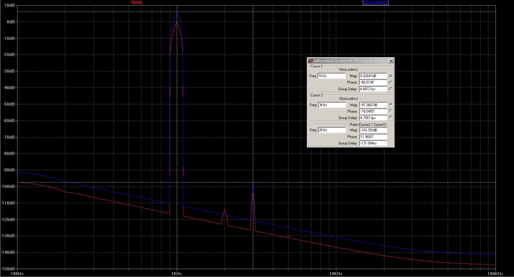

Pic 5: a FFT of a 1kHz 1Vrms in signal fed in balanced mode.
Vout(SE): 1Vrms
K2: 0.0002174% -113.2dB
K3: 0.0006776% -103.4dB all else insignificant.
THD(1-9): 0.000714% -102.9dB
Vout(bal): 2Vrms
K2: 0.0000670% -123.5dB
THD(1-9): 0.000684% -103.3dB

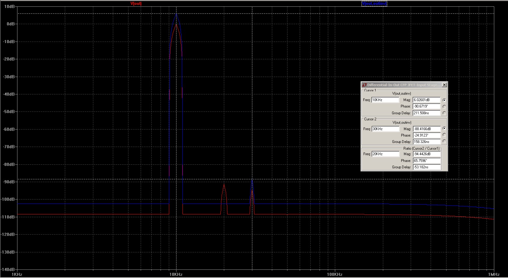

Pic 6: a FFT of a 10kHz 1Vrms in signal fed in balanced mode.
Vout(SE): 1Vrms
K2: 0.002777% -91.1dB
K3: 0.001565% -96.1dB all else insignificant.
THD(1-9): 0.003188% -89.9dB
Vout(bal): 2Vrms
THD(1-9): 0.001565% -96.1dB
Now let´s hope, that the praxis confirms the simulations and that the gain-stage sounds equally well as the buffers.
Vout(SE): 1Vrms
Vout(bal): 2Vrms
Vout(SE): 1Vrms
Vout(bal): 2Vrms

Differential-in-out hybrid CFP gain-stage w hybrid CFP Buffer rect-10kHz.jpg205.2 KB · Views: 893
Differential-in-out hybrid CFP gain-stage w hybrid CFP Buffer FFT-1kHz.jpg267.4 KB · Views: 200
Differential-in-out hybrid CFP gain-stage w hybrid CFP Buffer FFT-10kHz.jpg261.8 KB · Views: 209
here´s the asc-file
Models:
LSK389Cco from Bob Cordell´s lib.
SST/MMBF4391 from ONSemi or Fairchild
BC847BS from Diodes/Zetex or NXP/Philips
FZT751/651 from Diodes/Zetex
Potentiometer from LTSpice Yahoo-group
jauu

if someone doesn´t need or want the fully differential CFP gain-stage, he might just add an Inverter ahead of one of the Buffers.
Here´s an Inverter similar to the differential CFP gain stage as a CFP Inverter.
Again the JFET/bipolar CFP cell forms the heart of the circuit.
Basically I omitted with the tail current source and cut the differential stage in half. Most anything left remained the same.
In the final circuit with Buffers a compensation cap C14 needed to be added from the bipolars base to its collector.
It should be obvious, that the behaviour the two branches -Buffer alone vers. Inverter + Buffer- is not precisely the same.
This could be regarded as a disadvantage against the fully differential circuit, as well as only gains of +1 and -1 are feasa
