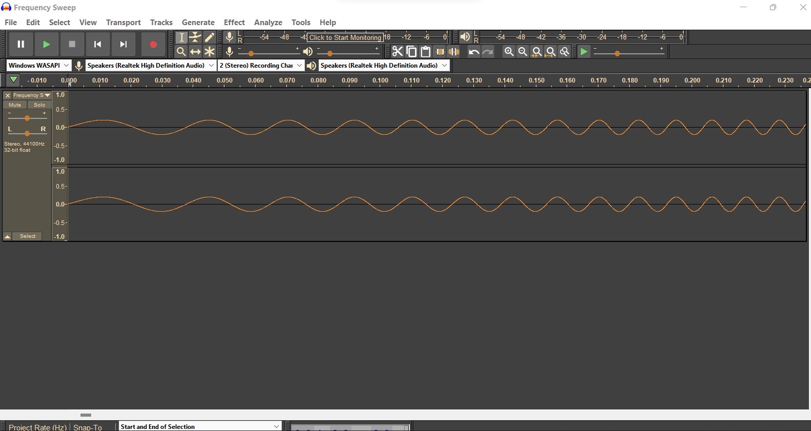

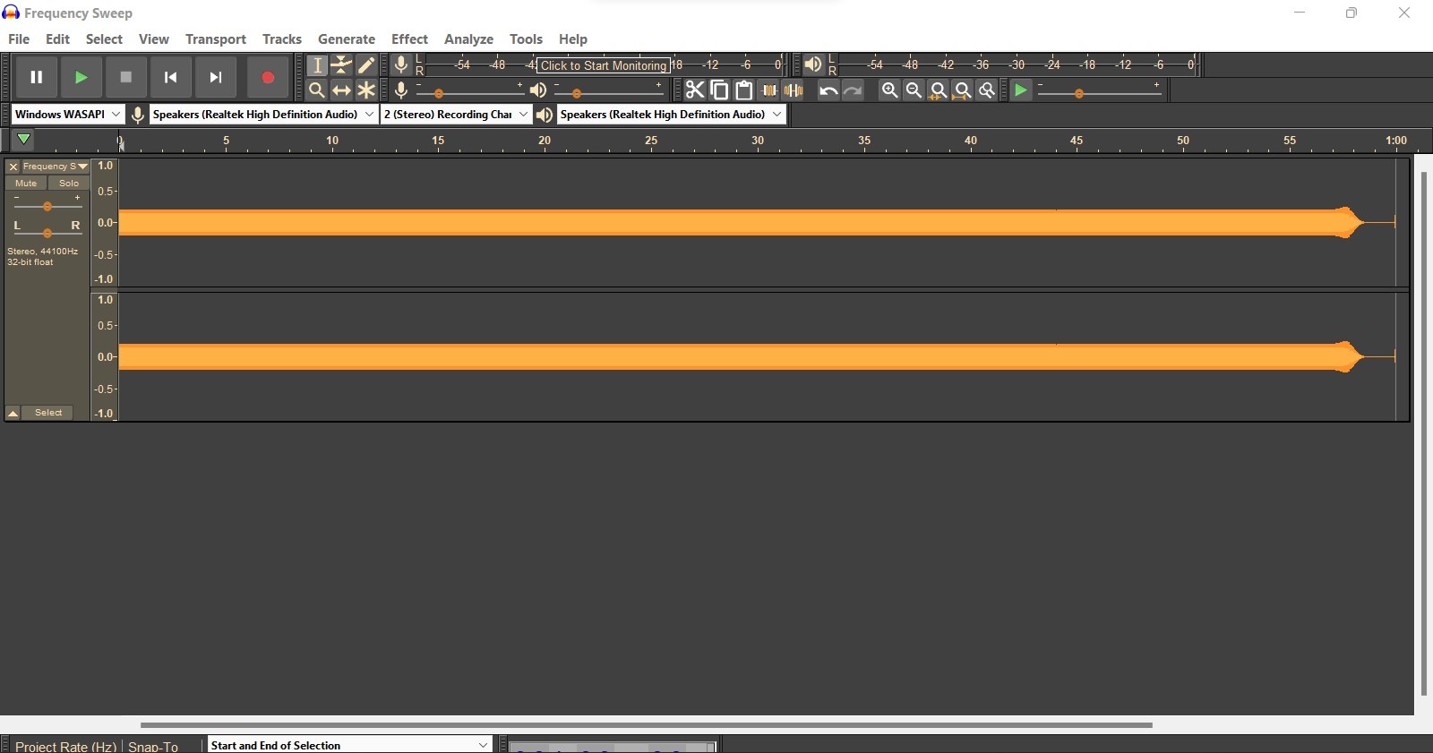

Here we go. It doesn't quite reach 20k because of MP3 limitations and keeping the file size small but it should be fine. It starts at 20Hz. On the scope the amplitude should be constant as the frequency rises and that should be the same after passing through the amp with the tone controls centred.
Thanks! I tried it out and the frequency sweep looks pretty even all the way through - it starts maybe 10% higher then amplitude is constant from 300Hz.

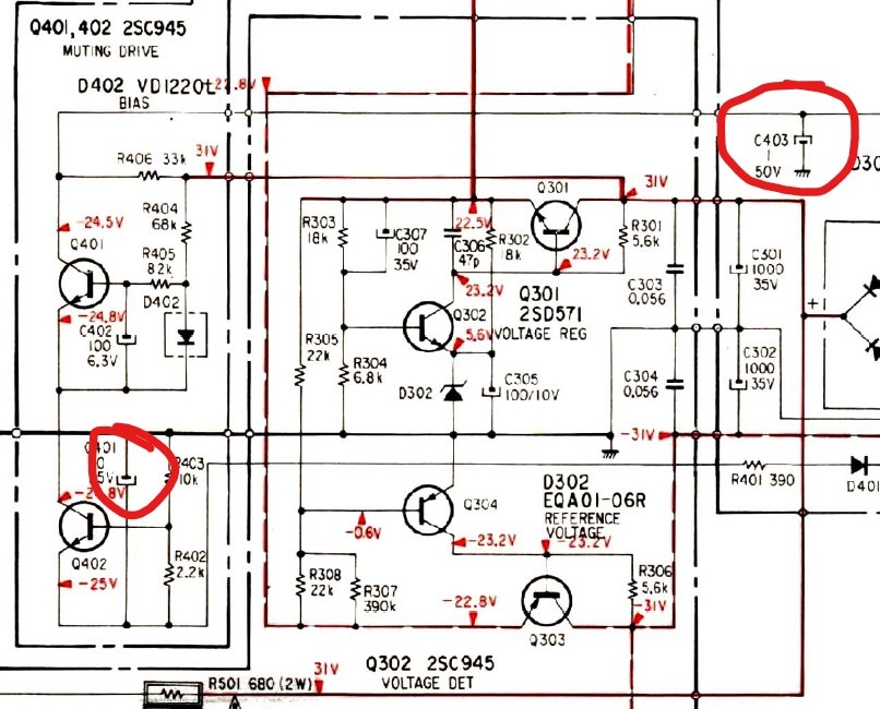

So, the noise is measurable at the junction of R121, the input to the volume pot, the collector of the muting transistor Q405, and a wire going to the loudness switch board which, since loudness is switched off, is a dangling 33k resistor. The same is true of the right channel with muting transistor Q406.
Since interference increases as volume increases, a source of some of the interference must be at the aforementioned junction. Which means that the muting transistor must surely be the source... but I tried shorting across it, and that made very little difference. Maybe there was slightly less, but it wasn't perfect. I looked at the voltage going into the muting transistor, and in addition to being a few volts less than it should be (-21.something instead of -24.5) it's fluctuating +/-0.2V at 50Hz.
There are similar muting transistors on the output stage, too - which I obviously can't test without removing, as shorting the collector to the emitter mutes the output!
Does it make sense to test the behaviour with the muting transistors on the input and output stages removed, to eliminate a possible cause of the interference? They're the only other active components in the signal path apart from the opamp.
It might be worth a look at the muting circuit although its hard to see how that could generate hiss. It could possibly add hum though.

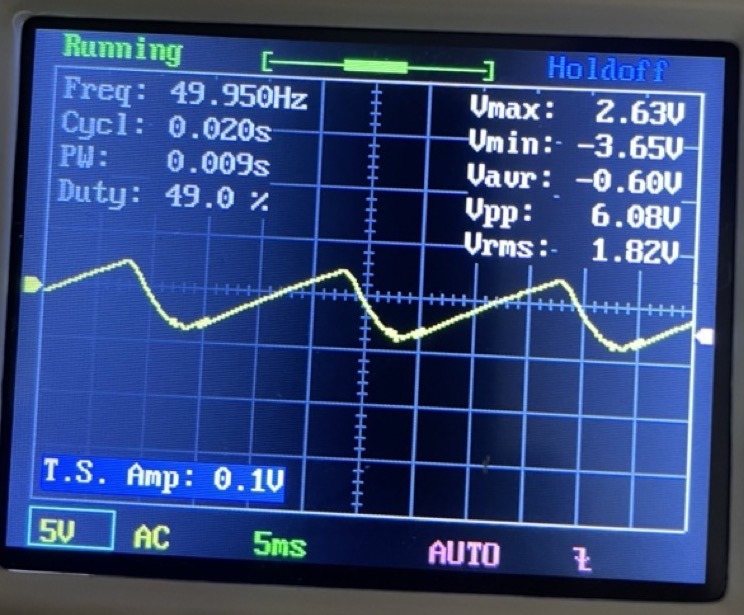

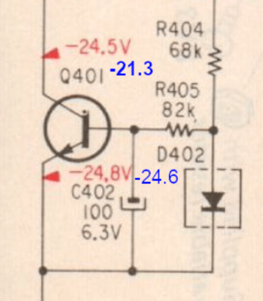

Rather than pull the transistors (you can pull them all out if you want) you could try looking with the scope at the voltage across C401 in the power supply (should be fairly clean) and also the mute voltage applied to the mute transistor bases's.

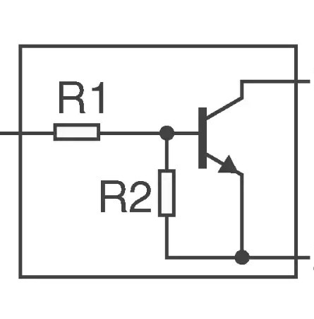

The voltage across C403 should be clean. It is shown as -24 volts which doesn't quite compute tbh for being applied to a base/emitter junction (the mute transistors) unless the 2SC1636 has inbuilt bias resistors. The circuit mutes when the voltage goes positive and turns the transistors on. Again, with a regular transistor that voltage would limit at around 0.6 volts.
I can't find a data sheet on those transistors but they could be pre-biased.

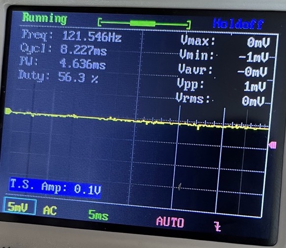

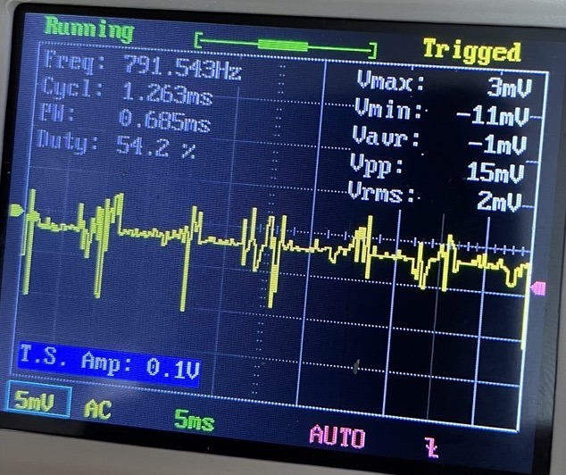

The voltage across C401 (-25V, as it should be) isn't very clean. It's not even a clean sawtooth!

The voltage across C403 (-21.7V, should be -24.5) isn't very clean either.

What you see on the scope is probably normal and those caps are small in value by design to give a fast mute action. Its not super clean but clean enough. So its going to be OK.
-24 volt on the transistor full turns it off (and they must be pre biased types to allow that voltage to appear across them). The small ripple superimposed on that -24v doesn't make any difference, it is off whether -10, -20, -30 volts were present and even if it varies between those levels.

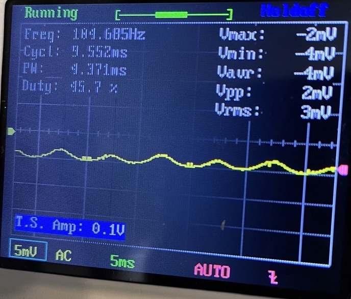

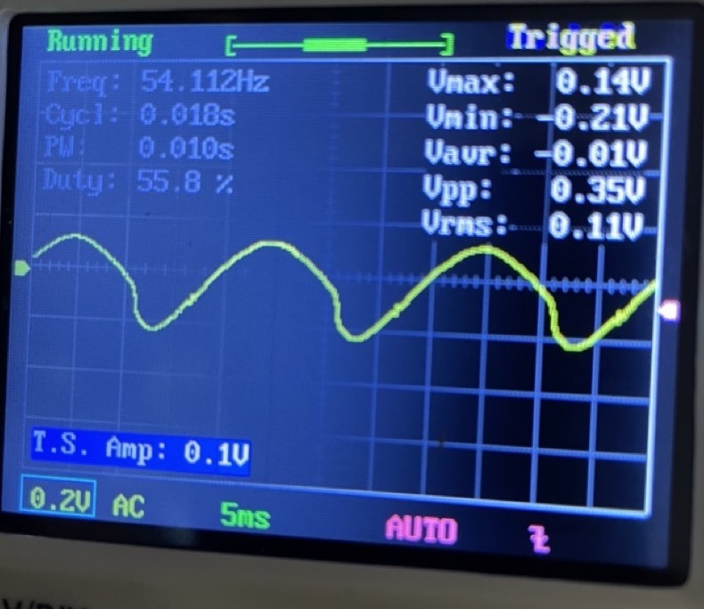

I took some more scope readings, and I noticed that the noise had something of a pattern to it:
and when the treble controls are turned all the way down, it stabilises into this (note the different time scale):
Just a wild guess, but doesn't this look like mains frequency (plus harmonics)? Are all ground connections good? Supply filter caps ok?
Also the voltage difference in the attached image seems much higher than it should be ...

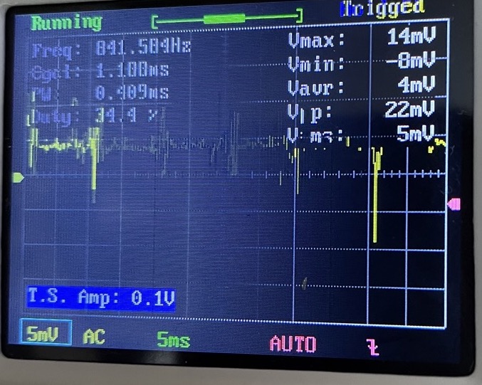

For my own curiosity I measured what's going on around the opamp.
The -21V and +21V pins 4 and 8 are clean enough, with only a few millivolts of fluctuation:
Tone input pin 7 shows the interference pattern:

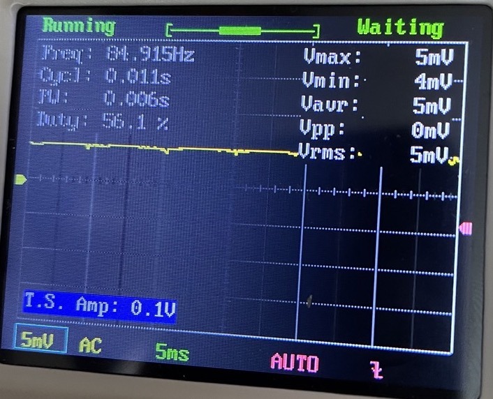

Input 6 is very quiet when there's nothing connected to the output - the 5mV noise only appears when there's an output connected:
Not-sure-what-it-does pin 5 looks similar to +21V pin 8 but has some interference on it (this measurement taken with nothing connected to the output; the noise is more visible with an output connected)
pin 3 is doing much the same as pin 7:
Pin 1 (output) looks a lot like input pin 6 - with no output it's very quiet, but with an output there's around 8mV of noise.

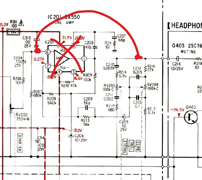

Next step will be to take the opamp out of the equation, I guess - which would also remove the effect of the tone controls. I guess removing C205 with the opamp in place would isolate the tone controls?
The CX550 is in a SIL (single in line package) and although its an opamp, its an early non standard type. It is not beyond the impossible to replace it with something else but lets not go there yet.

The opamps will come out in seconds with solder braid. As quick as typing these two sentences... honest 🙂
We can (I think) bypass the tone section quite easily while retaining the opamp but lets save that for later. Prove the thing is silent with no opamp in circuit first.

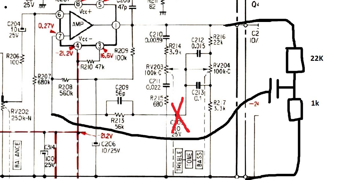

To bypass the tone control... look at the circuit.
R208, R209 and C206 are not in the audio path. R209 and C206 form a filter that removes the audio content and derives an average DC value that is used for DC feedback to set the operating points.
You could simply add a new feedback network (two resistors) to bypass all the controls. A 22k and 1k in series from the opamp output to ground would give a gain of around 23 calculated as (22000/1000) +1. That would be a much lower impedance low noise network. The junction of the resistors is then AC coupled to pin 7 with a small cap. Lifting C205 then isolates the tone section.

You could remove and replace those a dozen times with no damage. A couple of seconds per pin to desolder and a second to resolder. They will be absolutely fine.
I removed the opamp on one channel and that removed the hiss. There was some hiss at high volume but nothing at zero. There's some ground hum around the volume half-way mark, but right now the amp is open on the bench and the length of the temporary wire joining pin 6 to pin 1 could easily pick up hum from the transformer.
