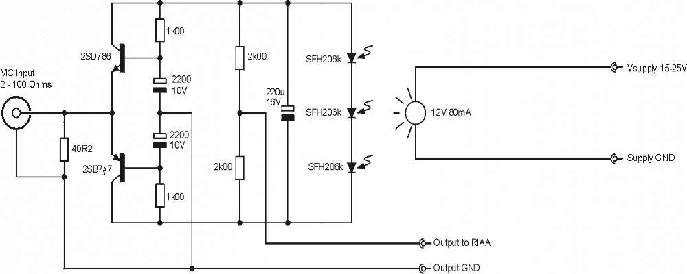

This is the CCT of the pre preamp I am thinking of building, could anyone inform me what would be reasonable components to use, not values but type.
I know different types of caps etc. in certain paths alter the sound, but don't know which to use where.
The components are:

Maybe this can serve as inspiration. This has optic psu🙂

The 2200uf can be replaced with 1000uf 6,3v + 220uf or more OS-CONS for less resistance at higher frequenzies. The 40r2 resistor should have the value recommended for load of your cartridge.
This setup works great by the way, i have used it for many years🙂
My main Q is what type of caps and resistors to use in what location i.e polyprop caps and metal oxide resistors, I want to build a good 'bang for buck' pre as I am short on funds.
Also a second thought is would point to point be better than veroboard.
I built a similar circuit years ago, with BD167/BD168 power transistors. They were recommended for lowest noise. Also the capacitors between each base and GND totally destroyed the sound. On removing them the circuit began to sing... This is a good example for theory and sound quality being on different tracks...

I am testing now alternatives on a curve traces and a noise test.
What could work are Zetex. Many of the medium power SMDs are known to have low Rbb.
I am currently awaiting FMMT618, 718.
From the specs they look good.
