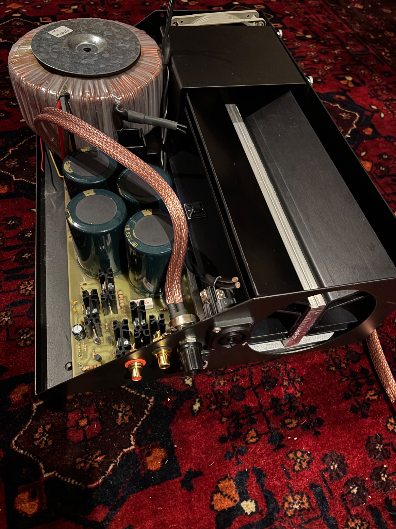

There is always something better to try, but before testing, perhaps I was getting ahead of myself. Looking for a satisfying reason to cheap out on the transformer. That 35mm gaps not a lot to play with. That 100VA isn't going in there, and the 30VA is 32mm + hardware. I'm not sure I would want to cram that in. I would have to give airflow some thought. Plus that 35mm is defined by the caps, and the removable case it seems. So there is no fixing point yet
Thinking of using the side of the alloy panel to mount the pre and wire so the connections can allow the lid to come off with the preamp on. I wonder if two transformers close would be okay

Back on this topic, I would be surprised if the transformers didn't interact. Even crossover inductors are turned through 90 to not effect eachother.
A quick read and I think with an additional sheild if I can fit it should be okay, as the pre transformer will be 10+mm away and oriented differently

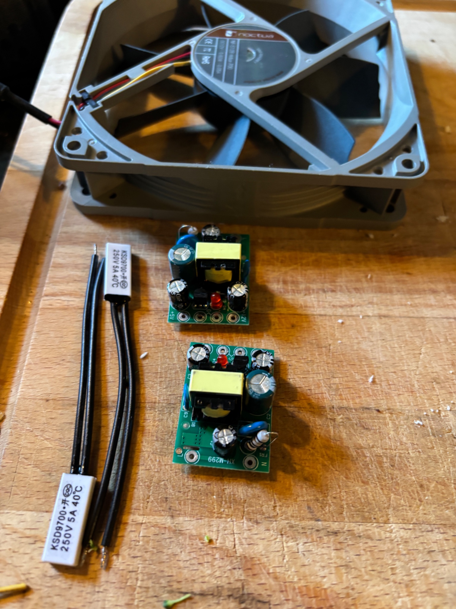

I’ll have a little bit of a mock up to see I gave a 12v fan that showed a good reduction in temp so will fit with a thermostat- I’ve already decided to build a small unregulated linear as the switch mode has given me the jitters about RFI
I use Arctic fans, and I think one has it's own thermal control now. Let me see..
https://www.arctic.de/en/P12-TC/ACFAN00176A
38C target, through fan speed regulation. You can set it's voltage lower, to limit full speed. Should be quiet, considering it's

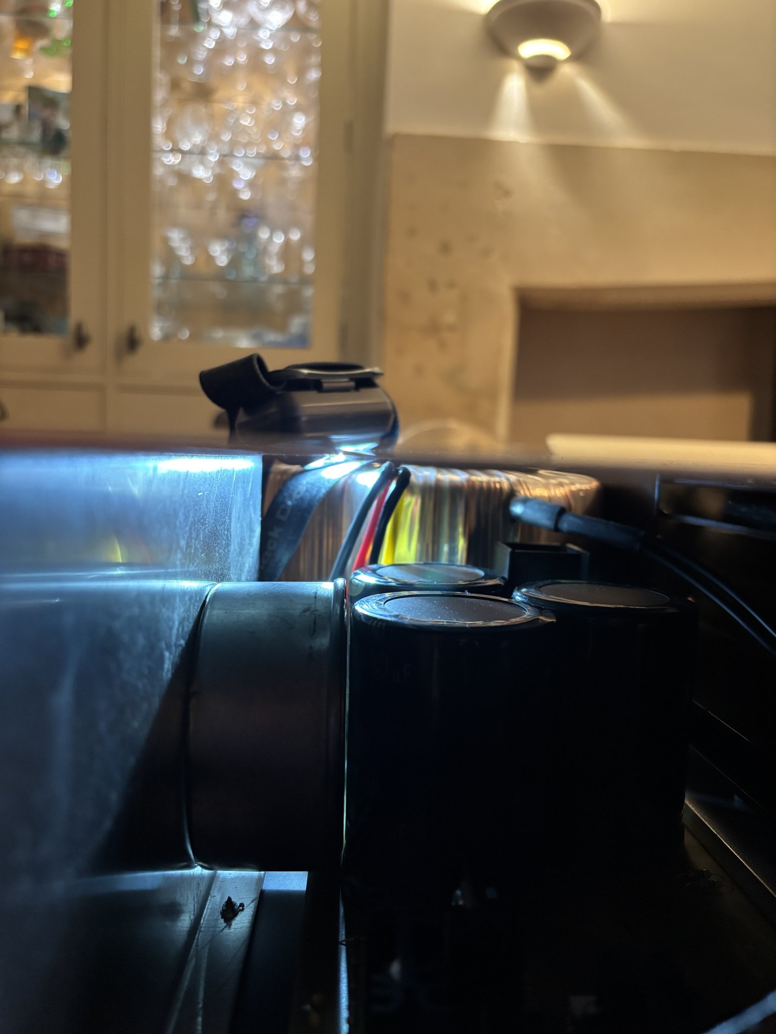

I found a pot of flux that measures 34.5 mm diameter its 75mm x 34.5mm most of the potential 50-60 VA options seems to be 34mm or some more, so very tight !
But at 34mm I could fit and copper foil wrap the side of the caps as well, the leads could come out at the top as the internal height is 100mm +
Easy !
Easy !

The foil idea might create a shorting ring, if it comes loose.
You might need to go to the manufacturers site.
