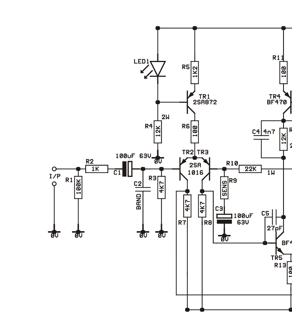

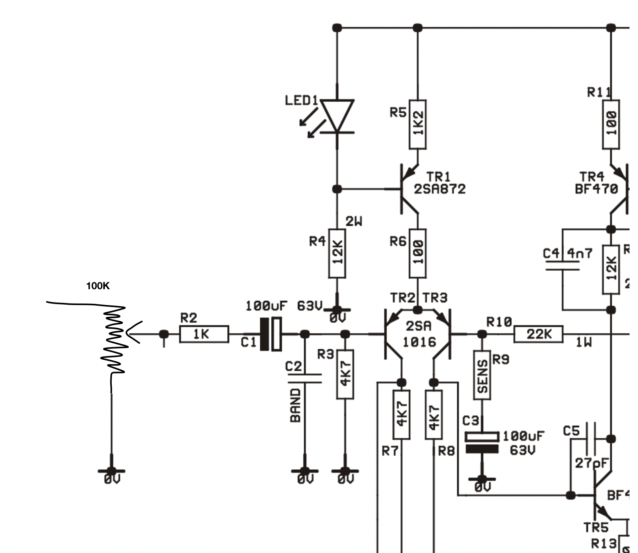

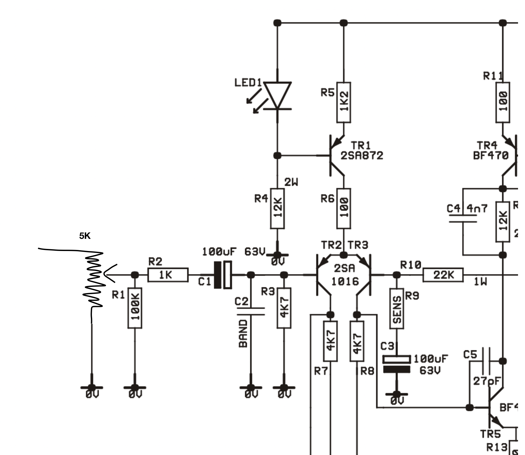

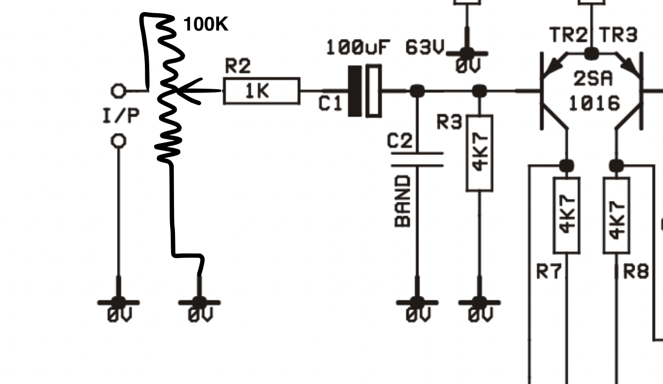

Pre-amplifier modules to add gain level adjustment to 1,000W MosFet amp to drive 18" subwoofers
Yes true I can adjust the level in the DSP but I don't like dropping late amounts digitally, so just want to trim digitally only by a few db if possible
I'm not sure I understand this. The damage is done by the minidsp being there. The level of volume adjustment in the digital domain, shouldn't make any further difference. Adding analogue boards will further reduce the dynamics you are interested in. I don't understand the project brief. It seems like a project to make things worse?
@friendly1uk, hi
The system uses multiple subwoofers controlled by a mini DSP 10x10 unit for EQ and timing (subs only), the 10x10 is unfortunately analogue in which is then internally converted to digital and back again (Reasonable quality A>D and D>A DACs, with an upgraded unit with better power supplies etc). The output impedance to the 10x10 is 560 Ohms. I'd love to do all DSP digitally before converting to analogue, but this is not an option outside of £10k plus of investment and a total reconfiguration and there are only a few devices that can do this unless you buy a poor sounding AV processor and I had an Acurus ACT4 and it was easily 'beaten' sonically by analogue out from a good BR player into an old naim AV2 (go figure....)
All the subs currently are 'driven' by BK Electronics BPSB500 plate amplifiers and they are sonically very good indeed as I have experimented with alternatives and even replaced the amplifiers in my Sonus Faber Crimona subs with these units. They are Mosfet with strong power supplies and high damping factor amps. All these units have pre amps included as well as power amps (they have gain and phase etc) I do not use phase or other controls other than gain. This allows me to get the amps in the ball park, I simply trim then digitally.
Why not just cut significant db digitally ?
Interestingly during the evolution of my system, adding and aligning more subs I did at one point have quite a large amount of db cut to some subs in the 10x10 HD, I then read about the SNR reduction when digitally cutting volume, so I bothered to adjust and reset all volumes (matching curves identically in REW as the gain is analogue on the 500's) reducing analogue gain. It was better enough for me to A-B in case something else had changed, it was better with trim only in the DSP
So I want to A-B the 1000W units and see if they are as good as the 500's and not realise that they could be better configured with a small pre-amp/buffer etc. I could of course just adjust the gain in the DSP and I am sure it would work fine, but I want to get the units to work and sound as good as they can. So I will try the passive pot and probably leave alone if they sound as good or better with just a pot, but I'm bound to have an itch to try a small preamplifier in the loop at some stage incase I miss some performance for the sake of a small investment and experiment. Also I can try the pot wide open and trim digitally to check too, again.
