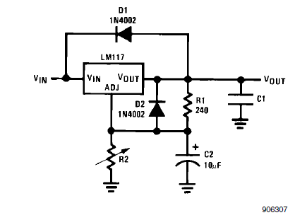

There is no capacitor at adj pin, it is a normal recommended circuit.

I have ever done putting 0.47uF file cap in adj pin, so the output is not so stable for lm337.

5-10uf on adj pin should dramatically reduce ripple (on a 317) I've not used a 337. 0.47 is probably too low and may be why you got instability?
below is from the national datasheet
http://www.national.com/ds/LM/LM117.pdf
edit: I believe the scope software is per division, I've used the same software before 😉 Try measuring a known ac voltage with your multimeter and compare the result on the scope to work out calibration 🙂

If you really want extra regulation - i am assuming you wish to minimise noise here - look at the Jung super regulator. Or you could try a capacitive multiplier before a single LM317/337. Definitely bypass the LM317/337's Adjust pin as shown in the datasheet - the improvement in noise is significant.
