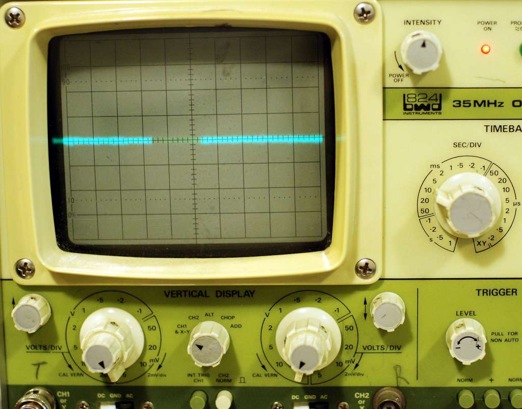

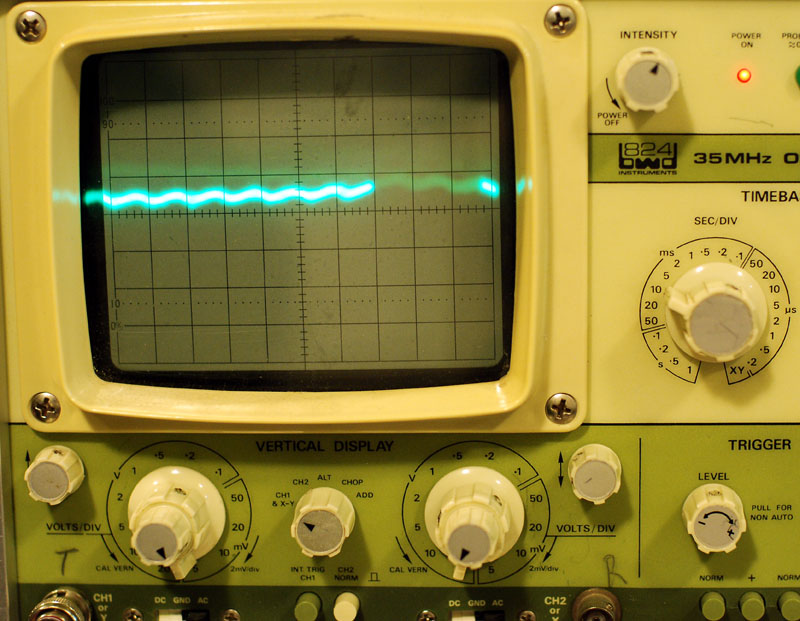

Hi Smithomo, if I'm not mistaken, that is showing almost 12mv P2P ripple on the output of your regs? That seems awfully high to me. How much current is your preamp drawing?
first pic is the output of my LM317 reg circuit (on breadboard and was picking up rf in the Mhz range hence the general noise) scope was set to 2mV/ division. Load was 125mA (purely resistive).
The second pic is the input to the reg, the scope was also set at 2mV / div there is a CRCRC before the reg.
Can you post the circuit diagram for your reg circuit? do you have an adj pin bypass cap?
