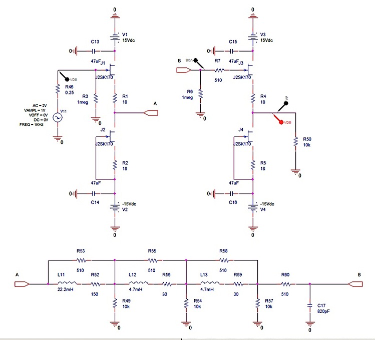

I think that the filtering should be start earlyer in F domain. But with softer slope to keep the phase in minimum drift at the top...
here is one simple circuit. can be made from ferrite beads 22.2mH=2 x 10mH + 2.2mH
10mH usually have DC res of 50ohm cca so total DC res have to be substracted from R followed also for other R in the chain.
this filter have -1.25db @ 20KHz -14deg Phase.

It is Very hard to acheive that kind of propper filtering WITHOUT disturbing phase in audio
domain. And Should be 2 filters one for 44.1KHz base other for 48KHz base...
Some passive examples You can find from Zanden papers. And that could be acheived with FDNR filters with L emulated from OP amps...
All that sections should be inside of -6db or so (take a look at the graph)

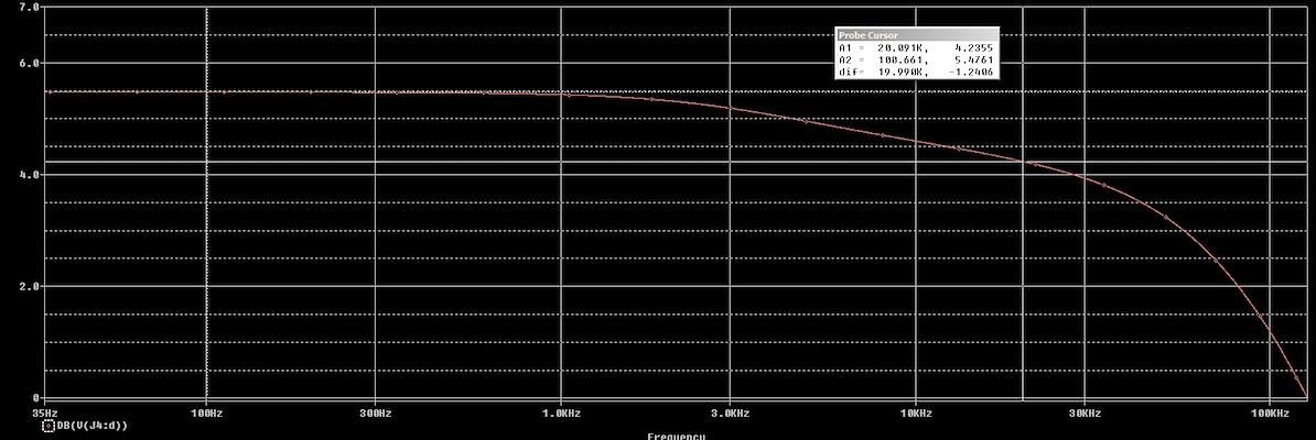

Simulation of the schematic posted at the beginning of this thread for the PCM1794 shows an attenuation of the output by 20% (500mV->400mV) and a phase shift of -55 degrees at 20 KHz.
