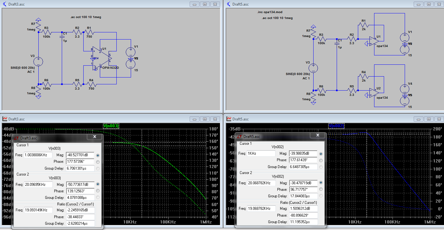

Do we agree that the cap after the DAC must be adapted for each DAC model to get a consistent roll-of?
Yes.
But "current" DACs are totally predictable, has been so far when working into Virtual Ground I/V. Then 2 x 3R3 and 1uF are pretty golden.
I agree that the virtual ground makes the variations in between DAC near irrelevant. However, 2x3R3 and 1uF are golden only with some opamps and particular values of I/V resistors. Otherwise the FR curve can vary all over the place.
You wanted differential, here are the results:

The answer to your question is Yes and I would have done so already if I owned a digital device with a DAC with differential outputs (excluding a CD Cats SA3).
I did some simulations during the last two threads and hours of downloaded service manuals and datasheets on the DACs I own.
