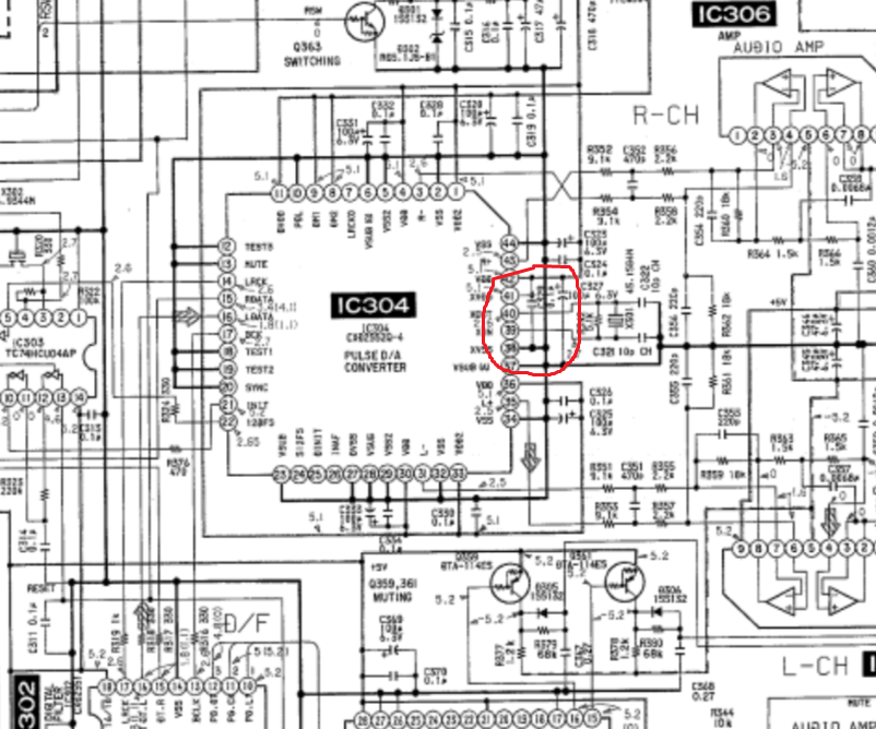

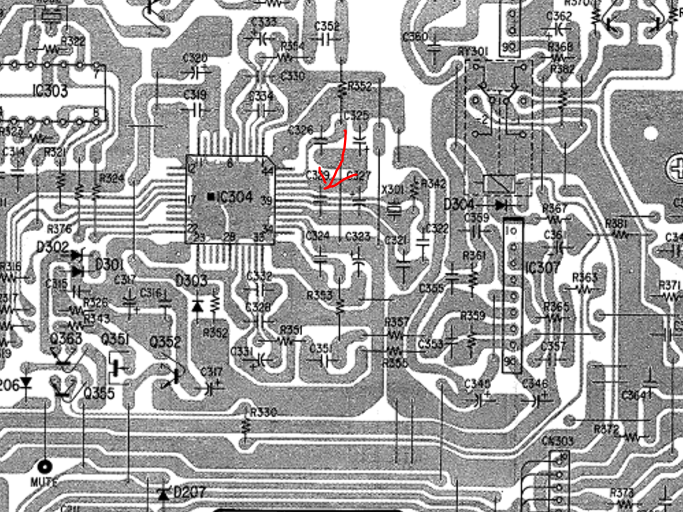

On the supercap mod, how long are the leads used, are they the same in every mod i.e. been specified as part of the mod for consistency. The ESL and ESR as pointed out earlier is going to mean these devices are not operating at a very high frequency and in fact will be more reservoir caps than decouplers.
Lol 😀
Leads were short (just the component itself) and fitted under the PCB and directly across what seems the main supply to the DAC.
